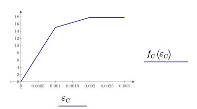

The problem is the function f.C1 because you used square brackets. Using square brackets creates a matrix which is not what you want.
So use normal parentheses and the sheet works.
But your range variable epsilon.C consists of only four numbers (0, 0.001, 0.002 and 0.003) and so your plot is just connecting four points.

But how do i plot the function with a smoother curve?

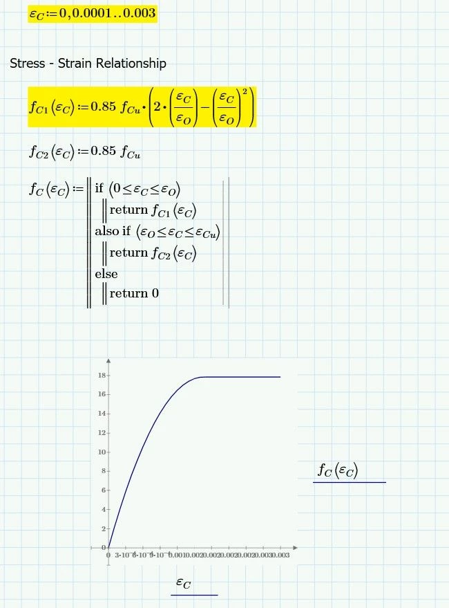

terryhendicott
Hi
Change the square brackets, and plot using a mid range of 0.0001 not 0.001Capture.JPG
