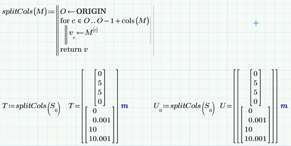

In the attached (MCP3) I am trying to define a matrix based on an existing one.
I have a series of matrixes with different index values. When I split each column to a single matrix this works but when I try to do the same for an element of a wider matrix it seems to not work. Is there a way of doing this with a snazzy programme or similar?

Its not clear to me what you are trying to do.
The way you have defined S is that S is a 1x1 matrix containing a 4x2 matrix. Was this done on purpose and why?
In which way should the program you demand "split" a matrix (or a nested matrix)?
What exactly would be the input, and what should be the output?

Sorry, perhaps the attached makes more sense.

Are you trying to create a nested matrix?
Something like this?
If MJGs guess is correct, this could be the program you are asking for:
