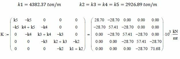

Please help me with the difficulties I am having trying to repeat a very important example step by step.
I tried to do as much as possible myself.
Nevertheless, a number of questions turned out to be impossible for me to handle.
Since, apart from the context and previous calculations, the essence of the questions will not be clear, I am attaching the original MathCAD file, the PDF example file, as well as a .xls file for the calculations.
All questions are highlighted in red in the MathCAD file with references to the example’s pages.
I will be extremely grateful to everyone for any comments/advice/hints.

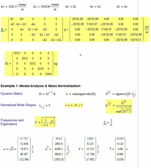

terryhendicott
I am stopping for the day as it is very late in my part of the world.
I have found a unit inconsistency at the top of the file and am working my way through the sheet because of the unit problem.
This will take time.  I have enclosed the file so far.

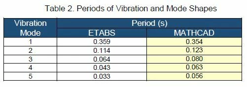

You need to multiply k1 and k2 by gravity to get force/length spring units. and mass matrix should be by kg.
This gives the period and frequency values in the reference.
It also show why in your original sheet you are using a factor of 100 that is not necessary if you use consistent units.

I know about units and just forgot to change them before posting.
I will be grateful for any other advice and insight from you.
P.S. The reference is just great. I put a lot of time just trying to realize all of its concepts properly.
I fixed the units.
