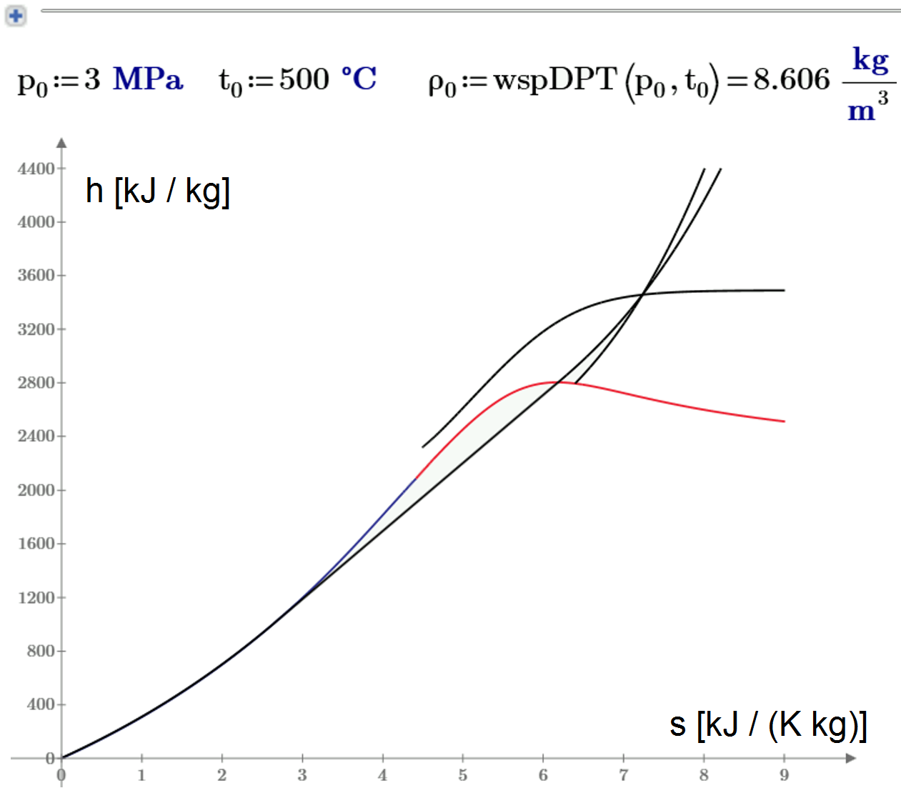

This study describes how you can build contour lines (isobars, isotherms and isochores) and lines of phase transitions on the state diagrams of water and steam.
Fig. 10.1 Water steam isobar, isotherm and isochor on hs-diagram

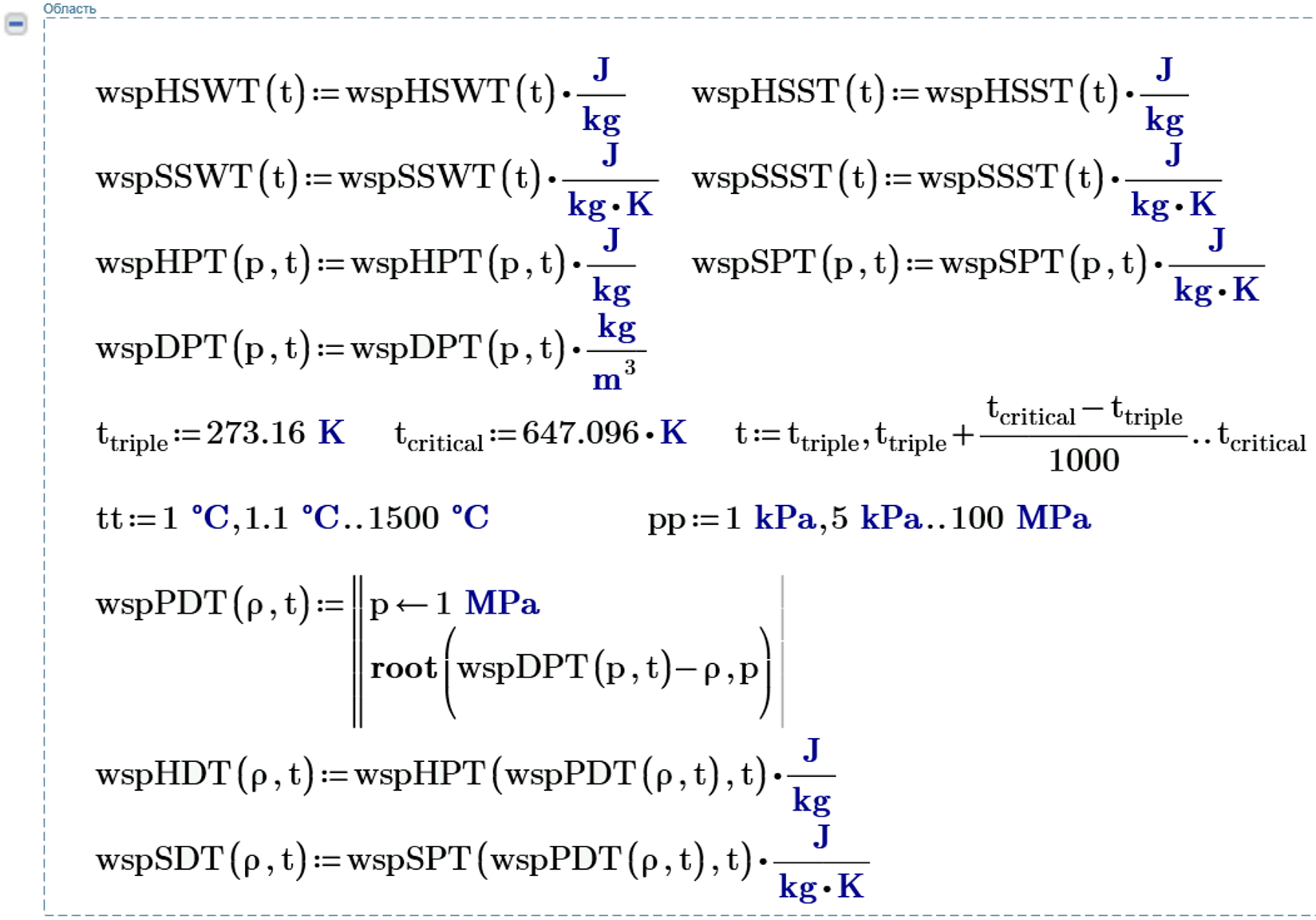

Fig. 10.2 Auxiliary operators in the problem of building the water steam isobar, isotherm and isochor
