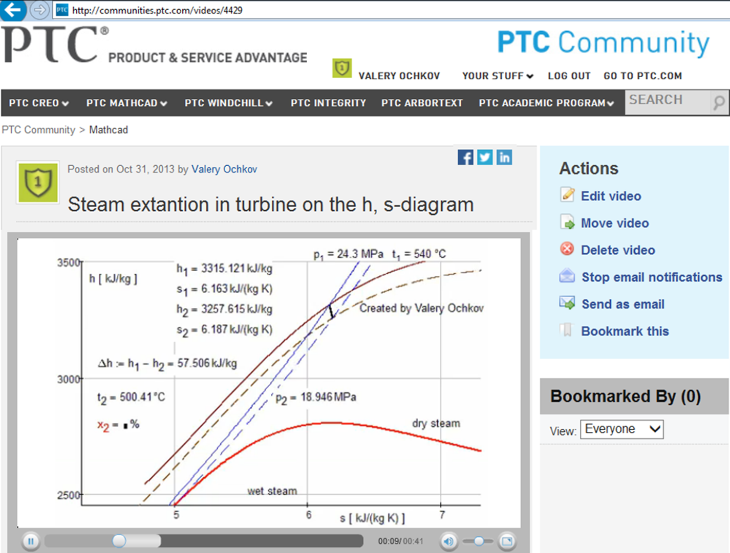

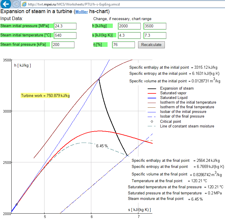

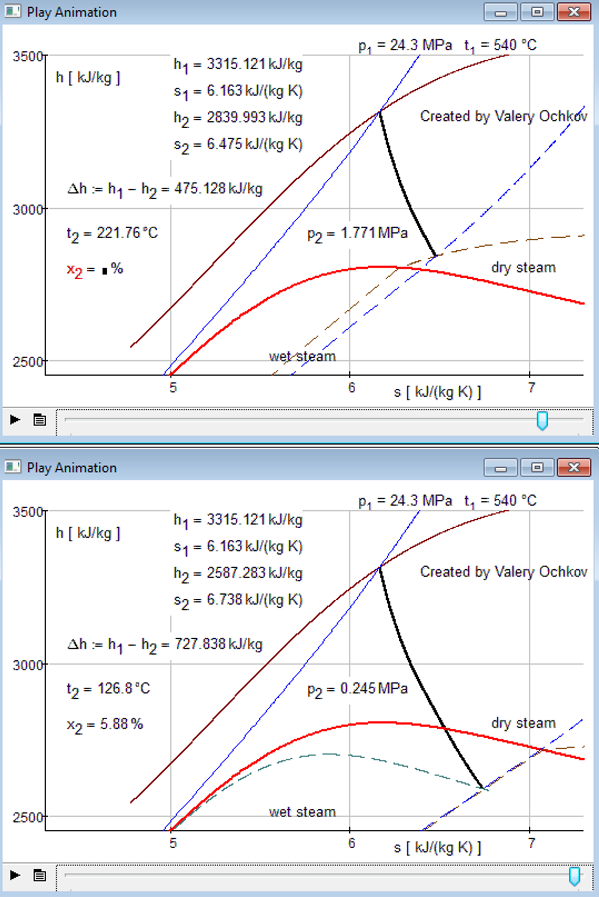

Fig. 12.1. Interactive open network calculation process of steam expansion in the turbine (http://twt.mpei.ac.ru/MCS/worksheets/PTU/h-s-ExpEng.xmcd)

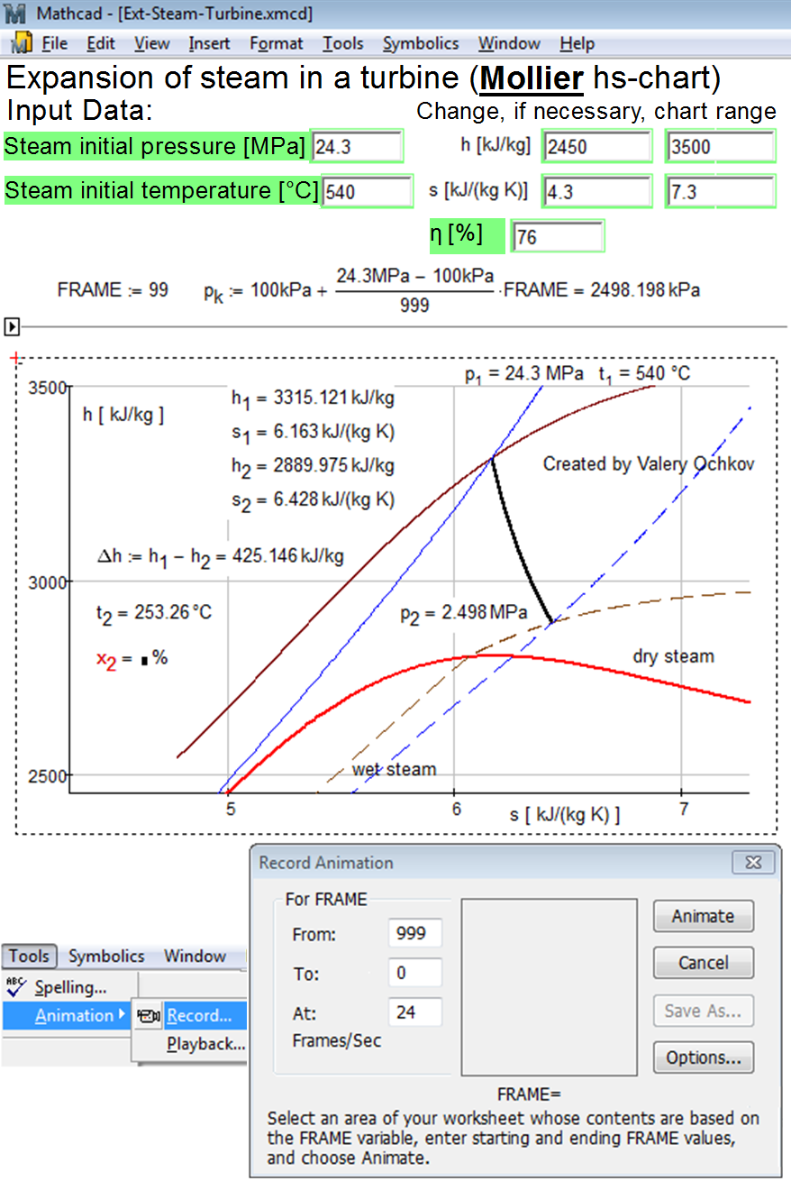

Fig. 12.2. Creating of animation in Mathcad 15
Fig. 12.3. Mathcad animation frames
Fig. 12.4. Turbine steam expansion animation at PTC Community website ( Video Link : 4429)

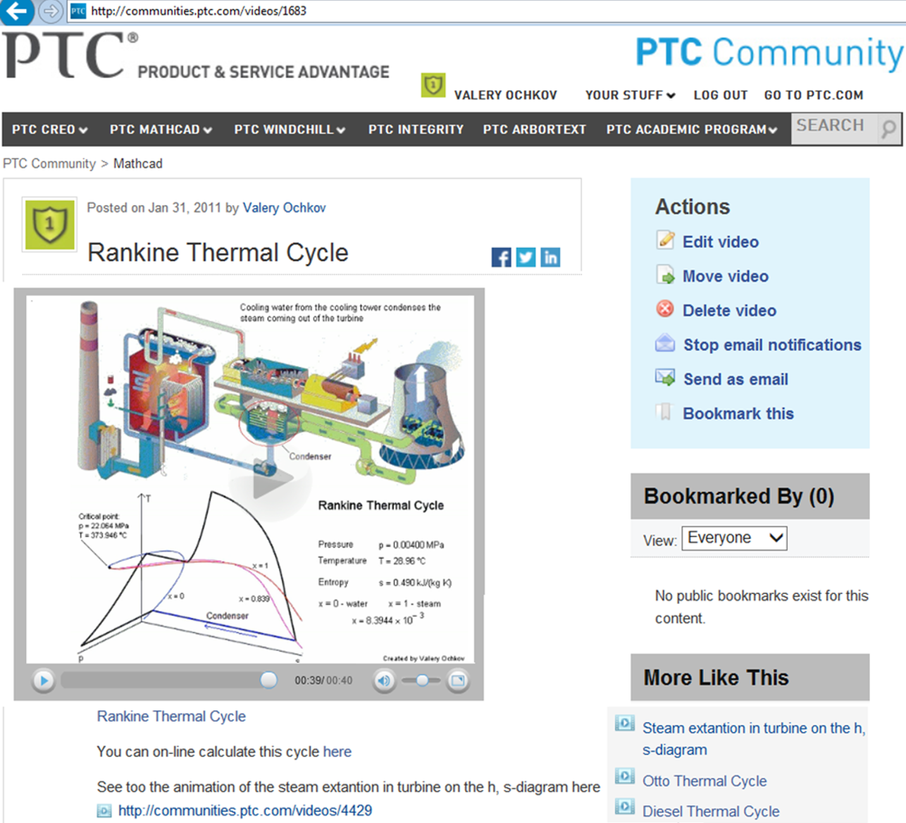

Fig. 12.5. Steam turbine cycle work animation ( Video Link : 1683)

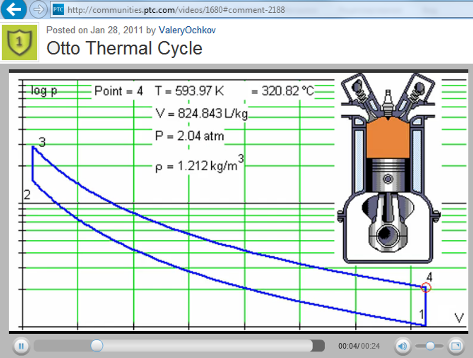

Fig. 12.6. Otto cycle work animation ( Video Link : 1680)

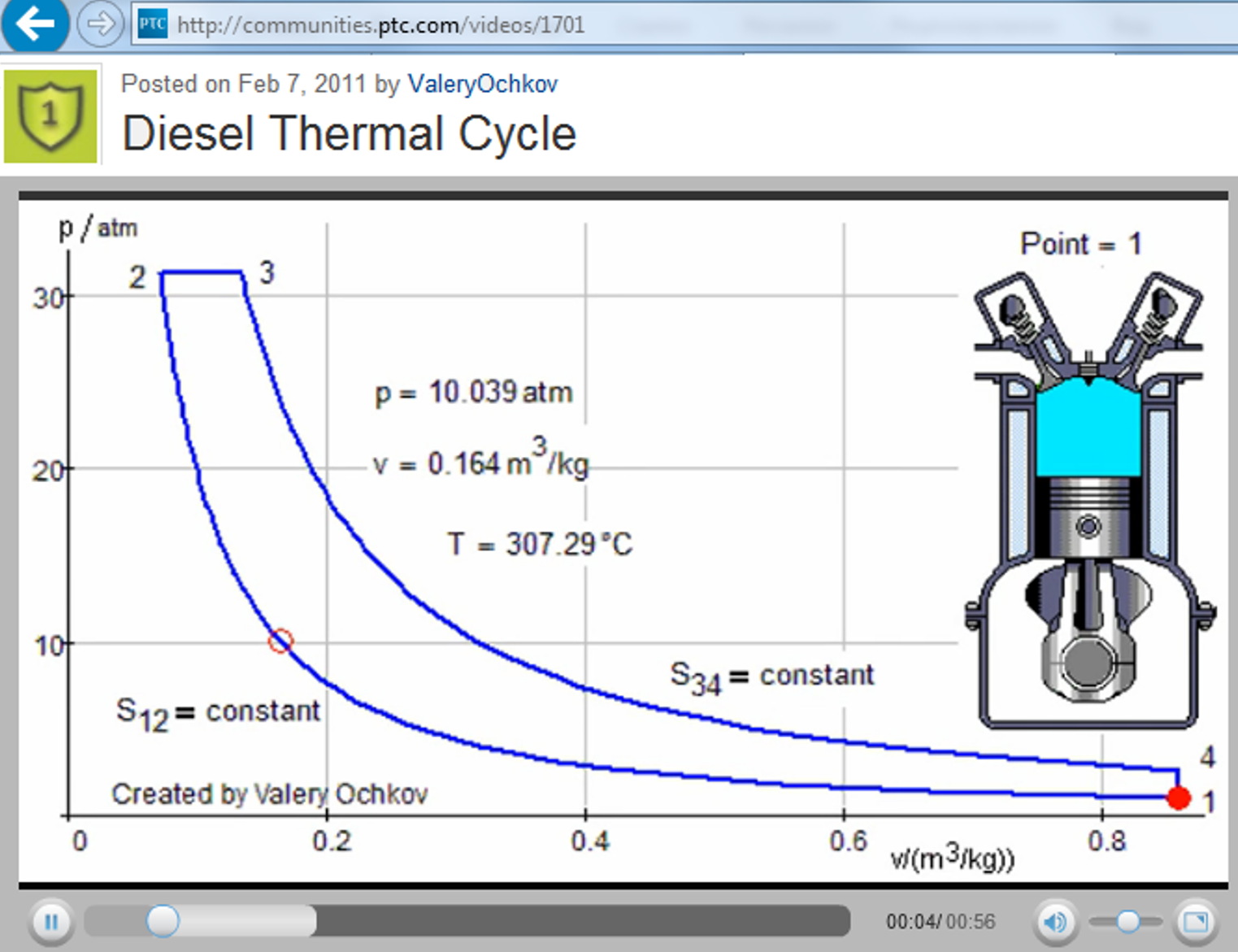

Fig. 12.7. Diesel cycle work animation ( Video Link : 1701)

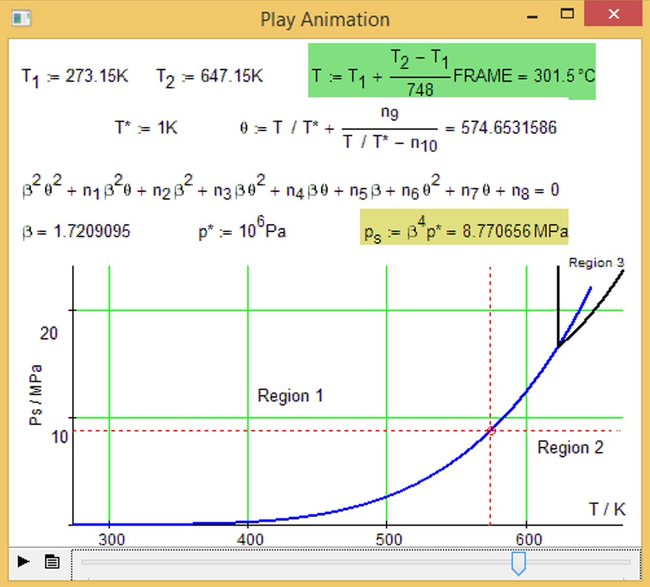

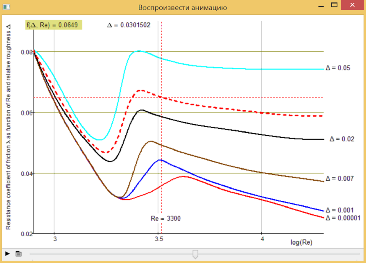

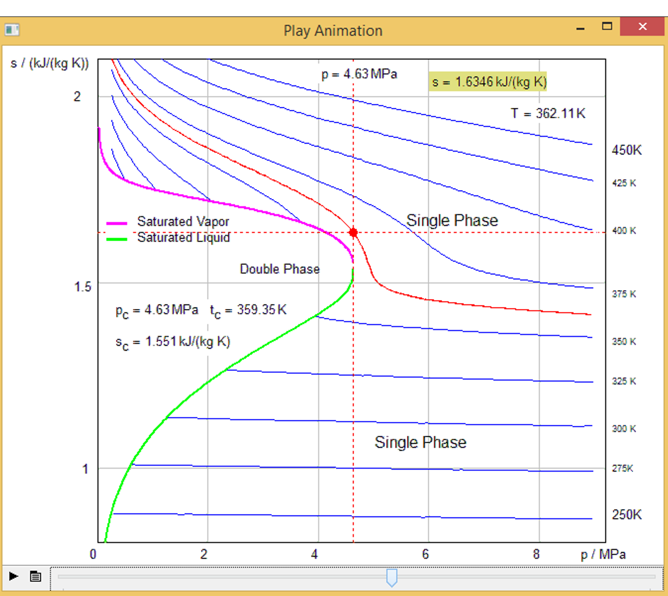

  Fig. 12.9. Scanning with animation of a function created using the properties of substances

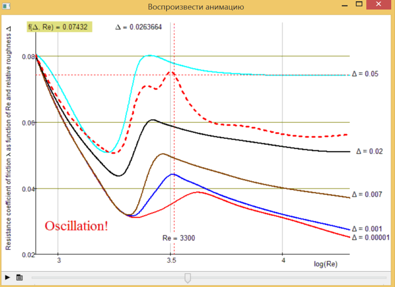

Fig. 12.10 Scanning of the created function: spline oscillation
  Fig. 12.11 Scanning of the created function: everything is OK (see this online calculation - http://twt.mpei.ac.ru/MCS/Worksheets/Hydro/La-De-Re.xmcd)

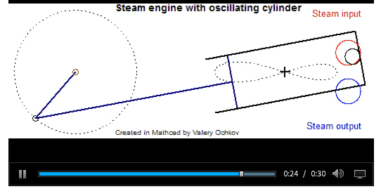

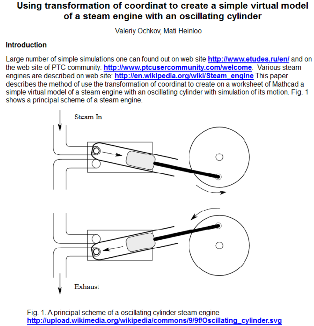

Fig. 12.12 Frame of the animation of the steam engine with oscillating cylinder Steam engine with oscillating cylinder (паровая машина с качающимся цилиндром)
One more version of an oscillating cylinder of a steam engine - see the picture and Mathcad 15 sheet in attach:
