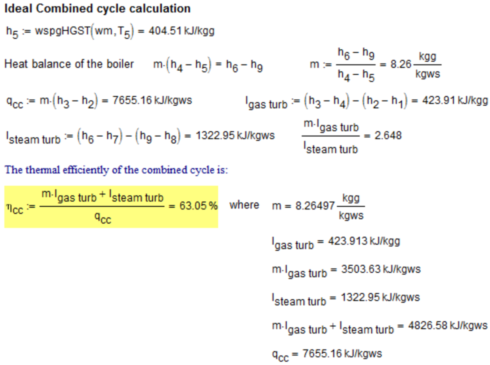

Fig. 14.3. Calculation of thermal efficiency for the simplest ideal combined cycle

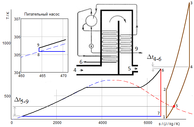

Fig. 14.3a. T-s chart of the simplest ideal combined cycle

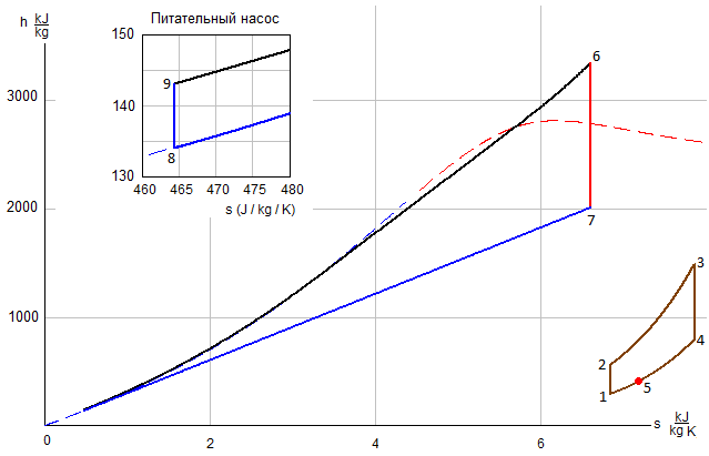

Fig. 14.3b. h-s chart of the simplest ideal combined cycle

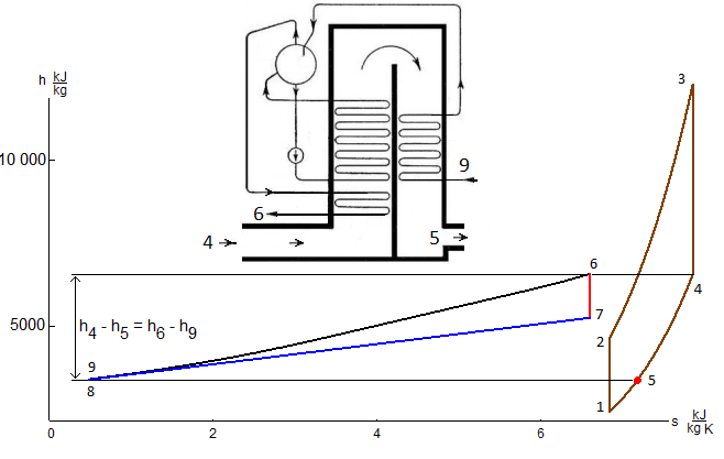

Fig. 14.3c. Corrected h-s chart of the simplest ideal combined cycle

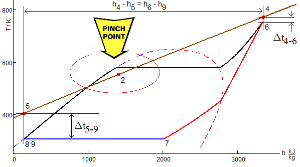

Fig. 14.3d. Corrected T-h chart of the simplest ideal combined cycle

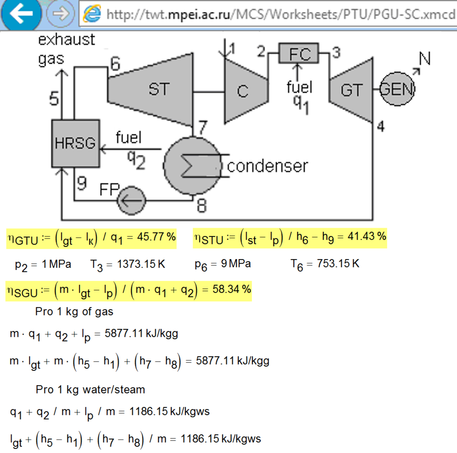

Fig. 14.4. CCPP with compressor driven by steam turbine - Расчет КПД парогазовой установки с приводом компрессора от паровой турбины

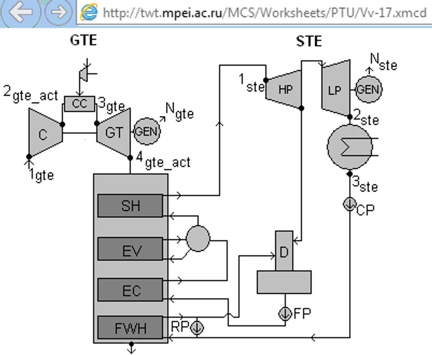

Fig. 14.5. CCPP with single pressure heat recovery steam generator - http://twt.mpei.ac.ru/MCS/Worksheets/PTU/Vv-17.xmcd

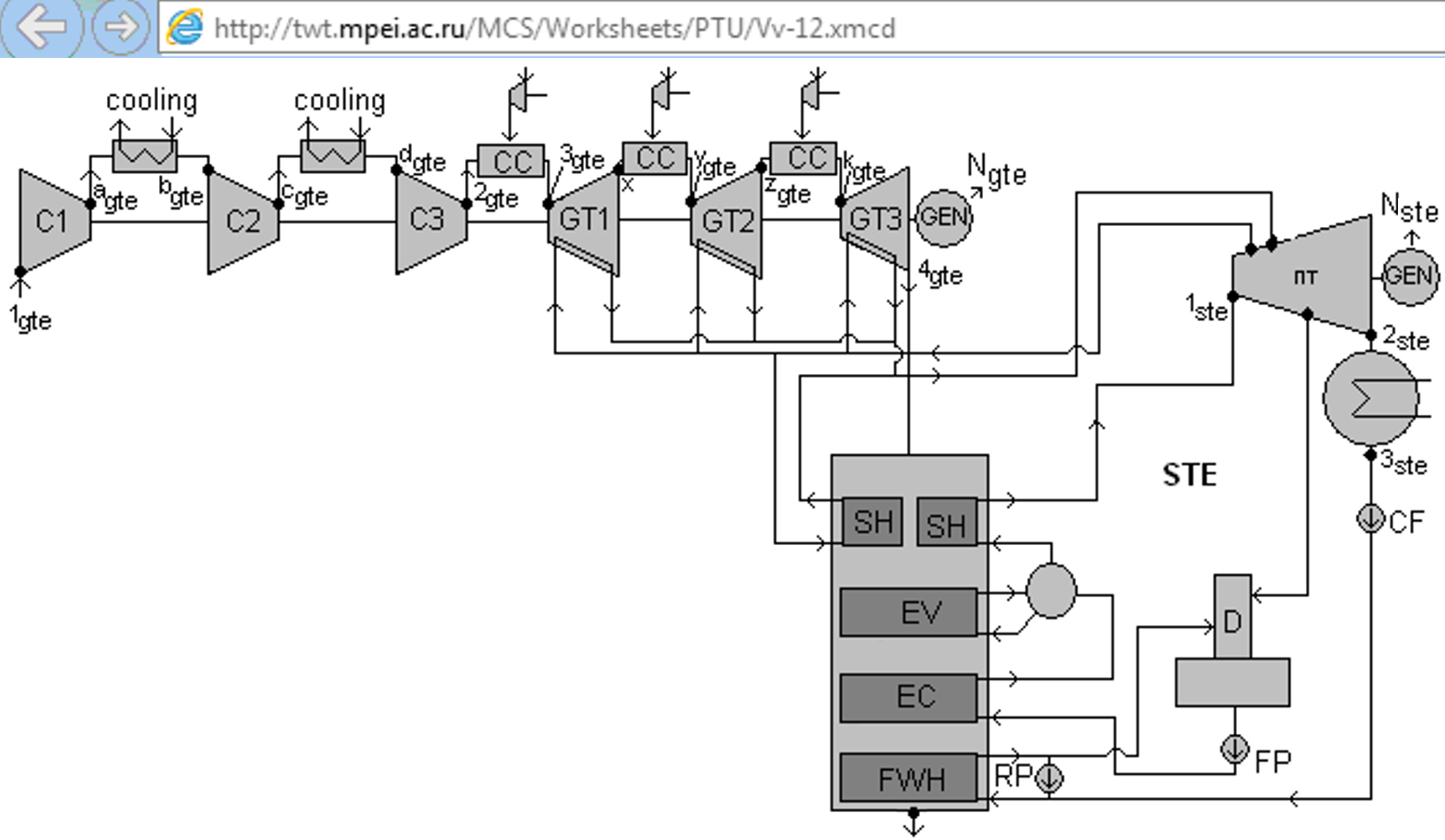

Fig. 14.6. CCPP with single pressure reheat heat recovery steam generator and multistage air compression - http://twt.mpei.ac.ru/MCS/Worksheets/PTU/Vv-12.xmcd

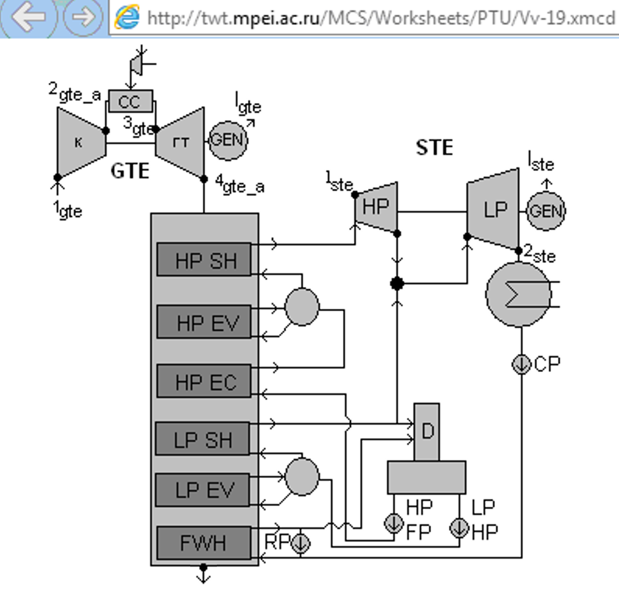

Fig. 14.7. CCPP with double pressure heat recovery steam generator - http://twt.mpei.ac.ru/MCS/Worksheets/PTU/Vv-19.xmcd

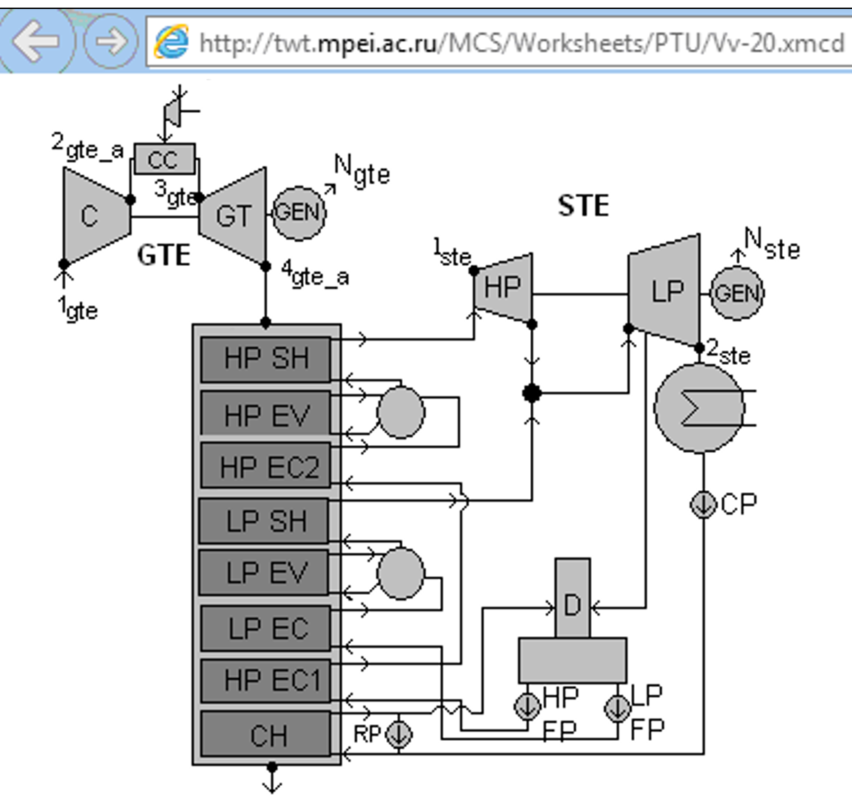

Fig. 14.8. CCPP with double pressure heat recovery steam generator and application of two-stage feed water heating in the economizer - http://twt.mpei.ac.ru/MCS/Worksheets/PTU/Vv-20.xmcd

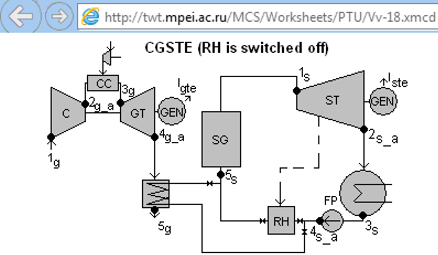

Fig. 14.9. CCPP with semi-dependent diagram (with regeneration displacement) - http://twt.mpei.ac.ru/MCS/Worksheets/PTU/Vv-18.xmcd

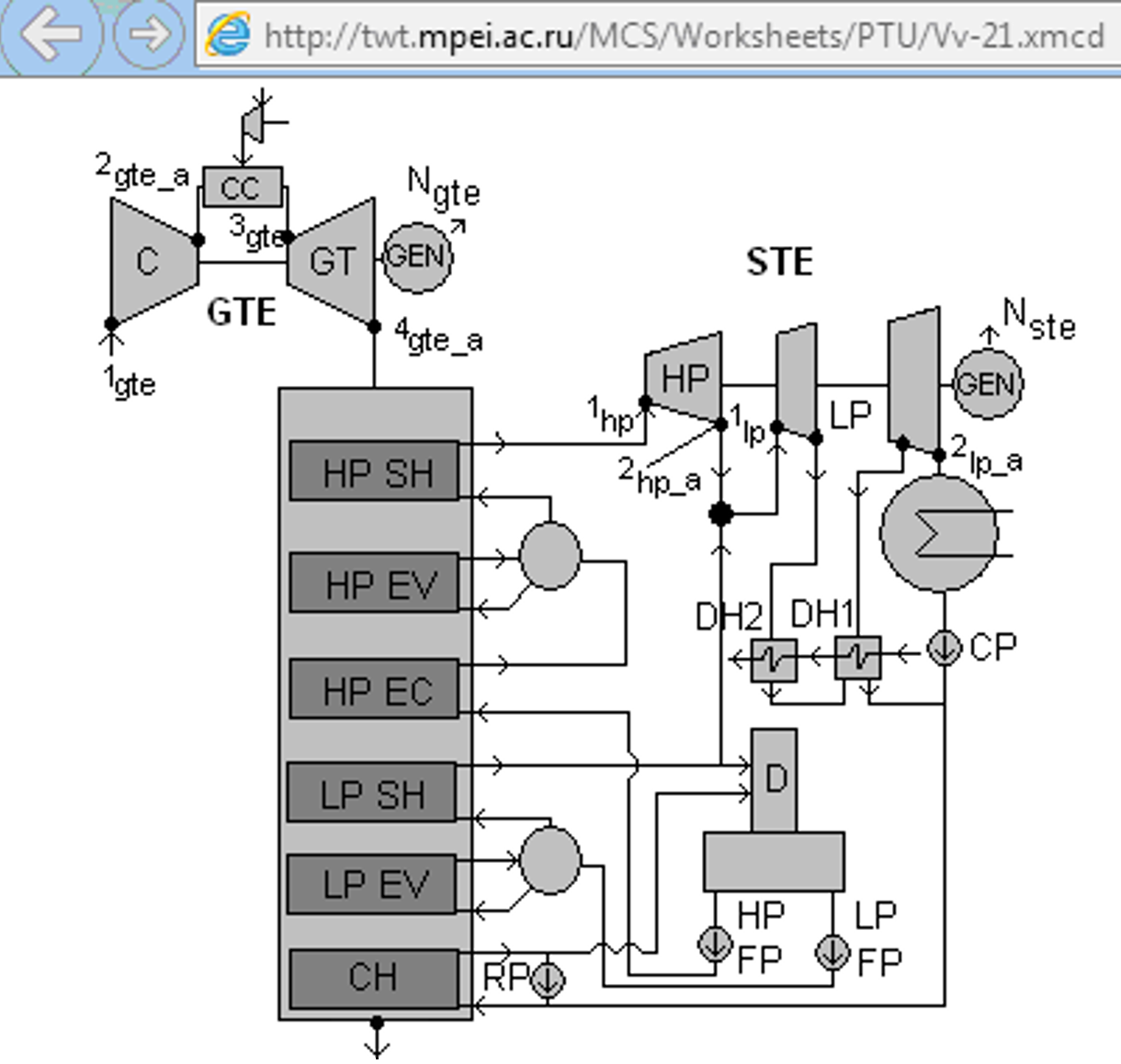

Fig. 14.10. CCPP with extraction steam turbine - http://twt.mpei.ac.ru/MCS/Worksheets/PTU/Vv-21.xmcd

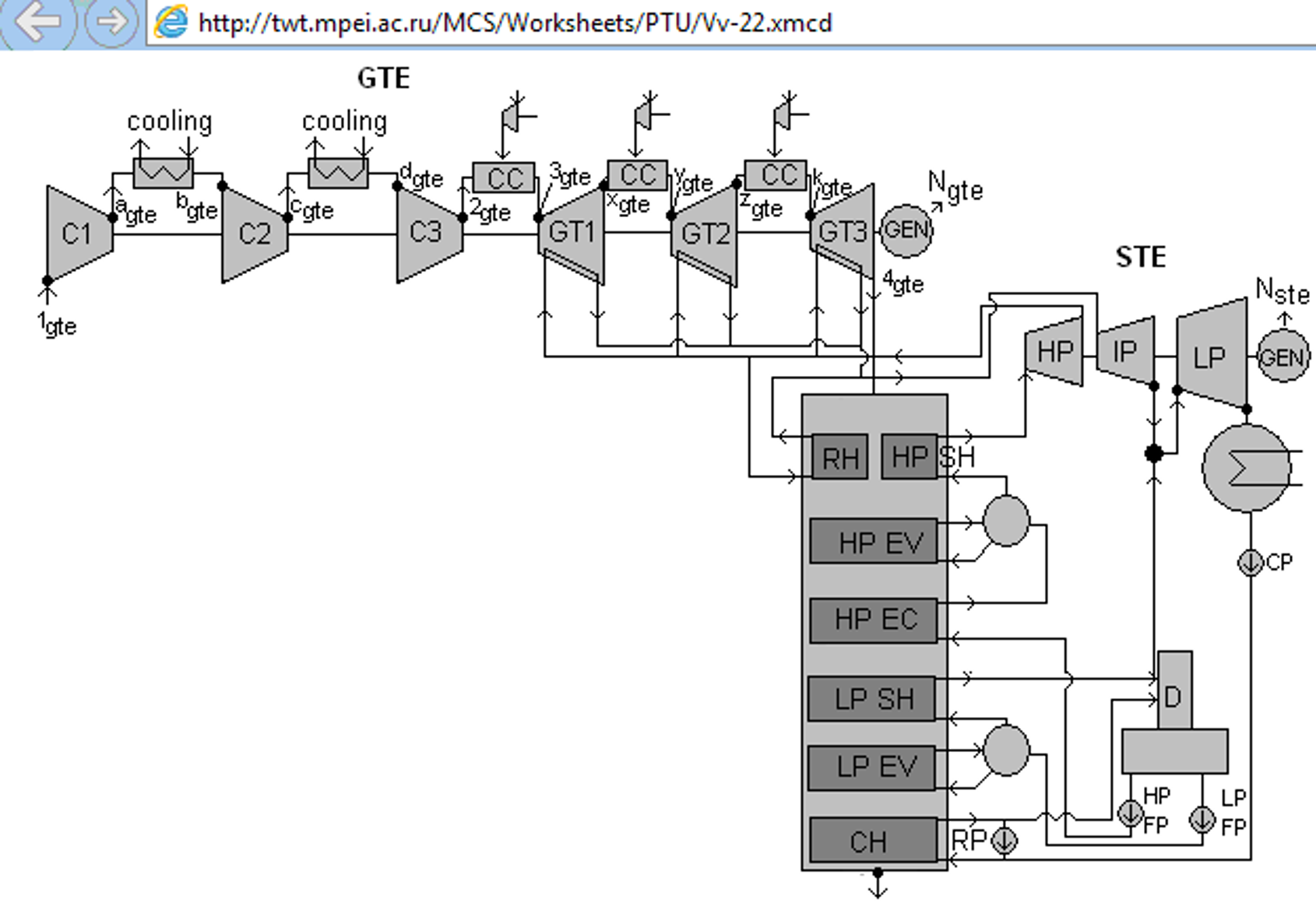

Fig. 14.11. CCPP with multistage air compression and double pressure reheat heat recovery steam generator - http://twt.mpei.ac.ru/MCS/Worksheets/PTU/Vv-22.xmcd

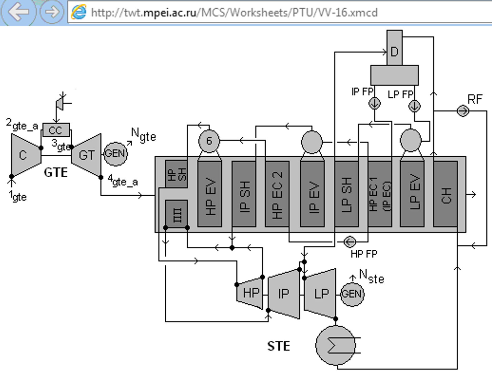

Fig. 14.12. CCPP with triple-pressure reheat heat recovery steam generator - http://twt.mpei.ac.ru/MCS/Worksheets/PTU/Vv-16.xmcd

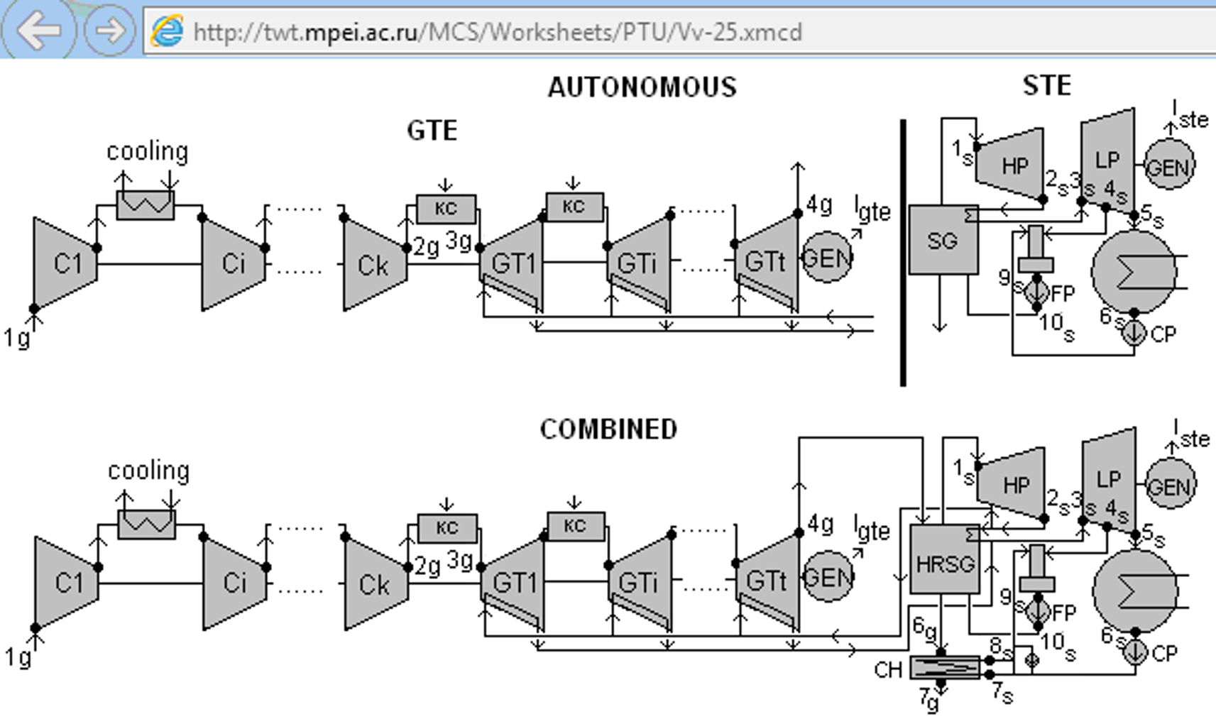

Fig. 14.13. Comparison of gas turbine power plant and steam turbine power plant with CCPP - http://twt.mpei.ac.ru/MCS/Worksheets/PTU/Vv-25.xmcd
