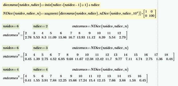

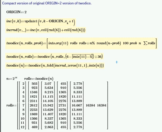

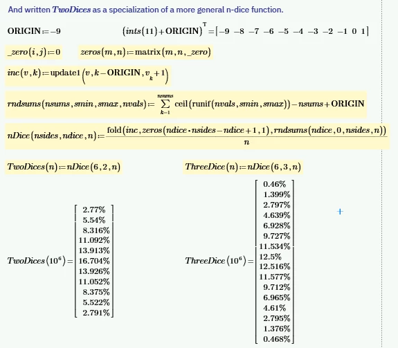

Having followed the chain of messages from the "continue" thread, I thought I'd Expressify the calculation using Werner's recently discovered, undocumented, built-in function update1.
A somewhat meandering Mathcad Express 7 worksheet is attached - I was just putting stuff down as it occurred to me.

Didn't you intend to replace the 10^5 in the definition of" NDice" for the third function argument "n" ?

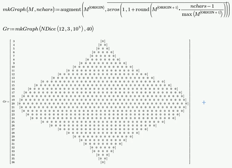

BTW, here's a first attempt for a graph showing the rolling of three dodecahedrons.
I had a "great" time formatting the display because of Primes idiotic implementation for resizing matrices 😞
