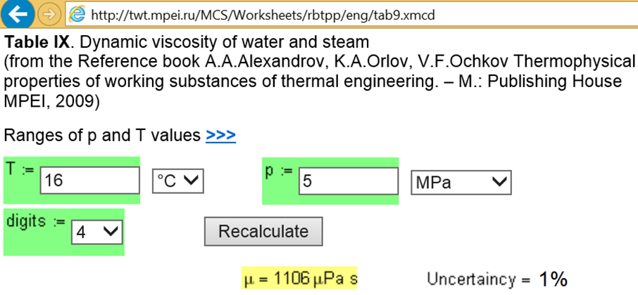

Fig. 16.2. Web page with the on-line calculation of dynamic viscosity of water - http://twt.mpei.ru/MCS/Worksheets/rbtpp/eng/tab9.xmcd

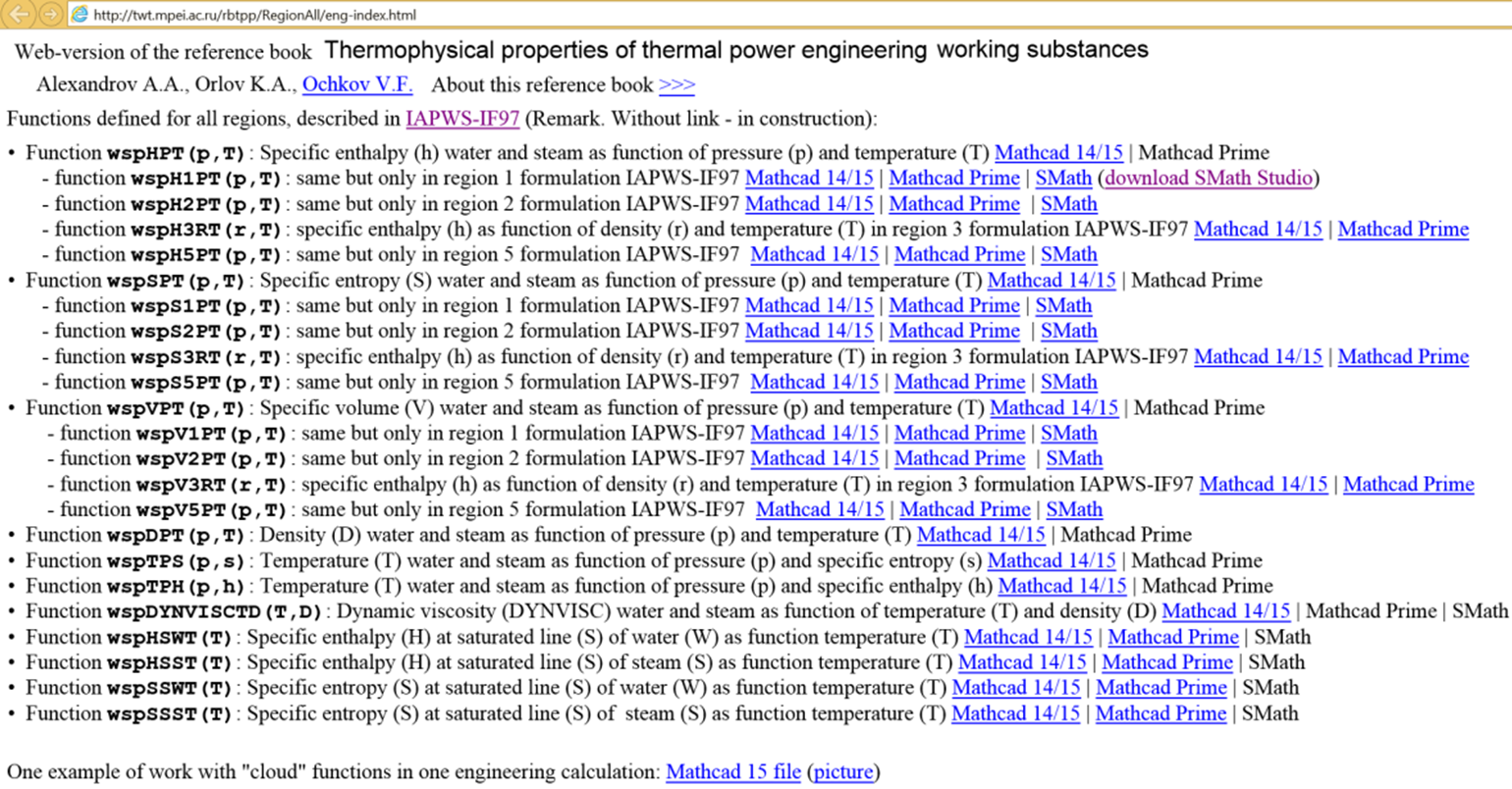

Fig. 16.3. List of “cloud” functions of properties of water and steam - Formulation of region 1 (the basic equation for water)

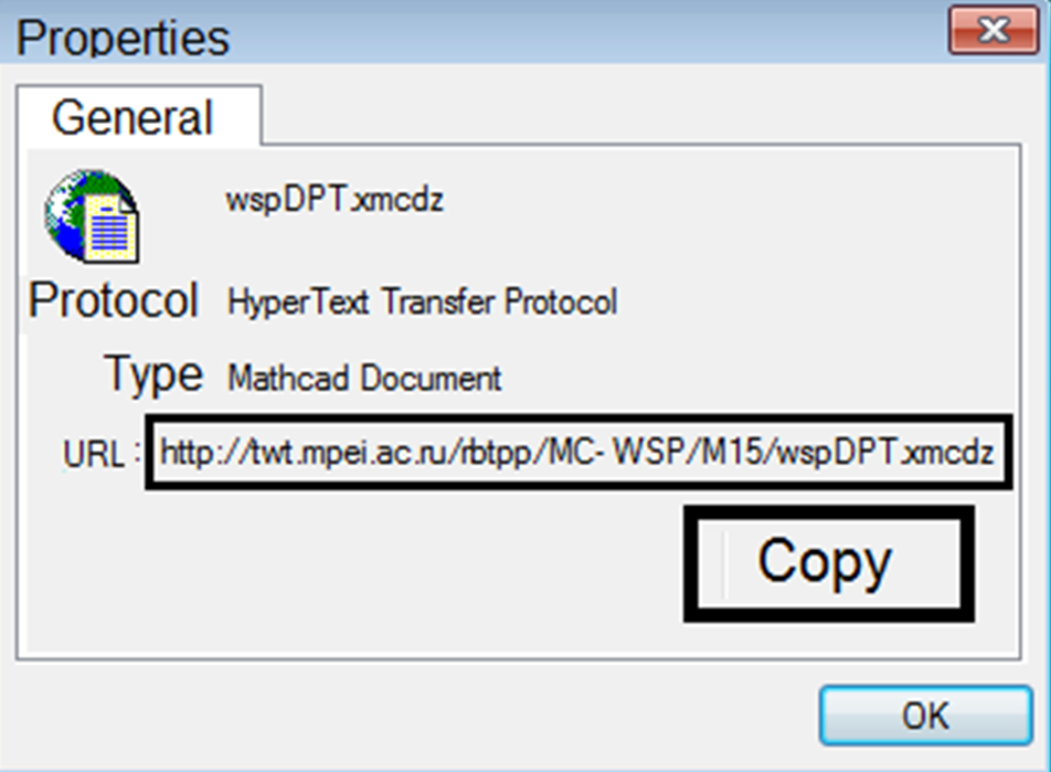

Fig. 16.4. URL of the “cloud” function “Water and steam dynamic viscosity”

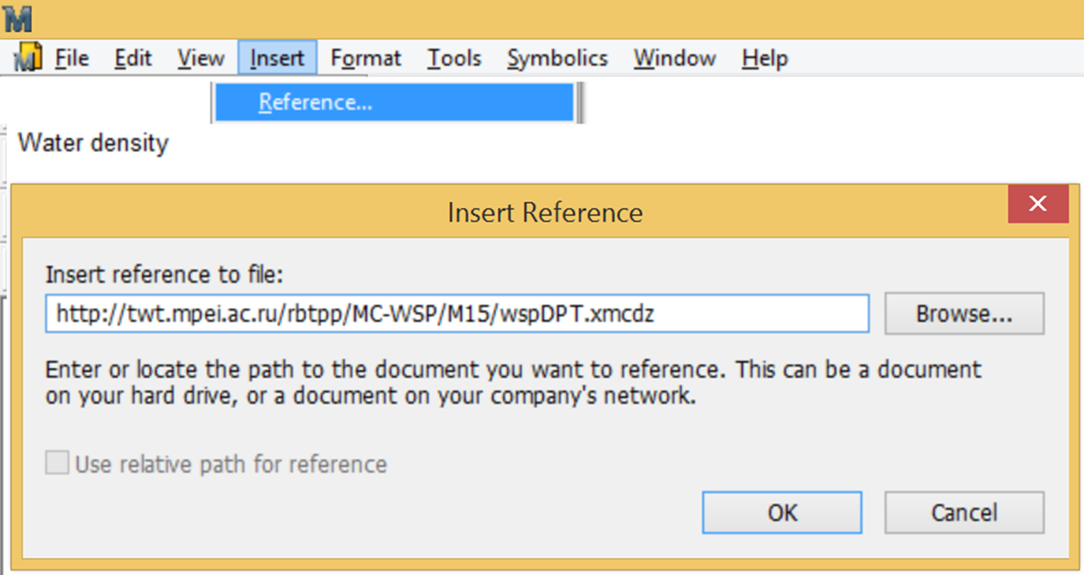

Fig. 16.5. Inserting reference in the “cloud” function of water density

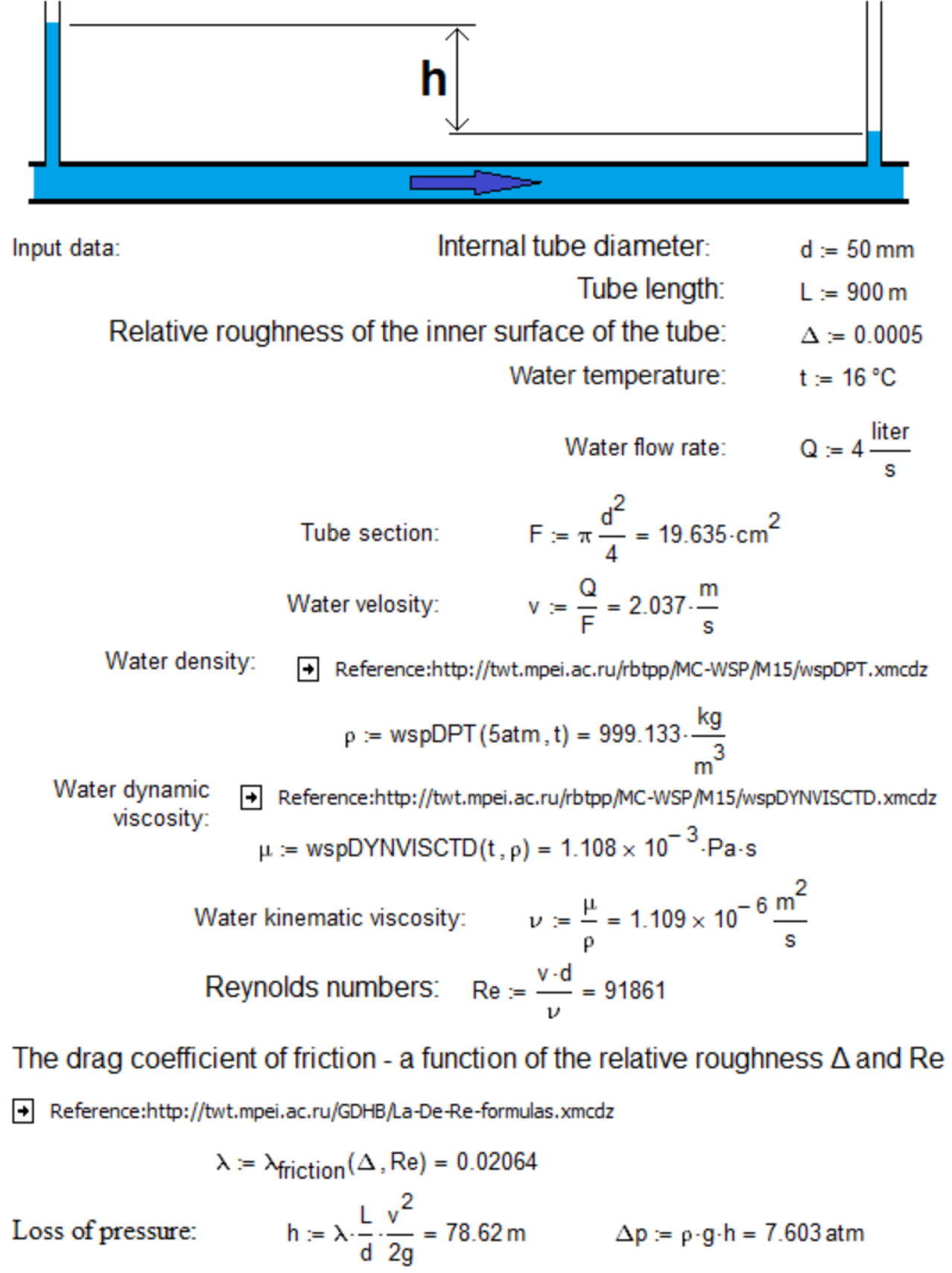

Fig. 16.6. Calculation of loss of water pressure in the tubing

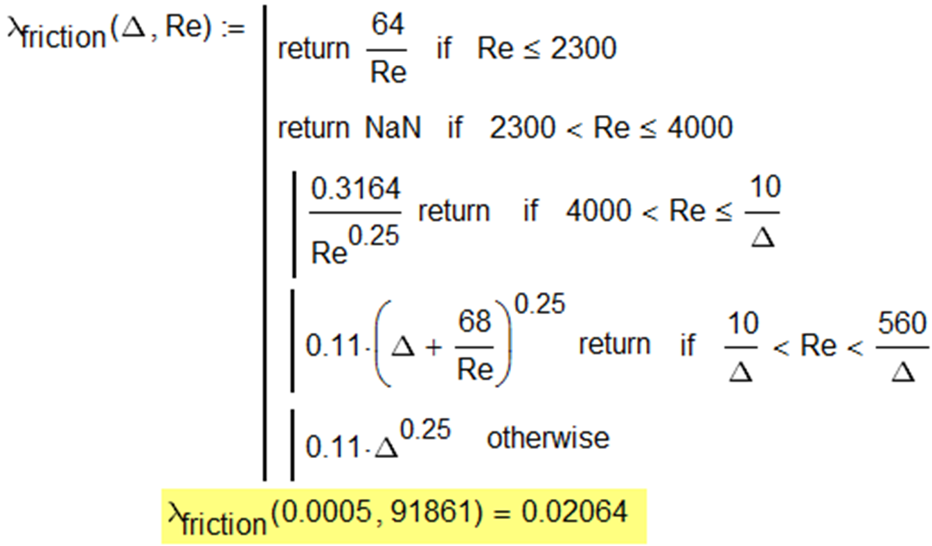

Fig. 16.7. Characteristic curve of relative coefficient of friction and parameters of water flow in the round tube - http://twt.mpei.ac.ru/MCS/Worksheets/Hydro/La-De-Re.xmcd
Fig. 16.8. Set of formulae for calculation of the relative coefficient of friction versus parameters of water flow in the round tube

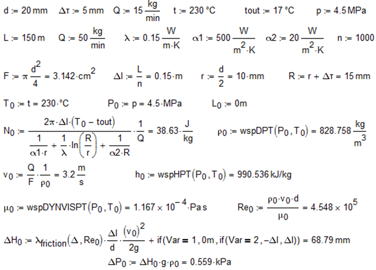

Fig. 16.9. Calculation of the initial section of the tubing (Var = 1: horizontal tubing)

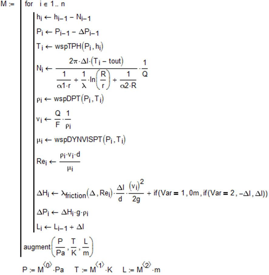

Fig. 16.10. Element-by-element calculation of the tubing

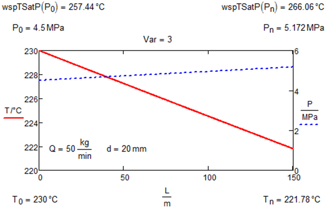

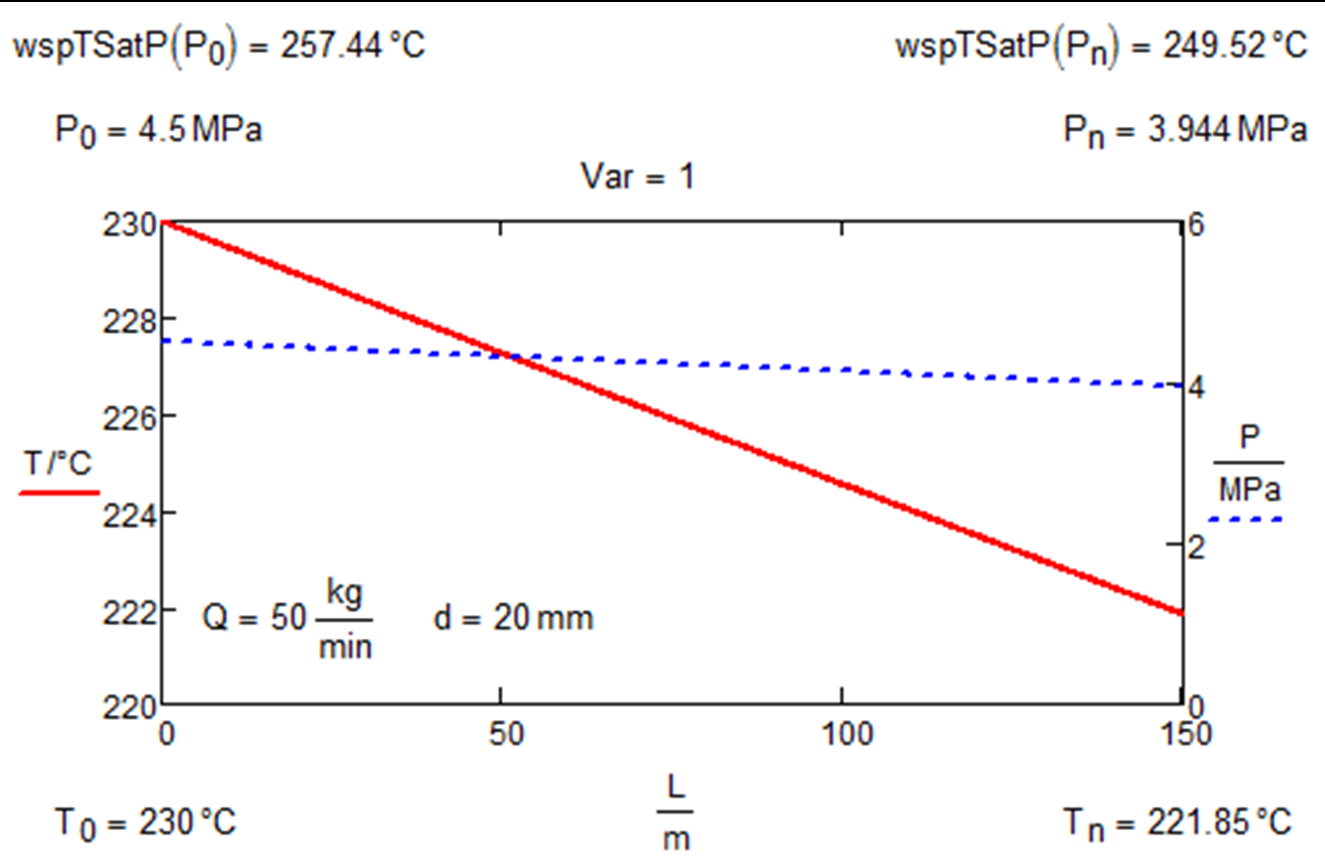

Fig. 16.11. Water temperature and pressure curves in the horizontal tubing - http://twt.mpei.ac.ru/MCS/Worksheets/Hydro/TubeMChS.xmcd

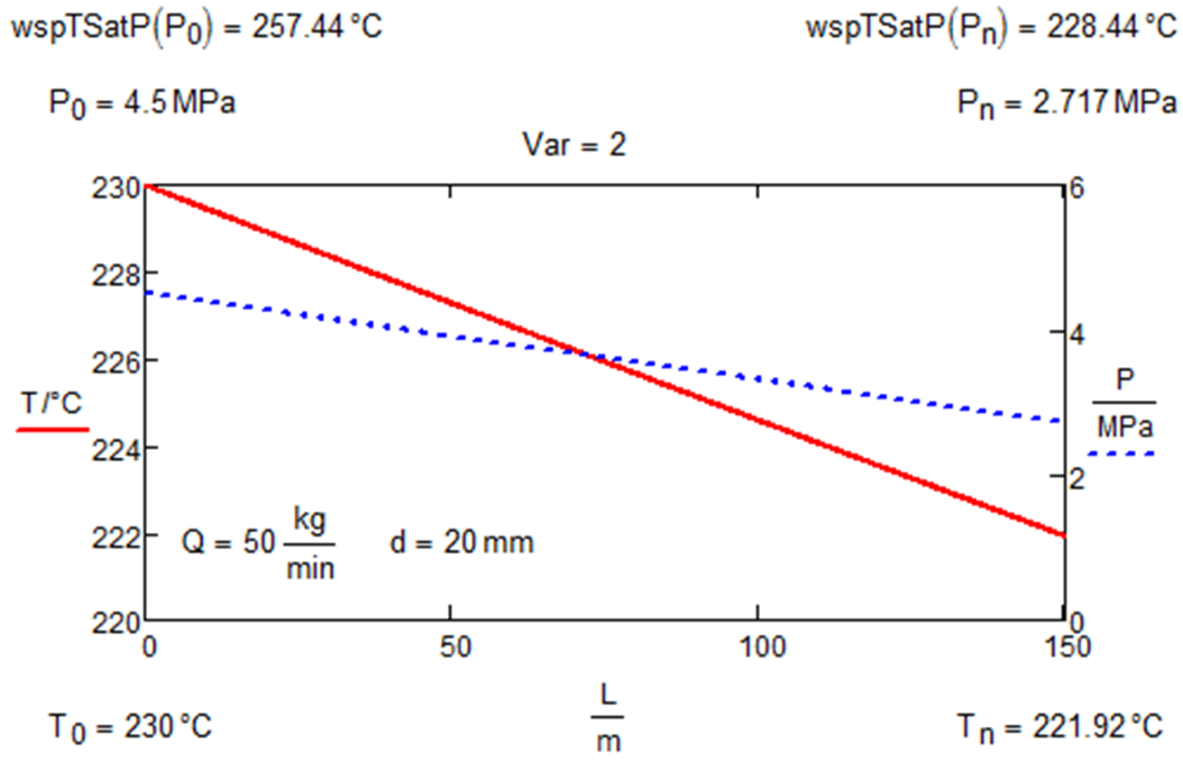

Fig. 16.12. Water temperature and pressure curves in the vertical tubing (pump at the top) - http://twt.mpei.ac.ru/MCS/Worksheets/Hydro/TubeMChS.xmcd
Fig. 16.13. Water temperature and pressure curves in the vertical tubing (pump at the bottom) - http://twt.mpei.ac.ru/MCS/Worksheets/Hydro/TubeMChS.xmcd

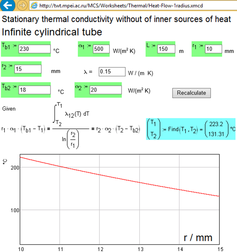

Fig. 16.14. Temperature profile in the cylindrical wall - http://twt.mpei.ac.ru/MCS/Worksheets/Thermal/Heat-Flow-1radius.xmcd

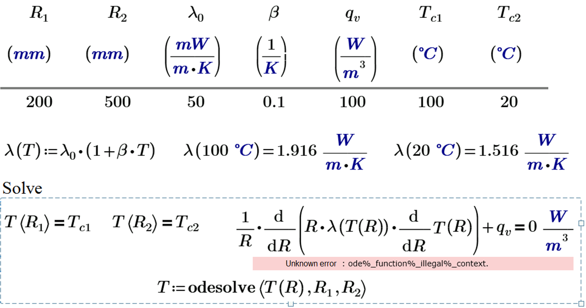

Fig. 16.15. Solving the problem of the temperature profile in the cylindrical wall (beginning)

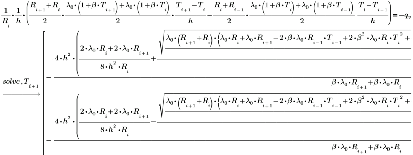

Fig. 16.16. Difference equation of heat conduction in the cylindrical wall and its solving by means of Mathcad symbolic mathematics

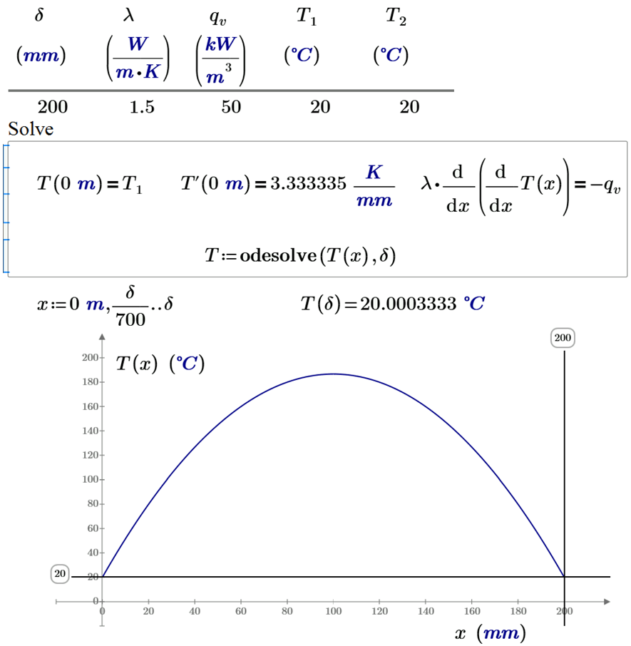

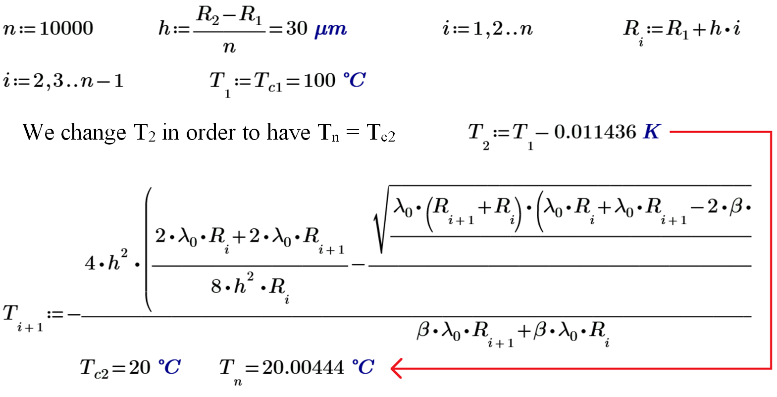

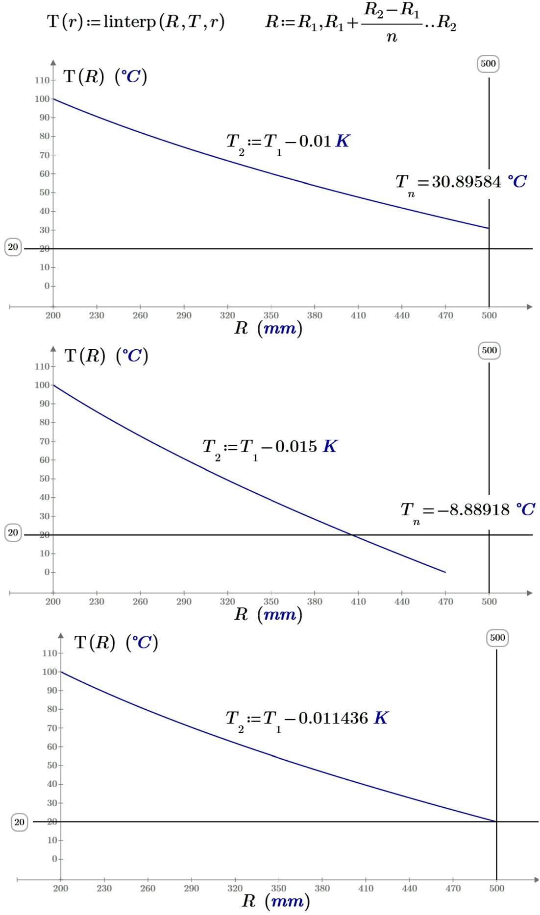

Fig. 16.17. Solving the problem of the temperature profile by the shooting method
Fig. 16.18. Result of solving the problem of the temperature profile by the shooting method
