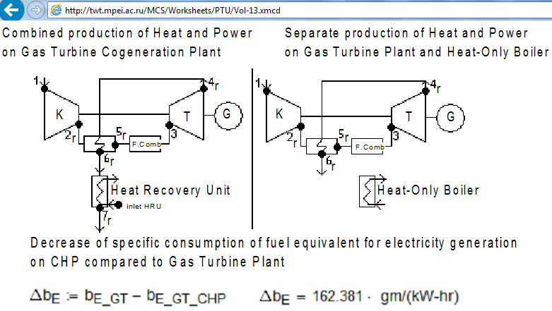

Fig. 17.2 Calculation of fuel economy on a CHP gas turbine compared to separate power generation (http://twt.mpei.ac.ru/MCS/Worksheets/PTU/Vol-13.xmcd)
Fig. 17.3 Determination of equivalent fuel economy for district heating with the turbine type T (district heating) compared to separated production of the same amount of electricity and heat (http://twtmas.mpei.ac.ru/mas/Worksheets/ES/Vol-8.mcd)

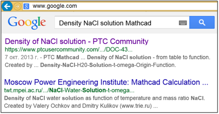

Fig. 17.4 Search in Google

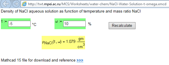

Fig. 17.5 Interactive computation of NaCl water solution density (http://twt.mpei.ac.ru/MCS/Worksheets/water-chem/NaCl-Water-Solution-t-omega.xmcd)
Fig. 17.6 Access to information about the file URL
Fig. 17.7 Reference in Mathcad 15

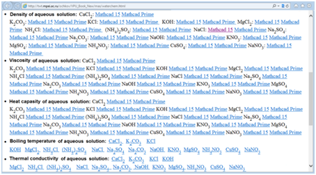

Fig. 17.8 Website page displaying physical properties of aqueous solutions of salts (Водная химия)

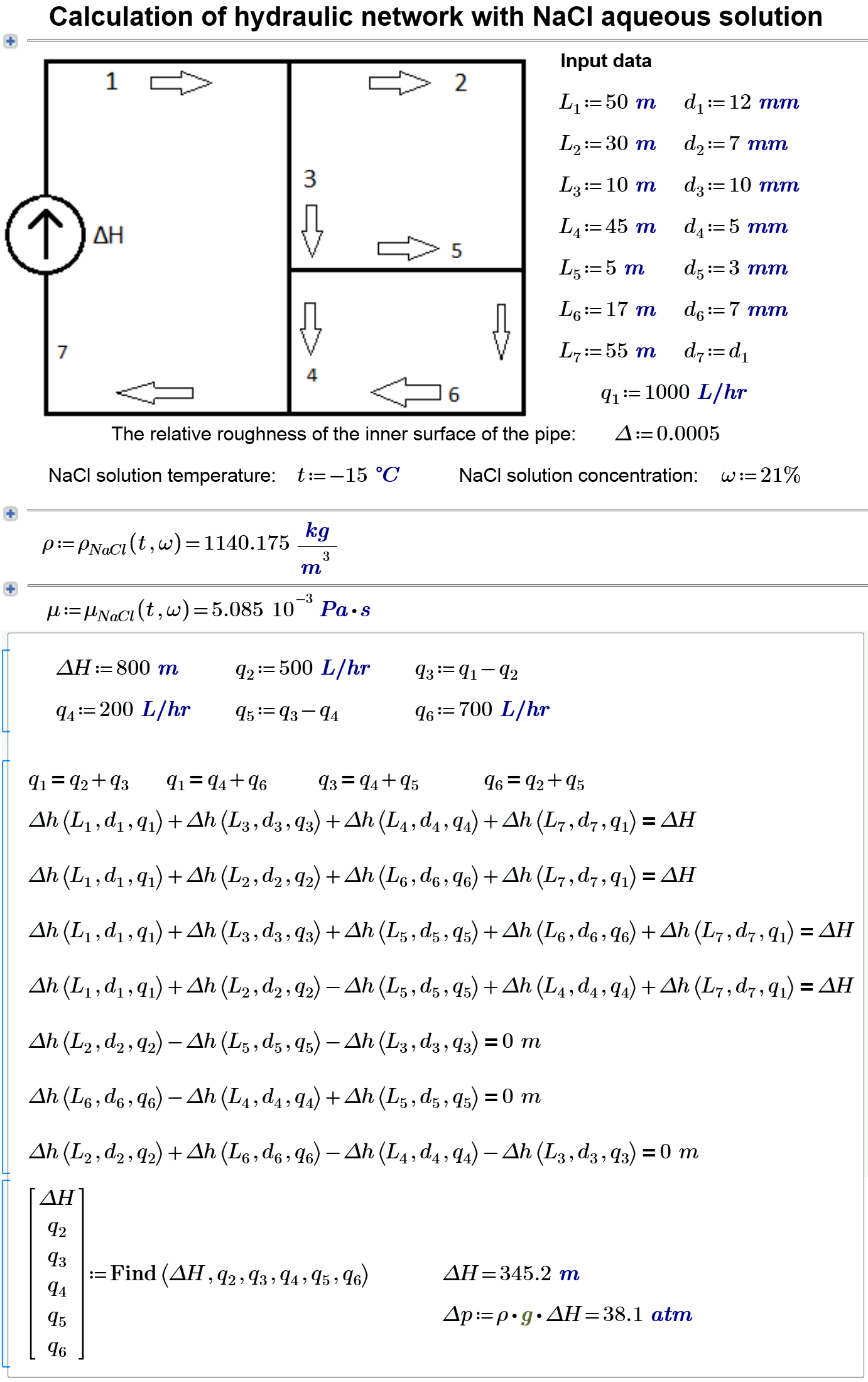

Fig. 17.9 Example of hydraulic calculations in Mathcad 15

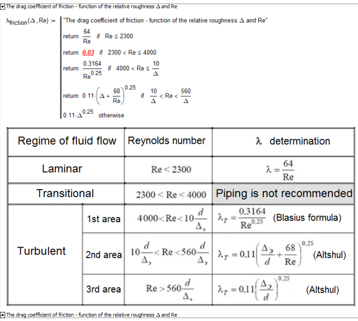

Fig. 17.10 Calculation of the resistance to flow of fluid in the pipe

Fig. 17.12 Example of hydraulic calculations in Mathcad Prime

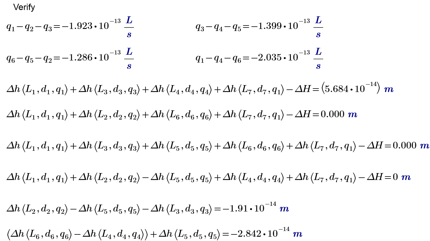

Fig. 17.13 Verifying the hydraulic calculation in Mathcad Prime

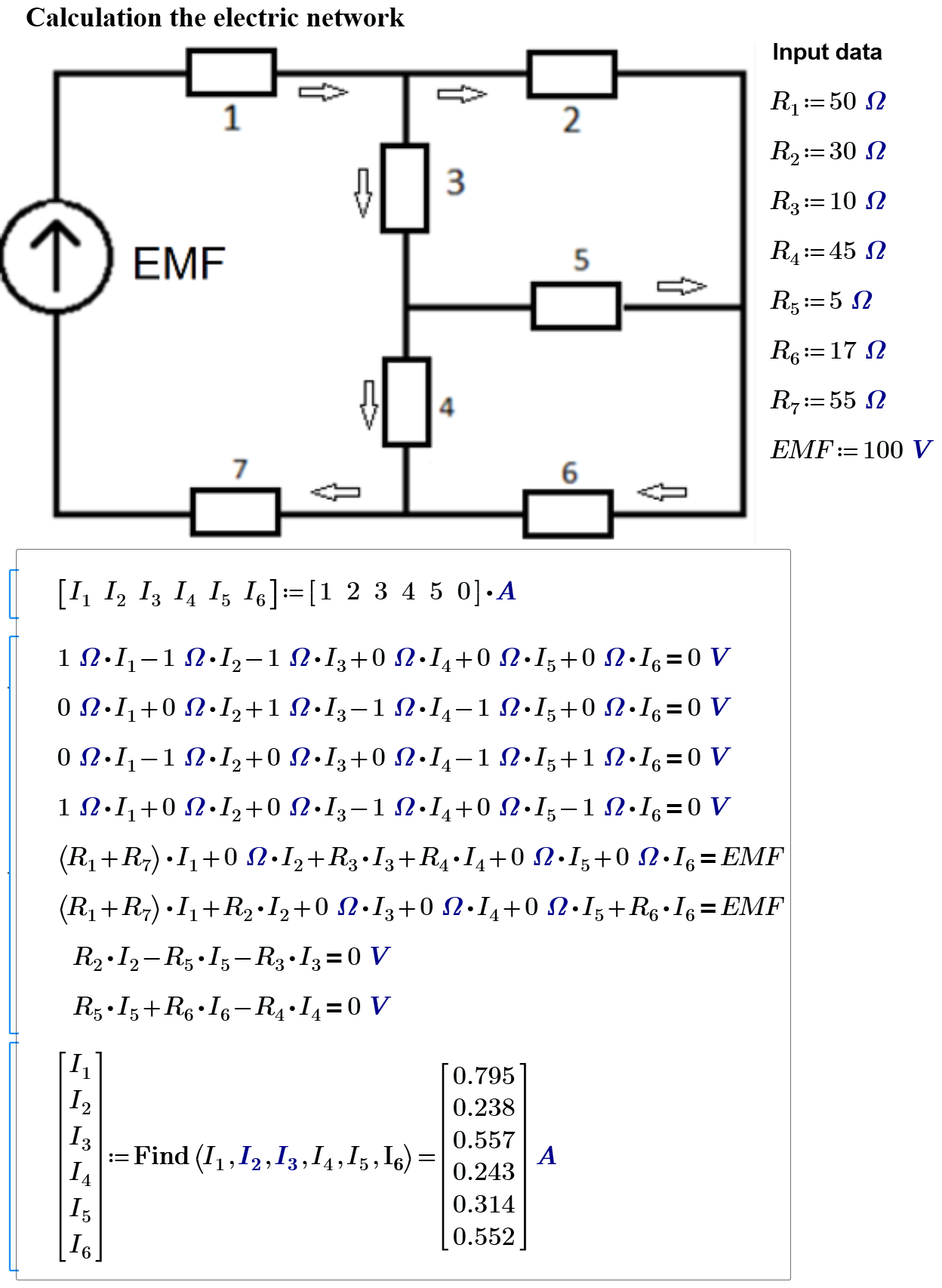

Fig. 17.15. Example of one electrical calculation in Mathcad Prime

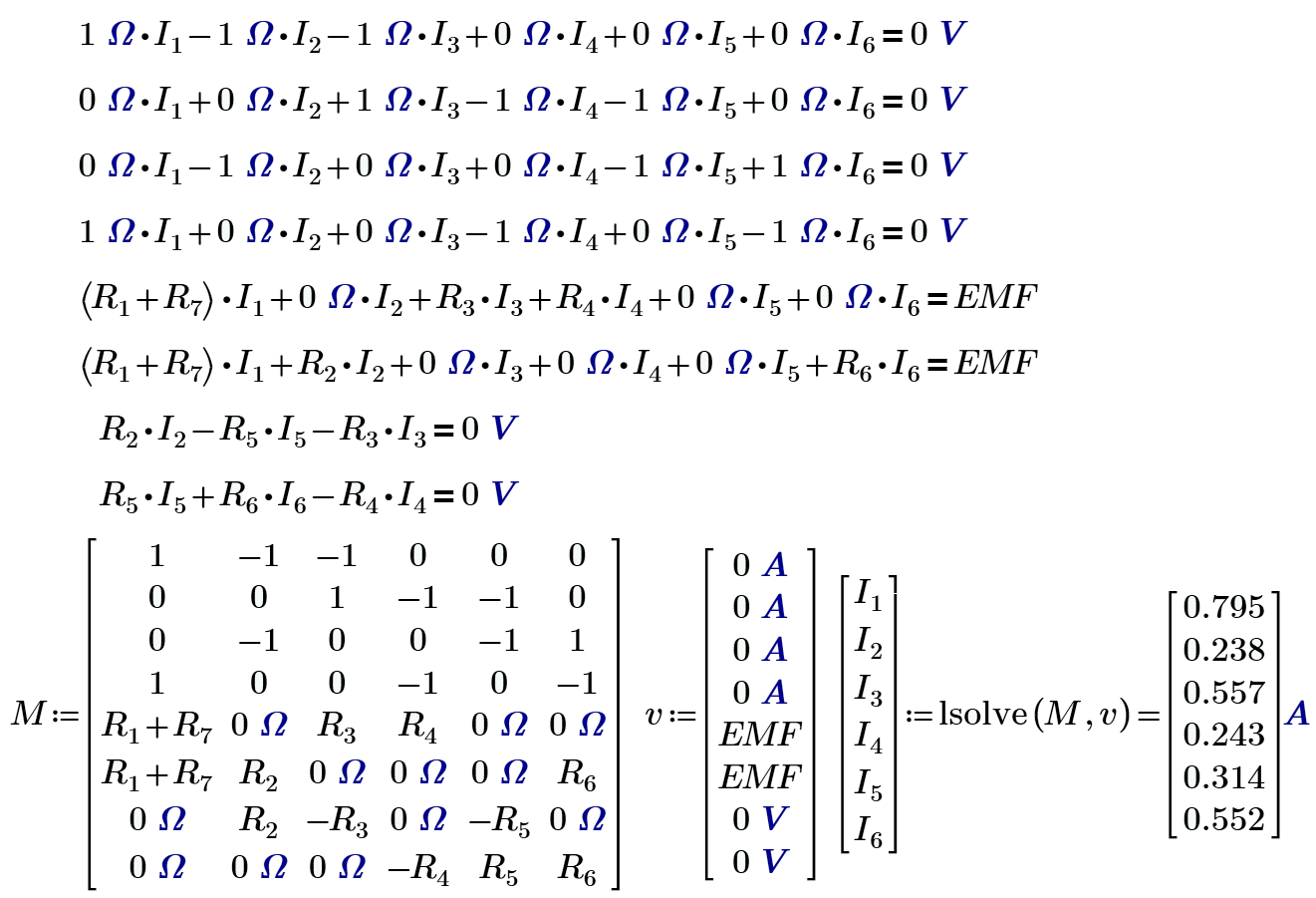

Fig. 17.16. The solution of an overdetermined system of linear algebraic equations in Mathcad Prime
Fig. 17.17. Analysis and solution of the "classical" system of linear algebraic equations in Mathcad Prime
Fig. 17.18 Analysis of wrongly composed linear algebraic equations

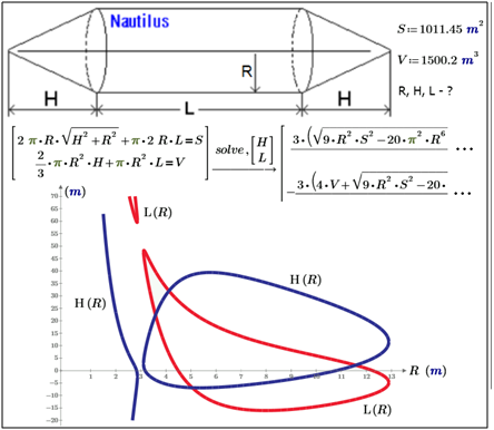

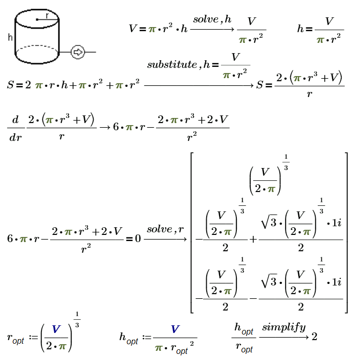

Fig. 17.20 Numerical solution of the problem of the optimal size of the cylinder
Fig. 17.21 Analytical solution of the problem of the optimal size of the cylinder
Fig. 17.21a Analytical solution of the problem of the optimal size of the cylinder in Maple new
Fig. 17.22 The combination of analytical and graphical methods in solving the problem of the optimum size of the cylinder
