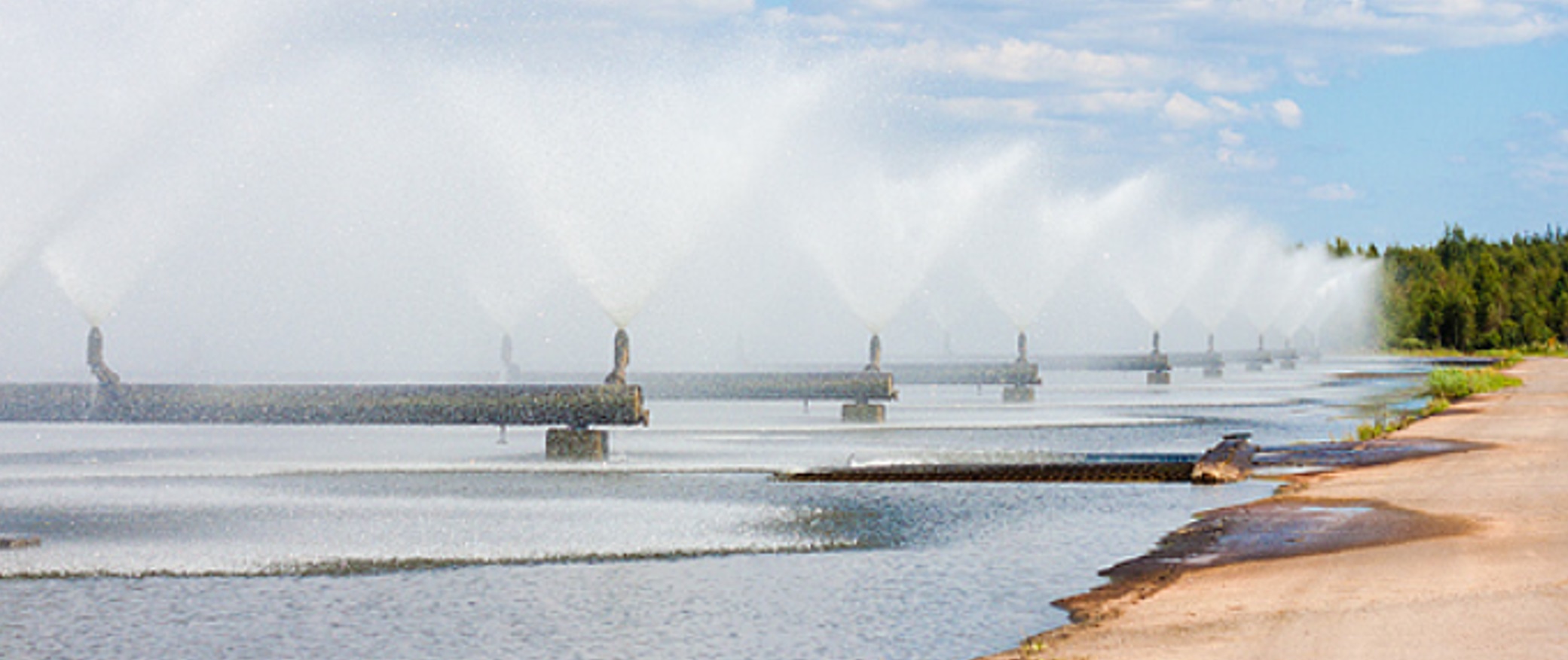

Fig. 18.1. Spray cooling pond

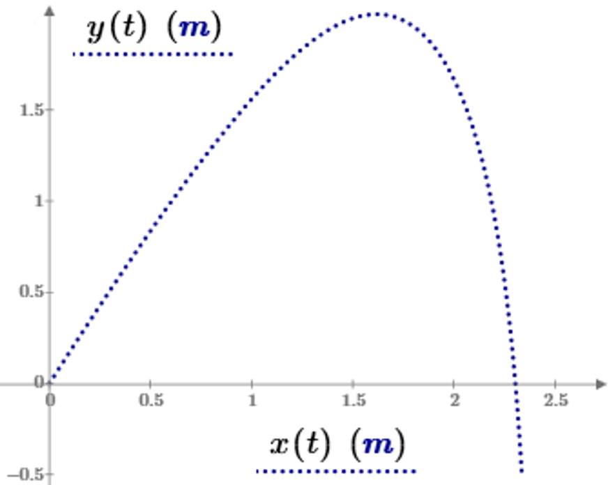

Fig. 18.4. Flight of water drop in weak headwind

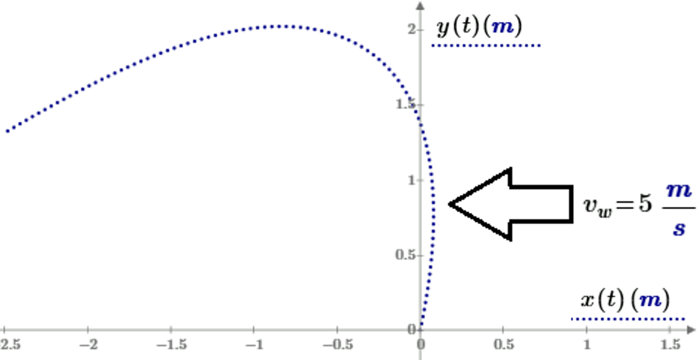

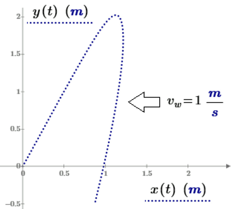

Fig. 18.5. Flight of water drop in strong headwind

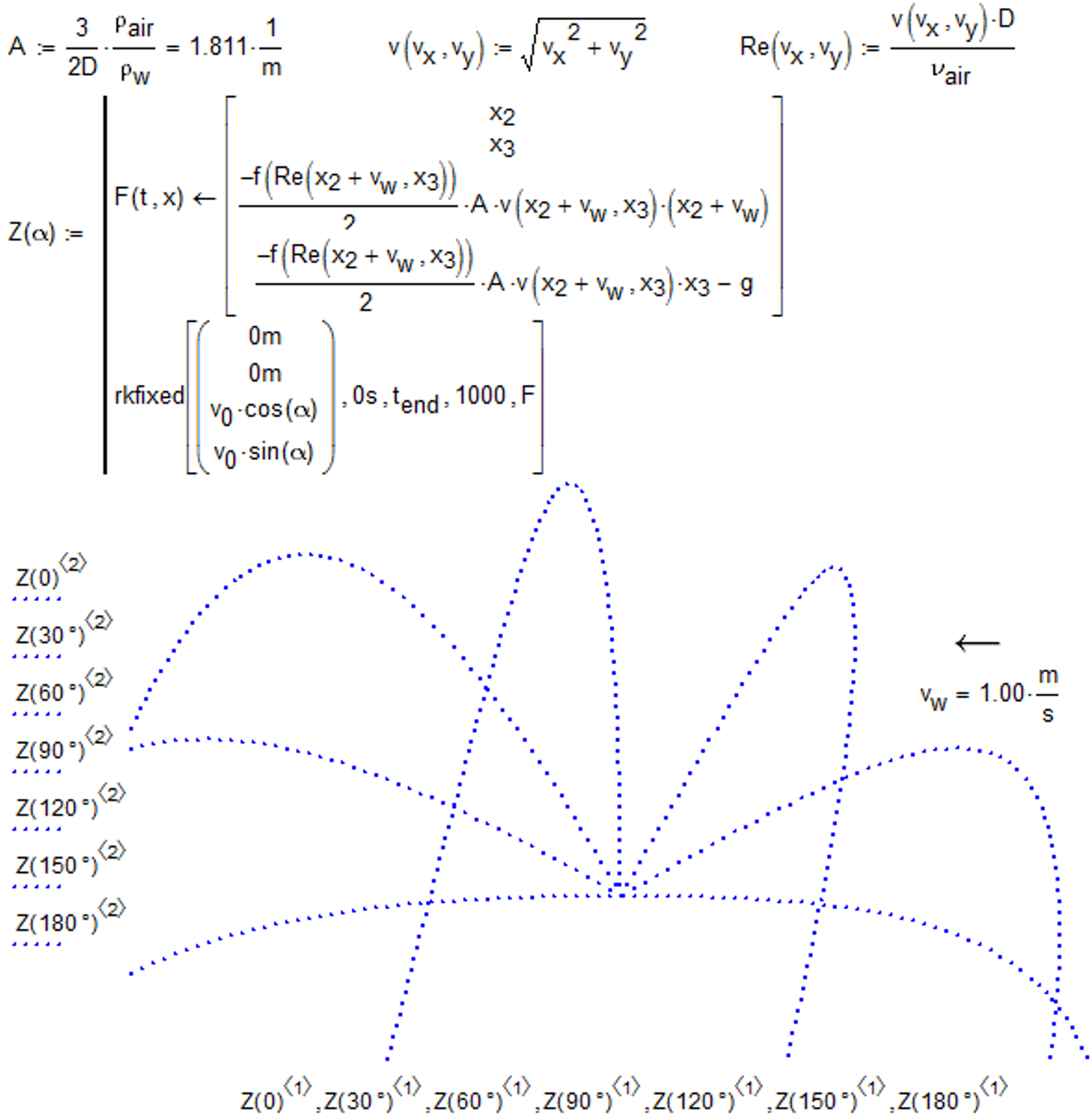

Fig. 18.6. Solution of Differential Equations with Additional Parameter

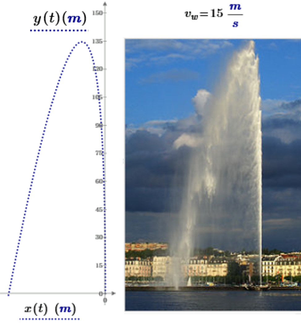

Fig. 18.7. Virtual and real fountains

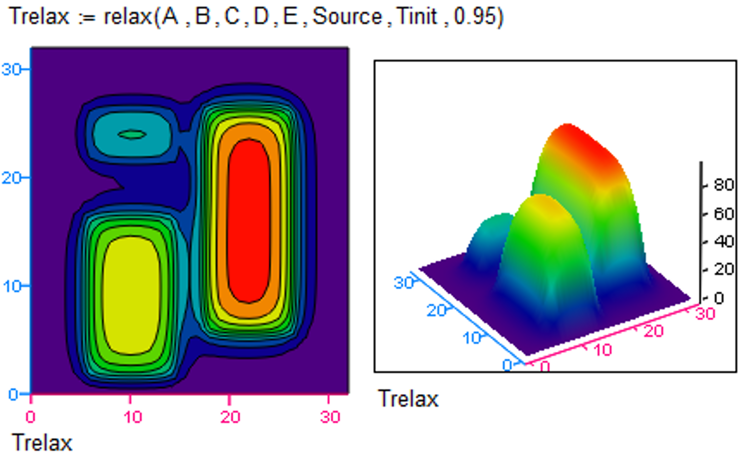

Fig. 18.8. Simulation of Temperature Field of Computer Board

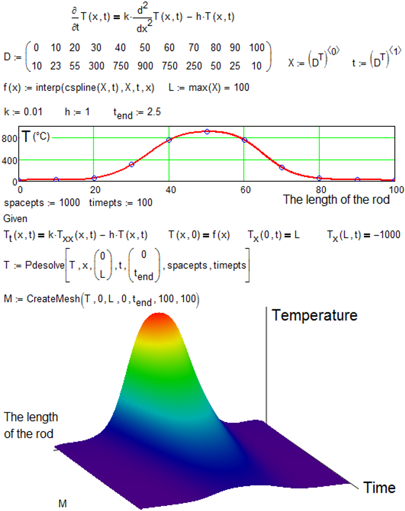

Fig. 18.9. Numerical Solution of Non-Stationary Heat Transfer Problem

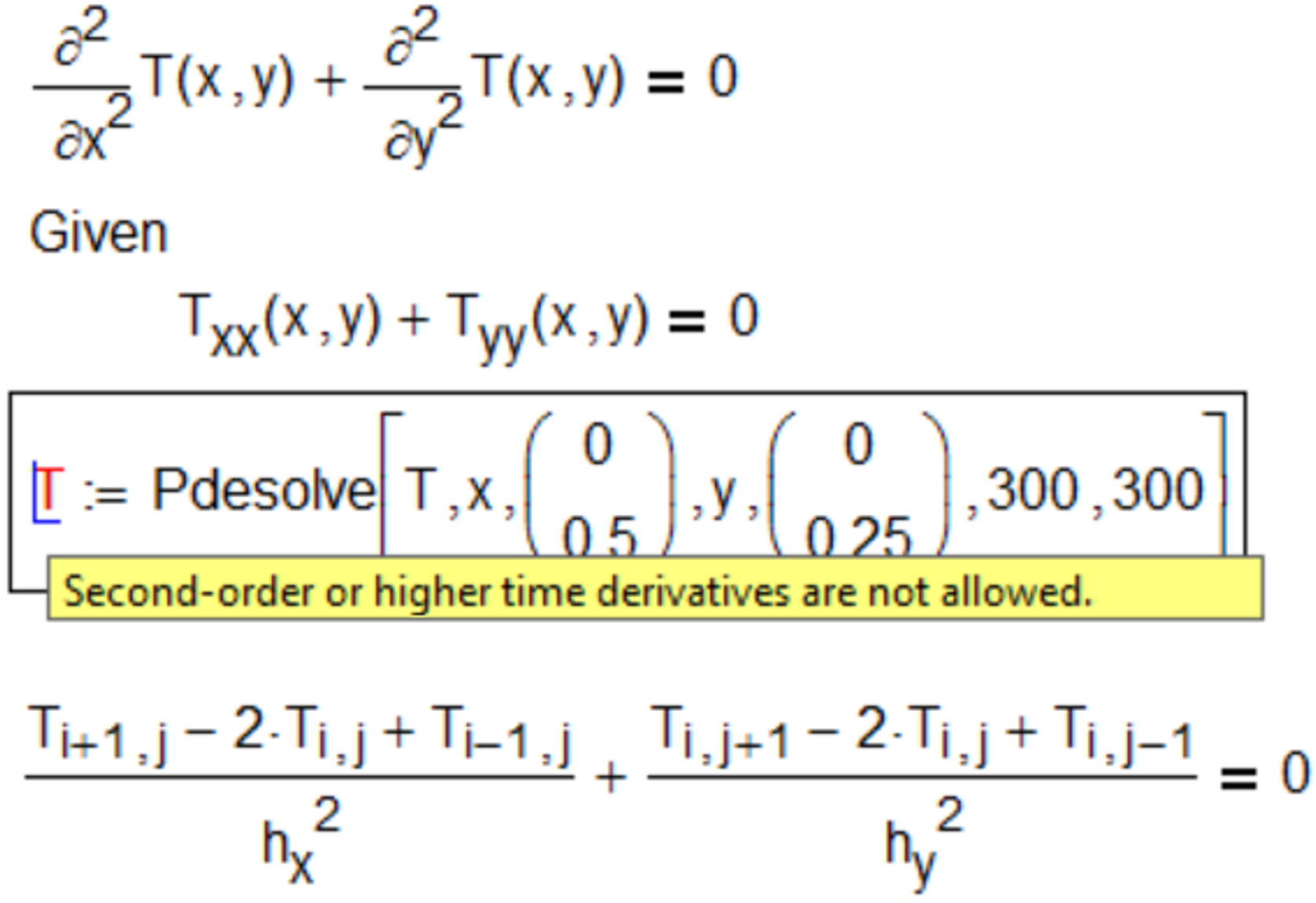

Fig. 18.10. Unsuccessful Attempt to Call pdesolve Function

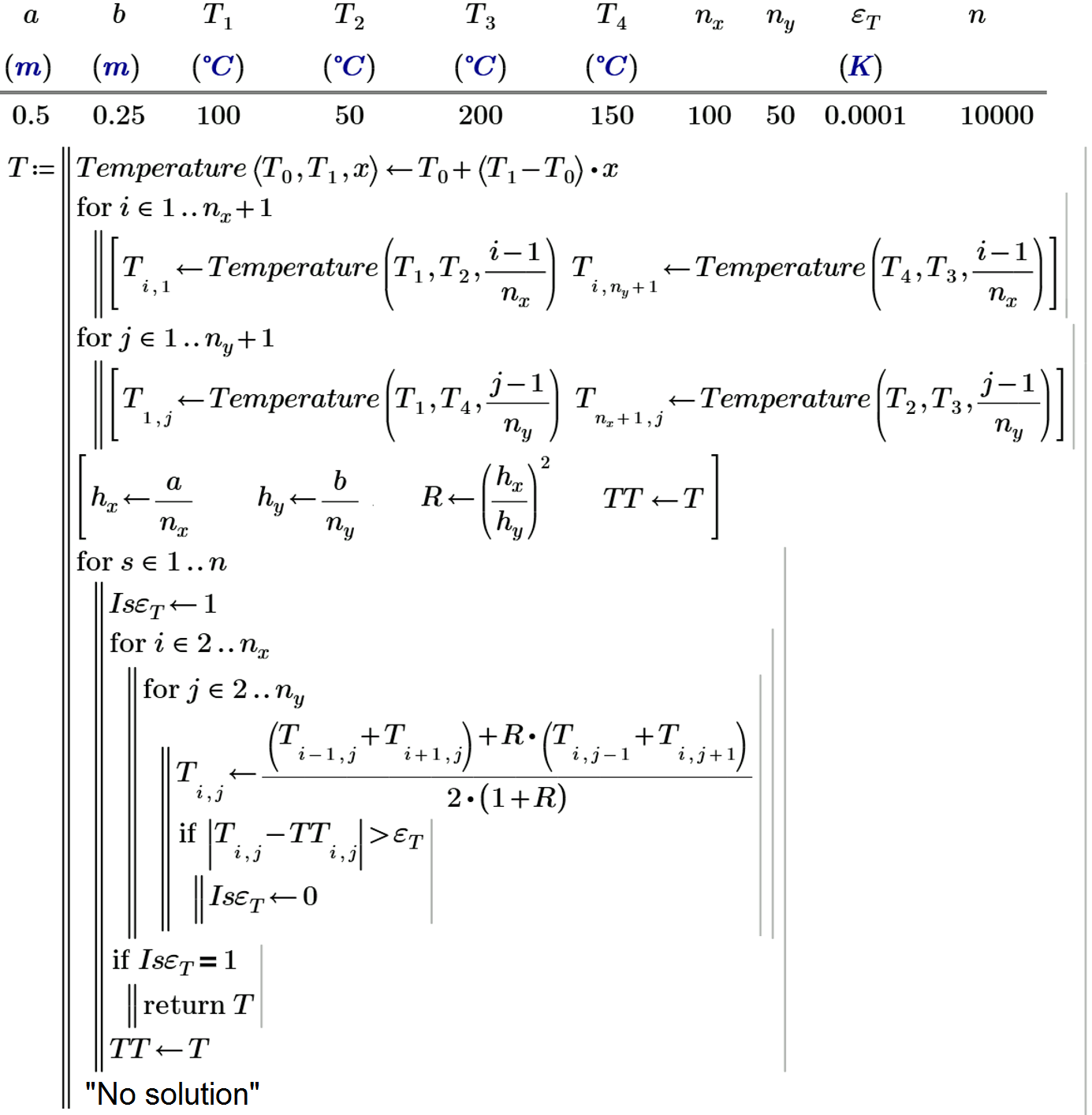

Fig. 18.11. Solution of Problem about Temperature Field in the Plate

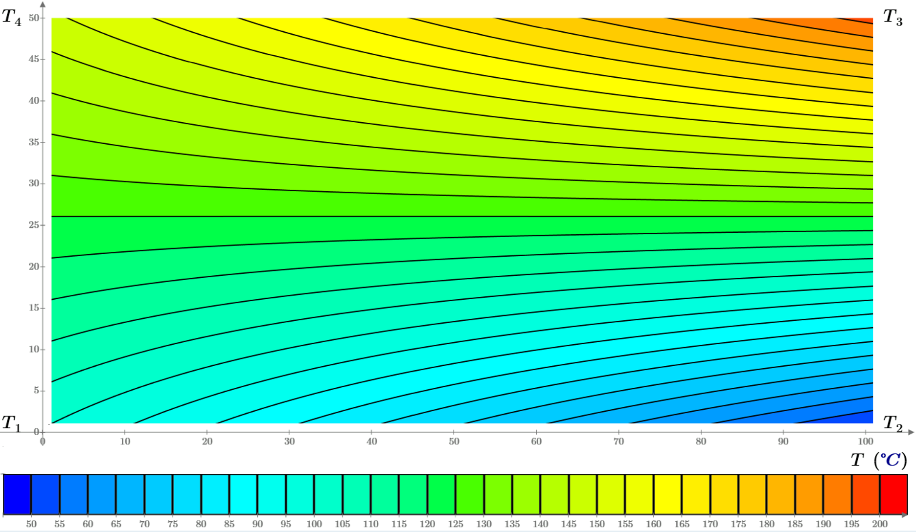

Fig 18.12. Temperature Field in Flat Plate
