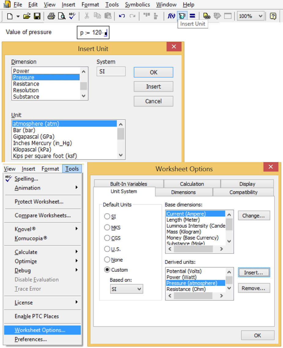

Fig. 2.1. Using units in Mathcad 15

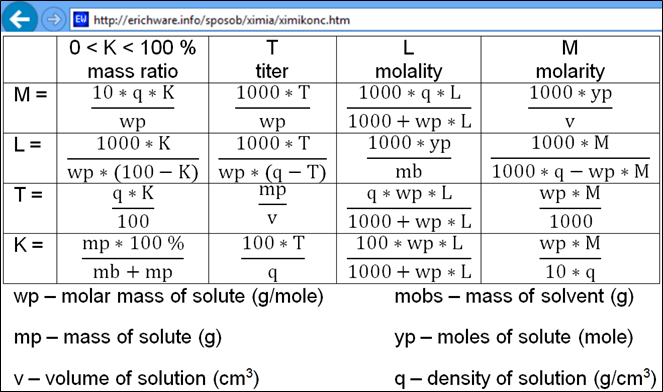

Fig. 2.4. Formula for the conversion of concentrations from the Internet

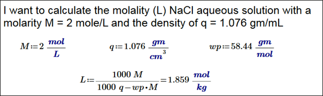

Fig. 2.5 Conversion of Molarity à Molality

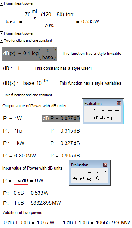

Fig. 2.10 Working with dB
Fig. 2.11 Working with decibels and a reference to the base

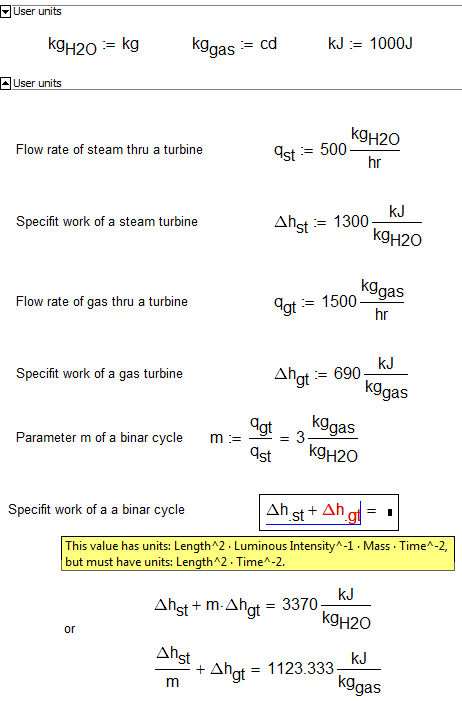

Fig. 2.24 Performance assessment of a combined cycle plant
Fig. 2.25 Demonstration of the toolkit for creating different quantities with the same unit
