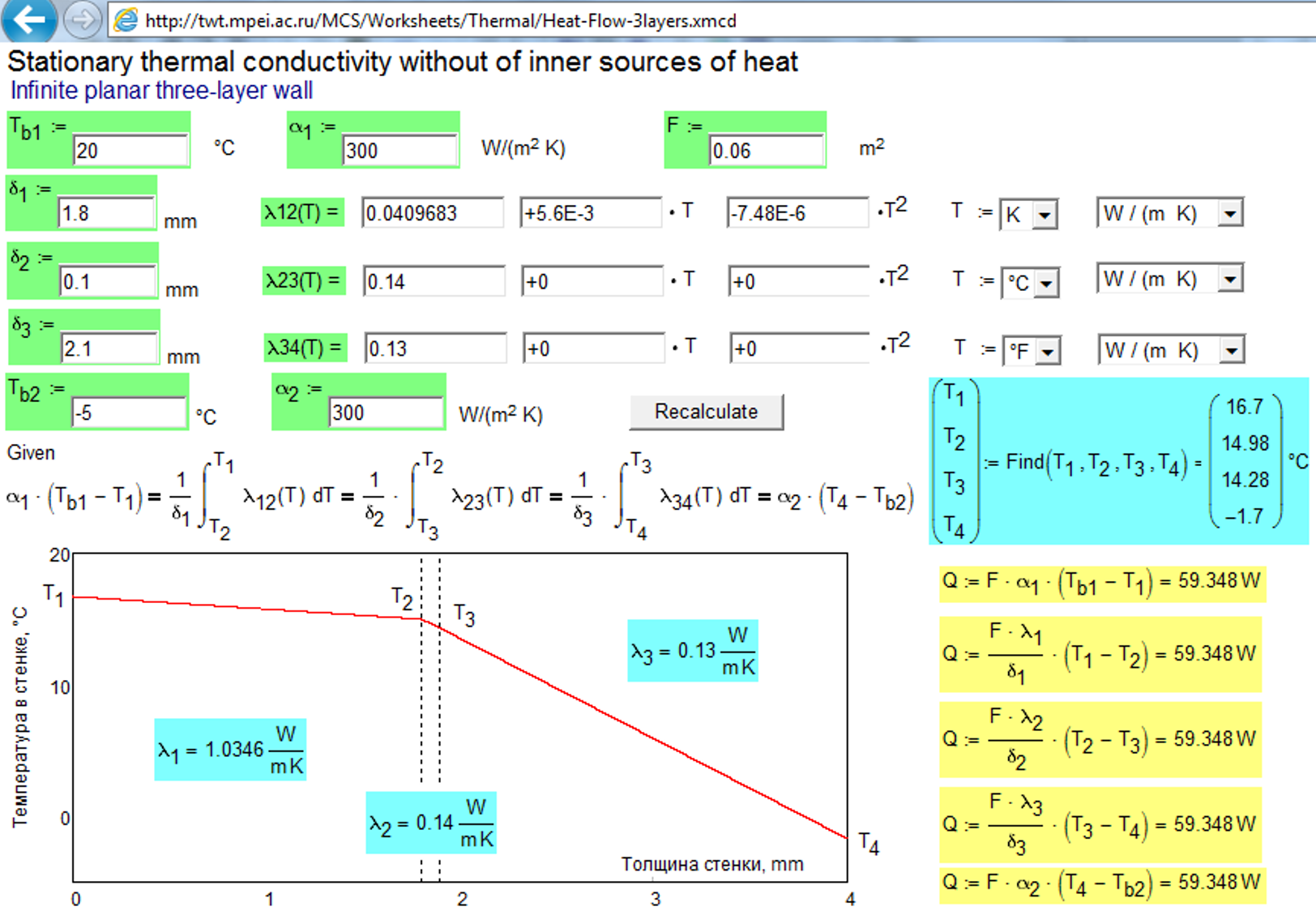

Fig. 20.1. Thermal conductivity of a three-layer wall

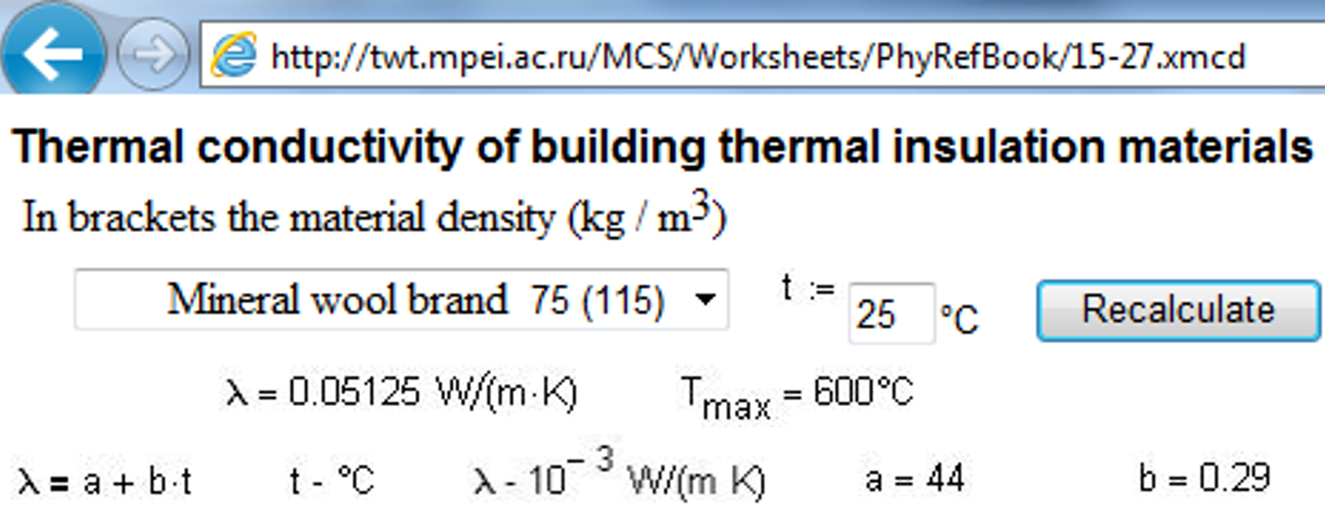

Fig. 20.2. Thermal conductivity of heat insulation materials

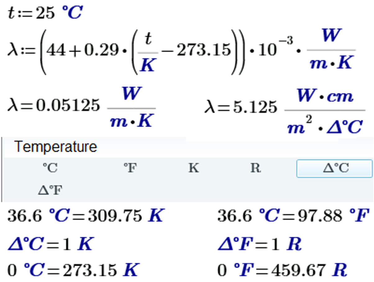

Fig. 20.3. A calculation of thermal conductivity dependence on temperature in Mathcad Prime

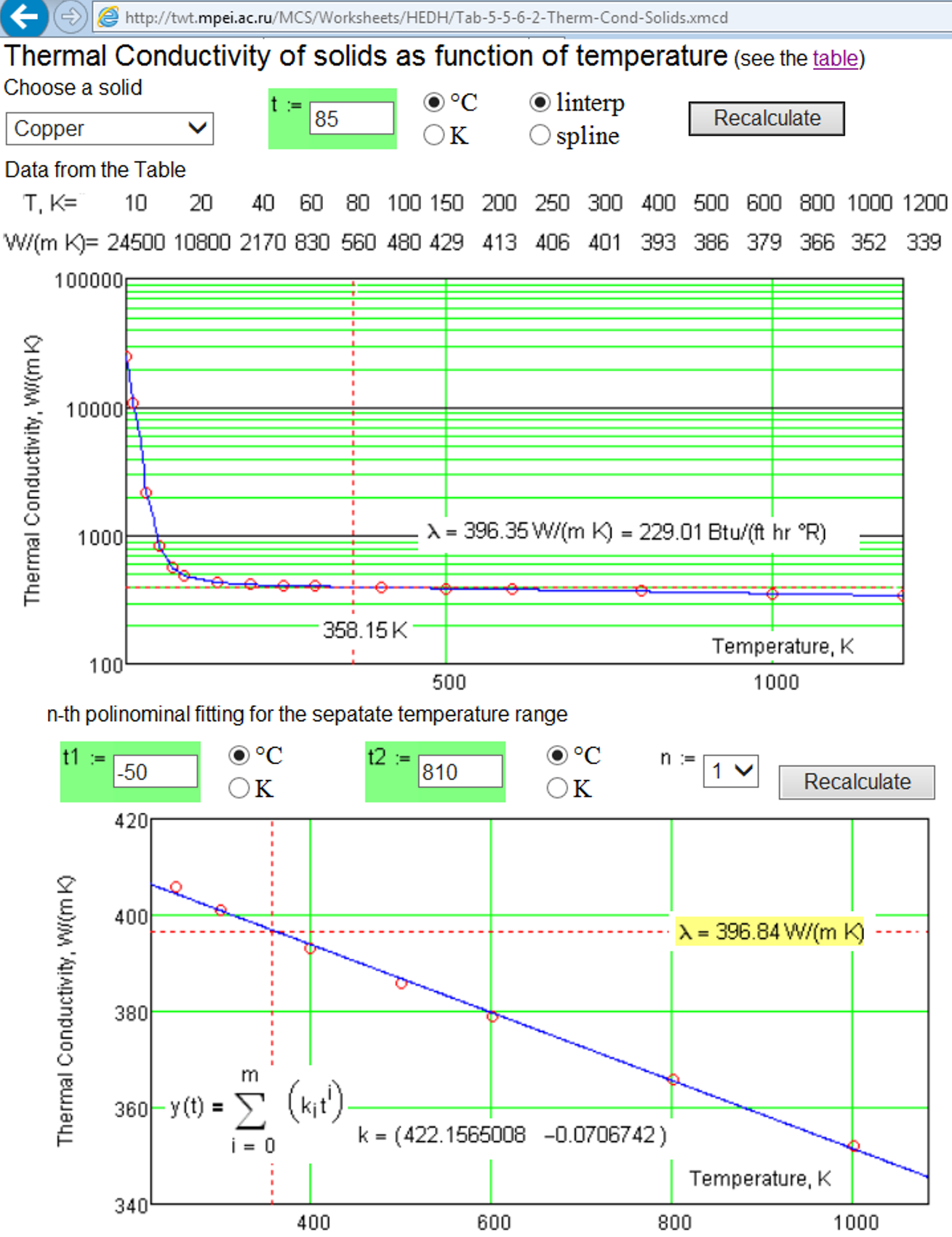

Fig. 20.4. Thermal conductivity of pure metals
Fig. 20.5. Inertia of reference tabulated thermal conductivity data

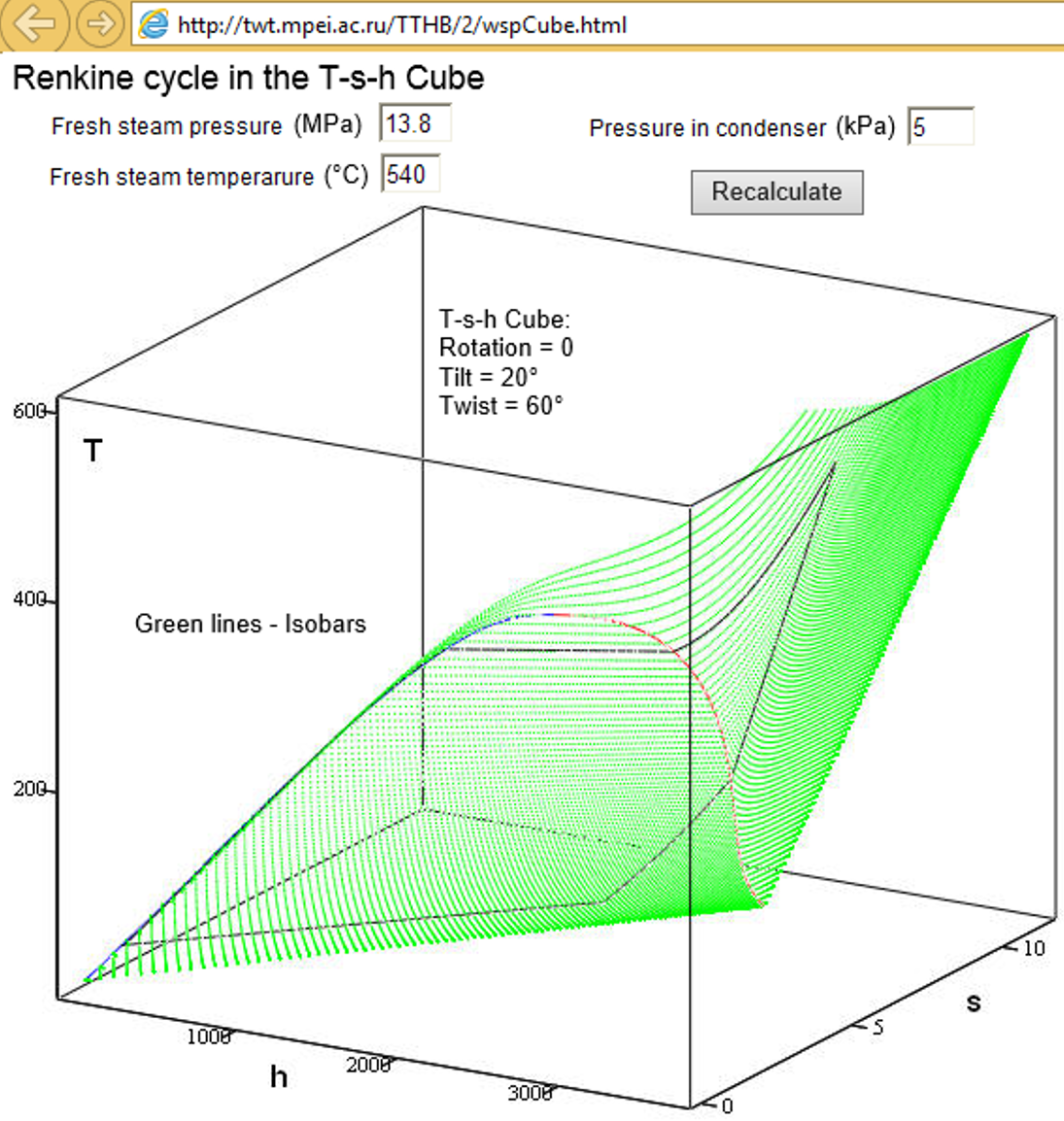

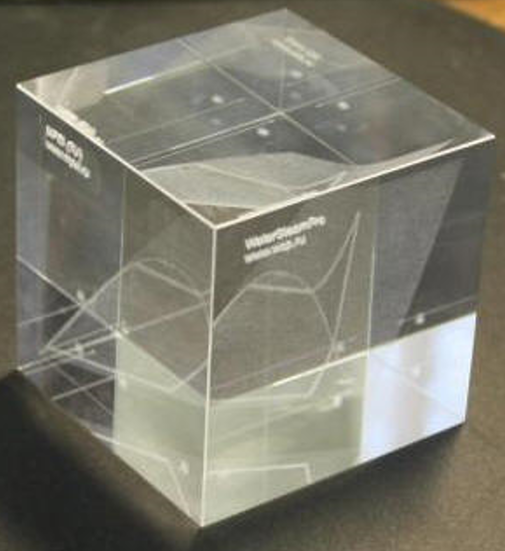

Fig. 20.6. WaterSteamPro-cube
Fig. 20.7. Virtual WaterSteamPro-cube - http://twt.mpei.ac.ru/MCS/Worksheets/WSP/wspCube.xmcd
