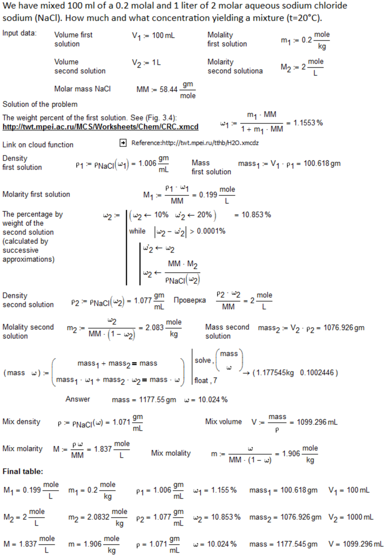

Fig. 3.1. Problem of solution parameters

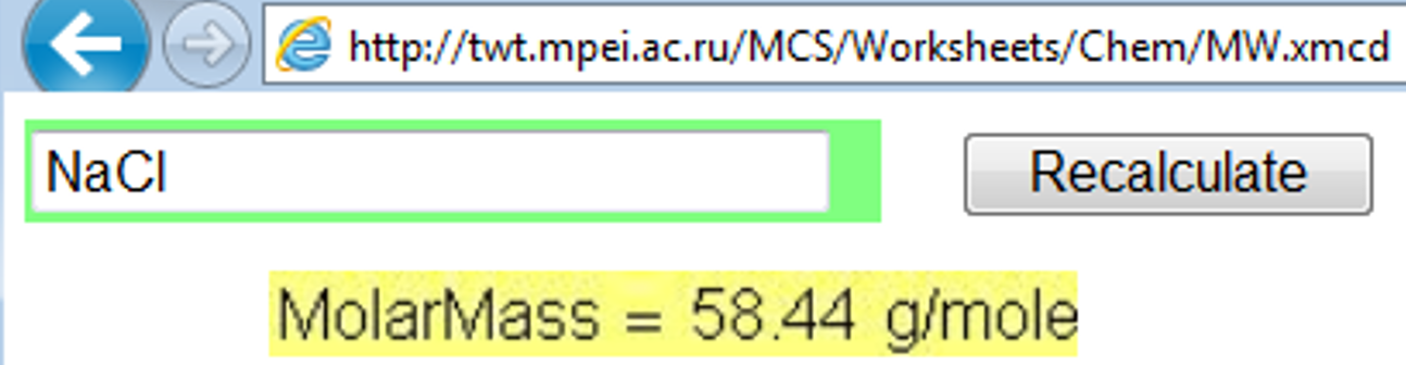

Fig. 3.2. Online calculation of molar mass - http://twt.mpei.ac.ru/MCS/Worksheets/Chem/MW.xmcd

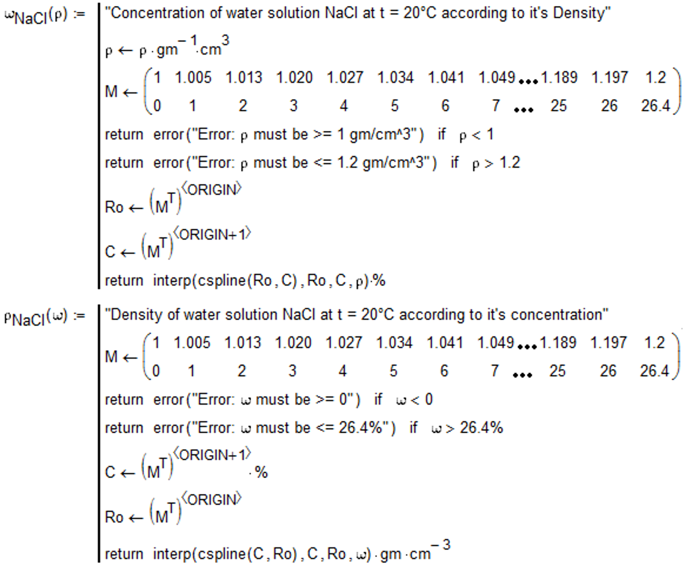

Fig. 3.3. Direct and inverse functions of density and concentration (mass percentage) of NaCl aqueous solution

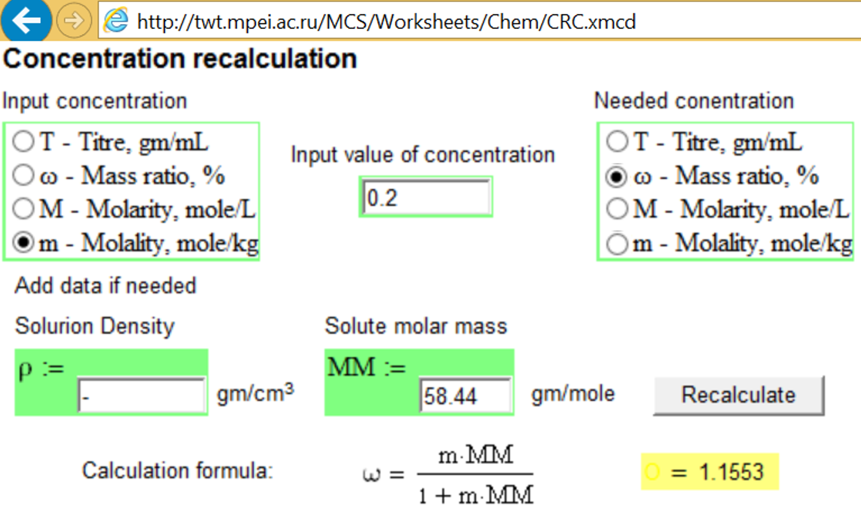

Fig. 3.4. Online calculation of concentration - http://twt.mpei.ac.ru/MCS/Worksheets/Chem/CRC.xmcd

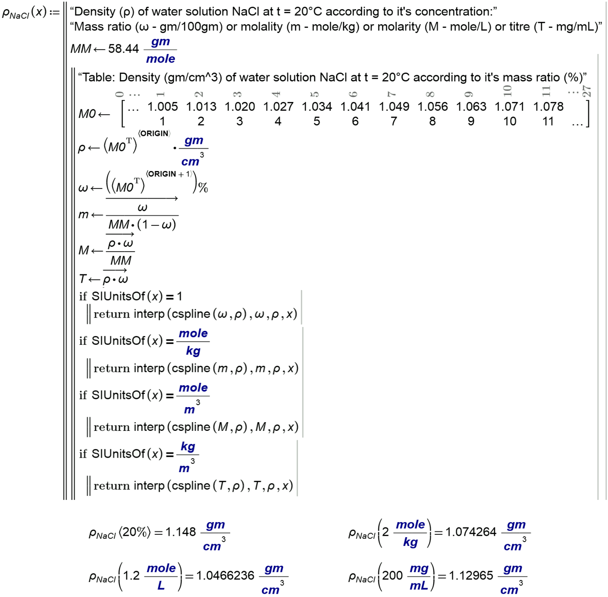

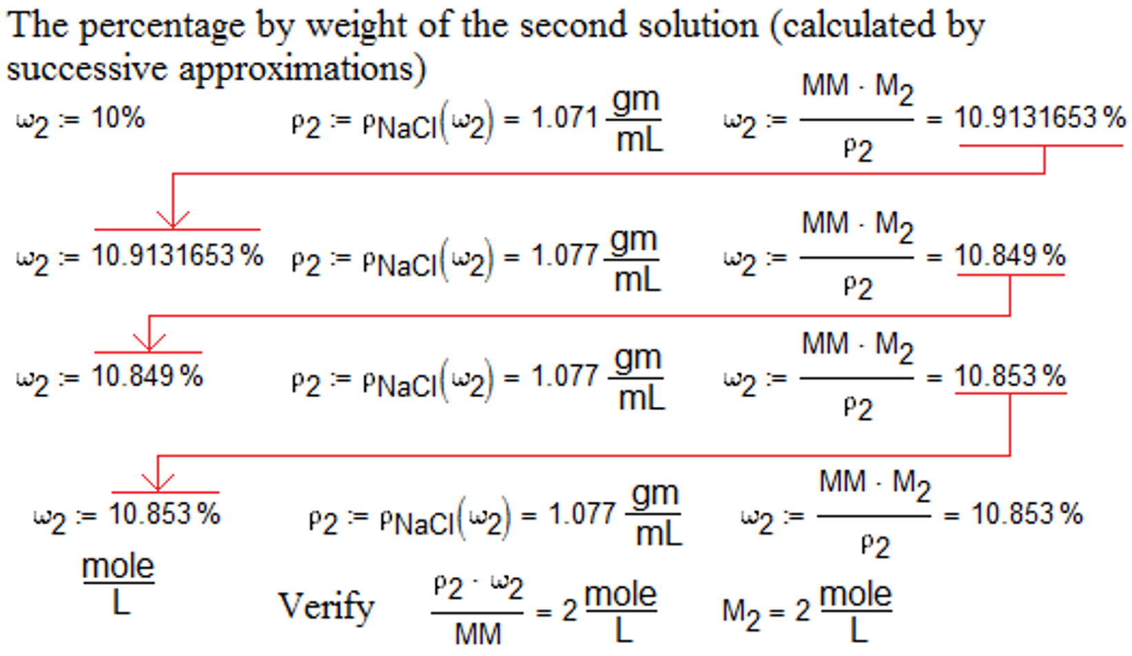

Fig. 3.5. Method of sequential approximations in a manual mode

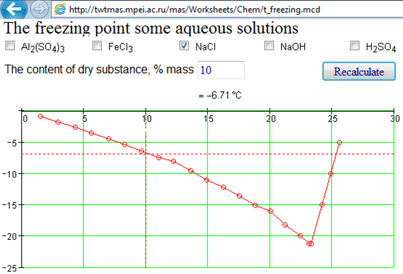

Fig. 3.6. Freezing temperature of some aqueous solutions depending on temperature - http://twtmas.mpei.ac.ru/mas/Worksheets/Chem/t_freezing.mcd
Fig. 3.7. Calculation of density of NaCl solution for any type of concentration
