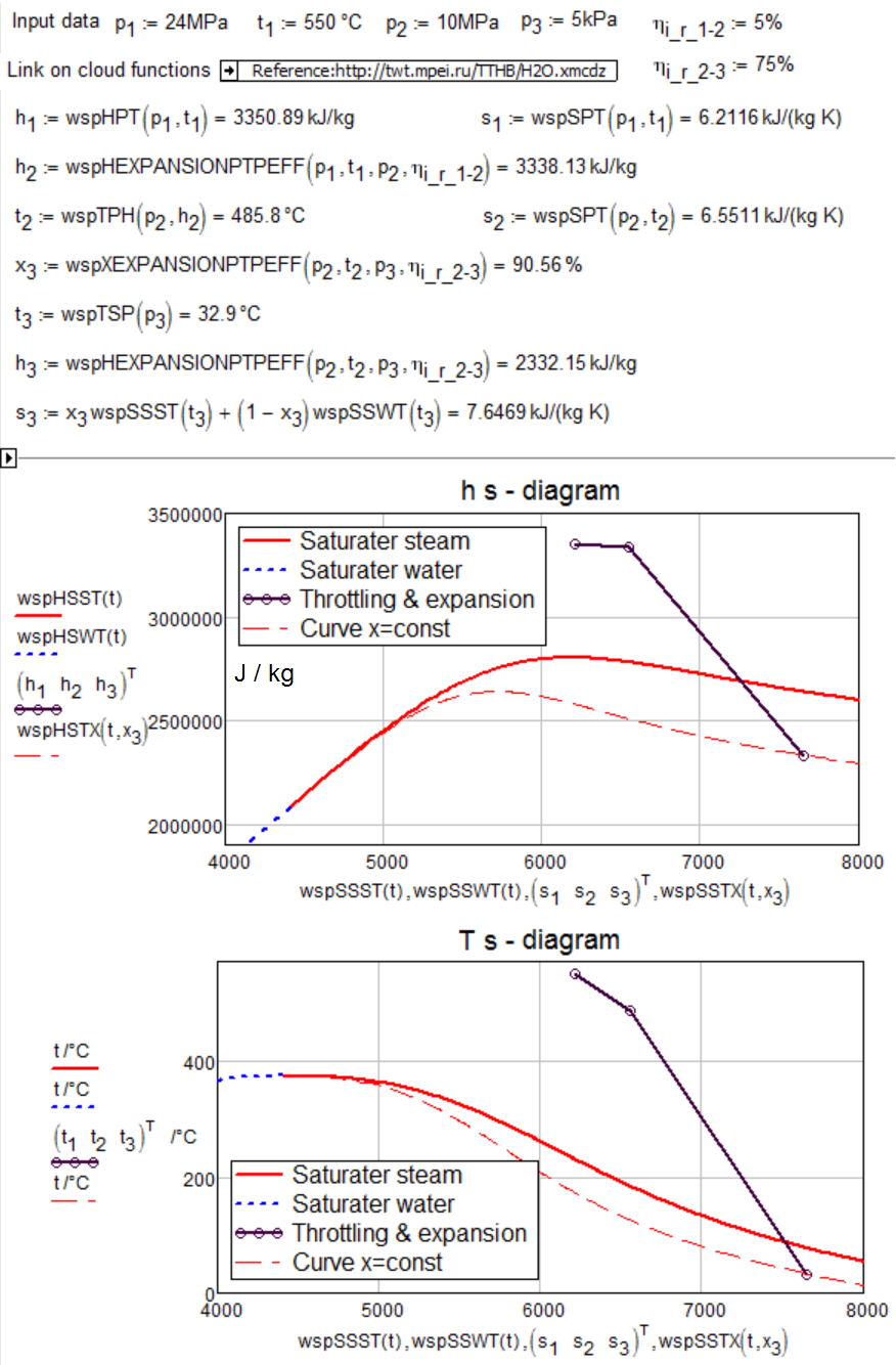

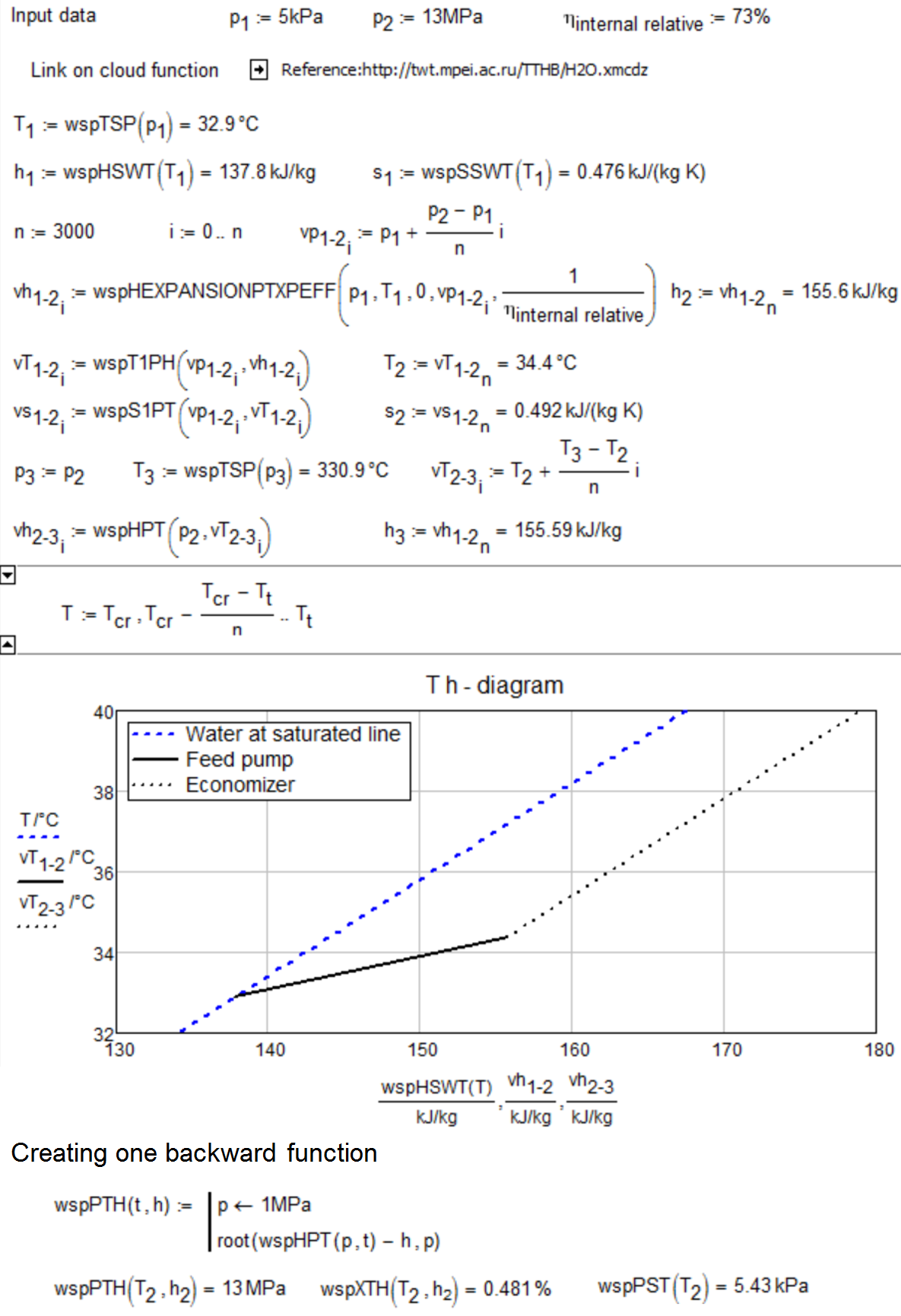

Fig. 5.1. Calculation Process throttling and expansion of steam in the turbine

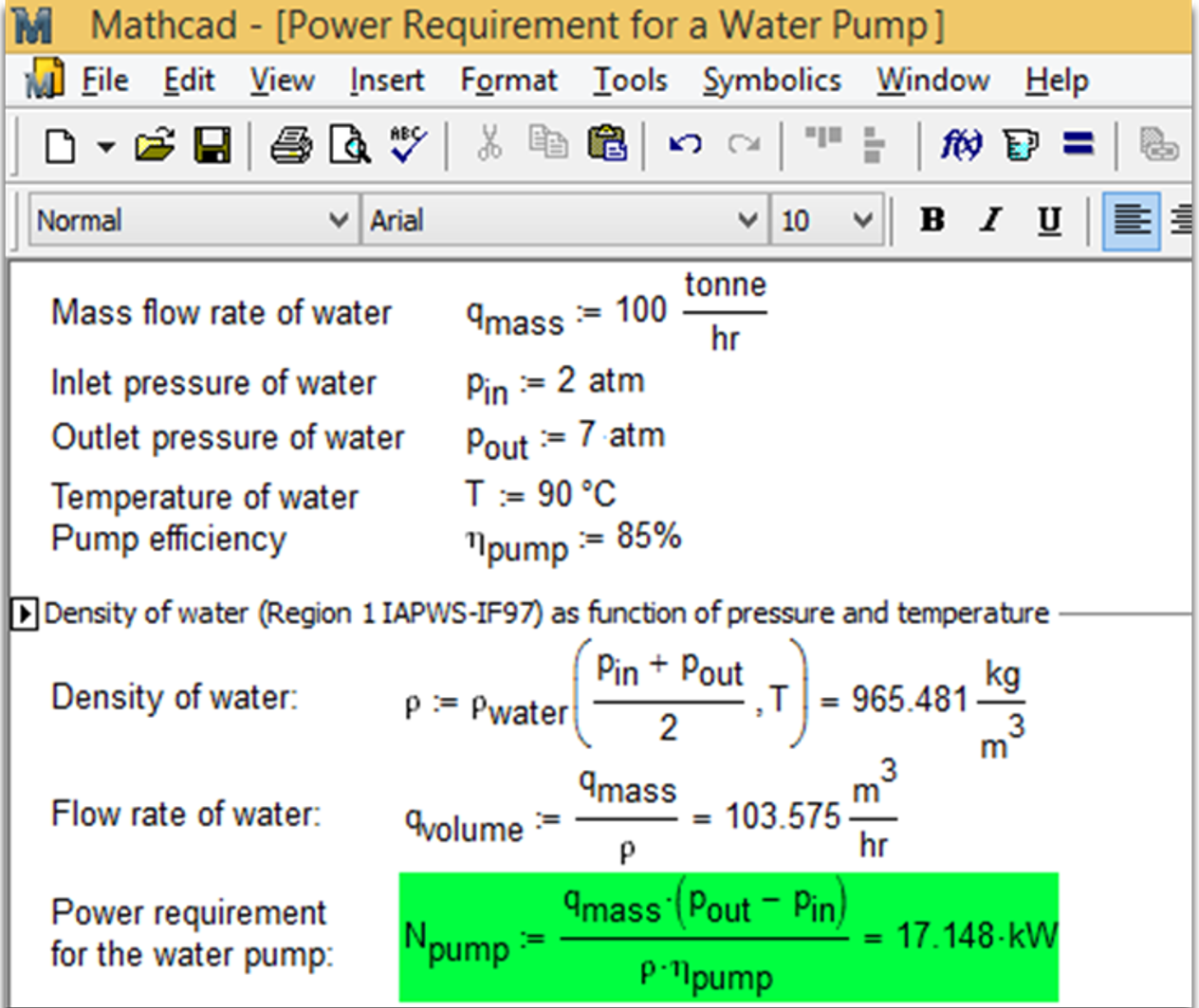

Fig. 5.2. Pump performance calculation

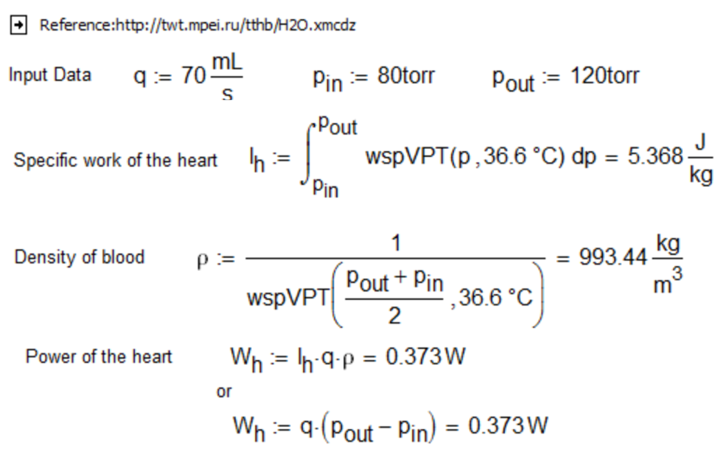

Fig. 5.3. Thermodynamic parameters of a human heart

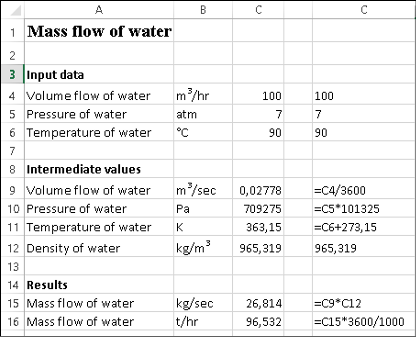

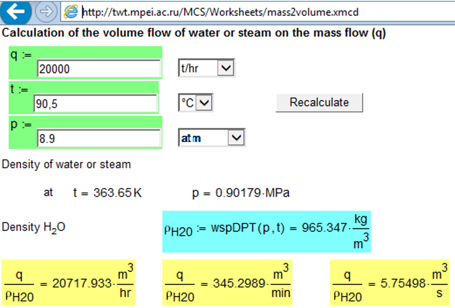

Fig. 5.4. Calculation of water mass flow in MS Excel (demonstration of calculated values and formulas used; work with connected WaterSteamPro package)

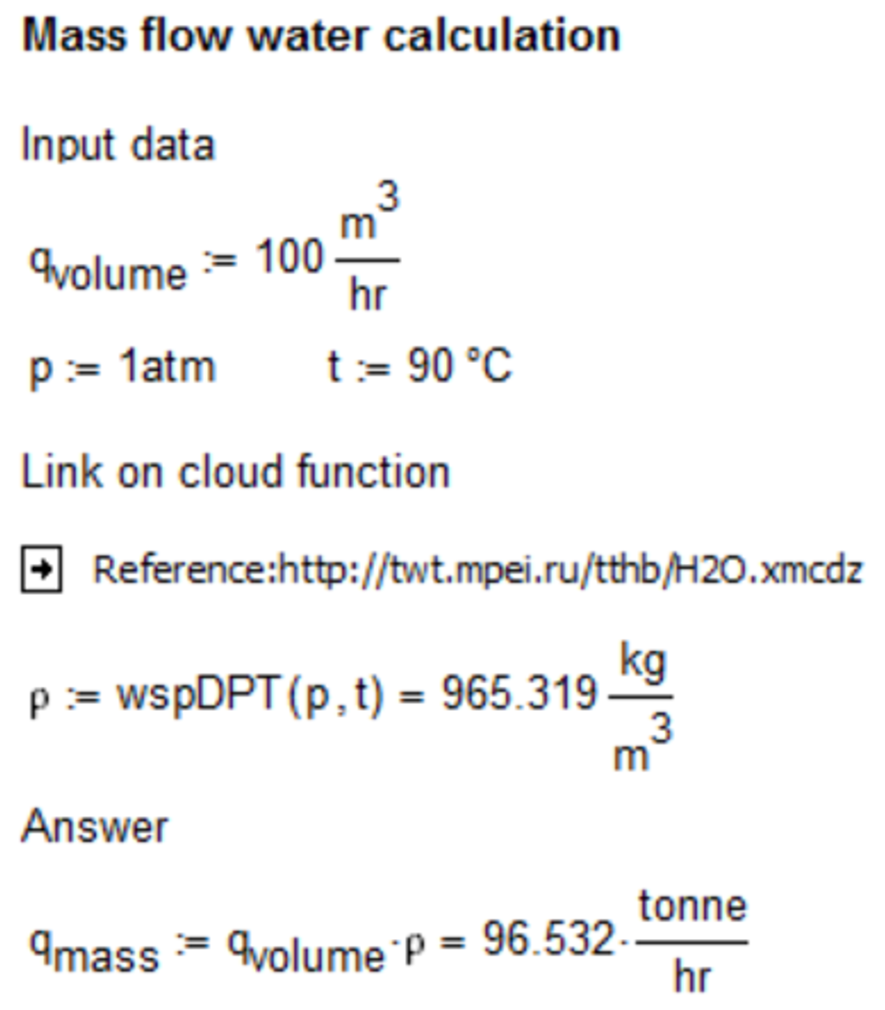

Fig. 5.5. Calculation of water flow rate in Mathcad: usage of a reference to a "cloud" function

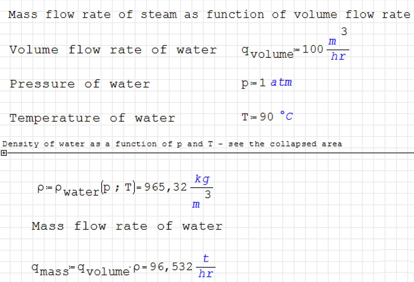

Fig. 5.6. Calculation of water mass flow rate in SMath: operation with a function in hidden area
Fig. 5.7. Network calculation of water flow rate (a task which is inverse to the ones shown in Figs. 5.4–5.6) - http://twt.mpei.ac.ru/MCS/Worksheets/mass2volume.xmcd

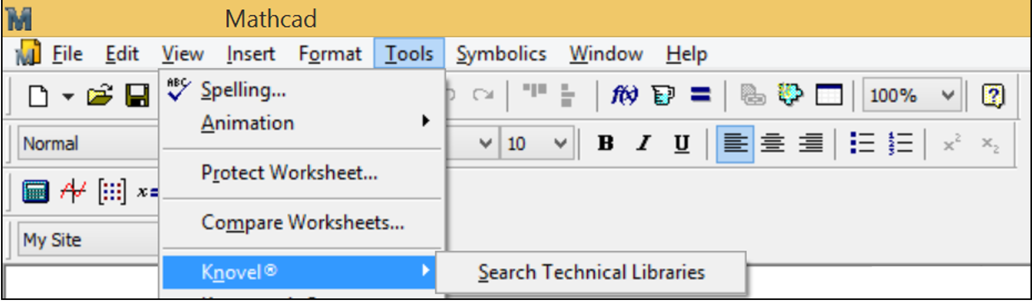

Fig. 5.8. Link to www.knovel.com from Mathcad 15

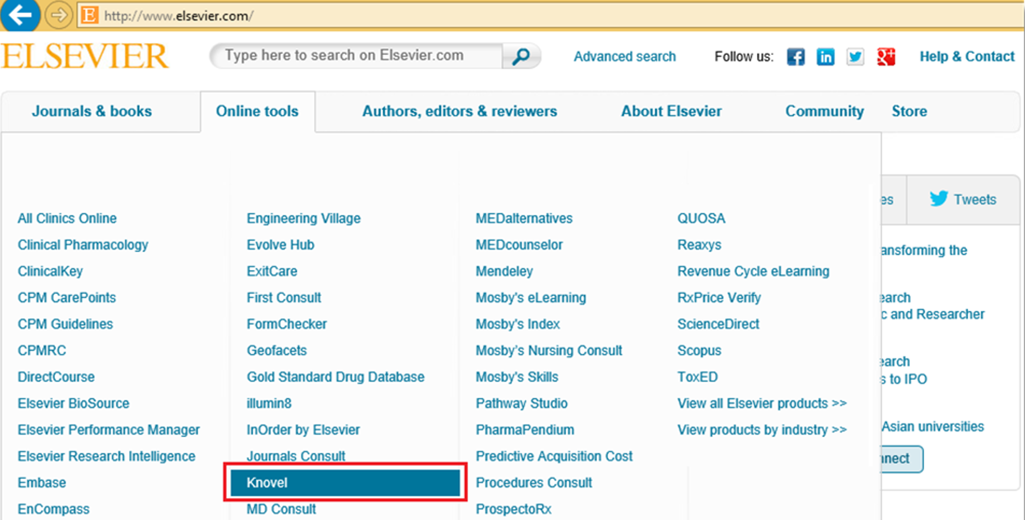

  Fig. 5.10. Home page of e-publishing house Elsevier with a list of online tools
Fig. 5.10a. New home page of e-publishing house Elsevier with an information about Knovel

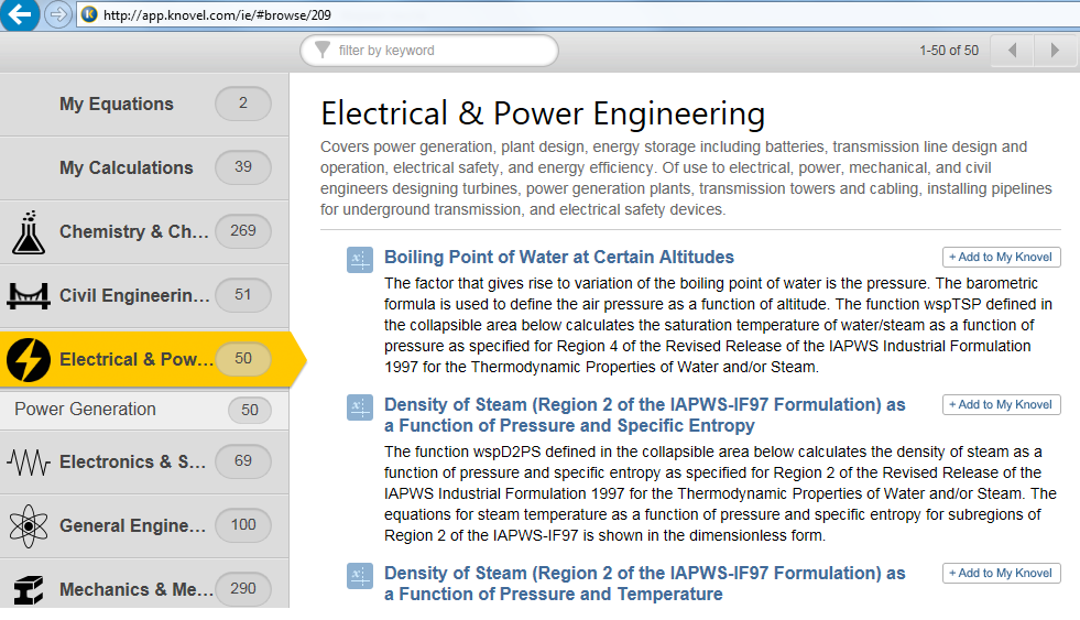

  Fig. 5.11. Interactive tools from Knovel

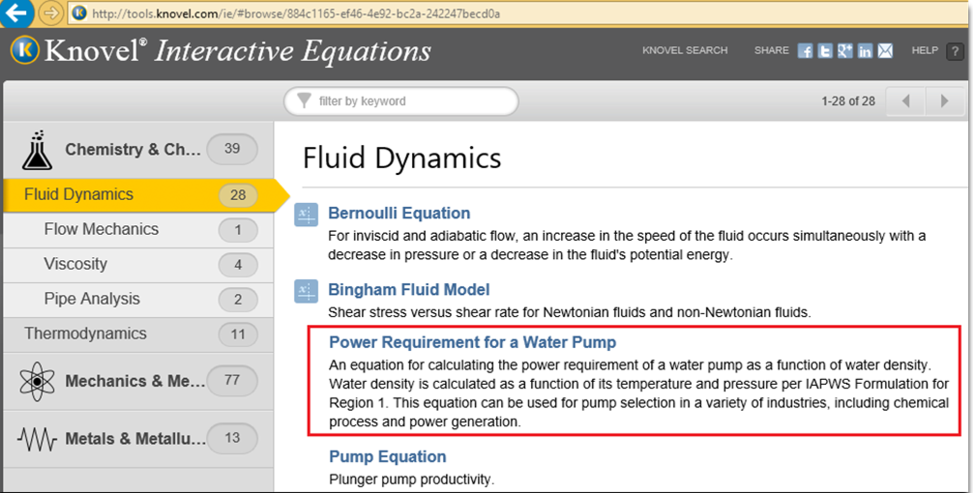

  Fig. 5.12. Home page of Knovel’s Interactive Equations
  Fig. 5.13. Reference to pump power calculation in Interactive Equations of Knovel

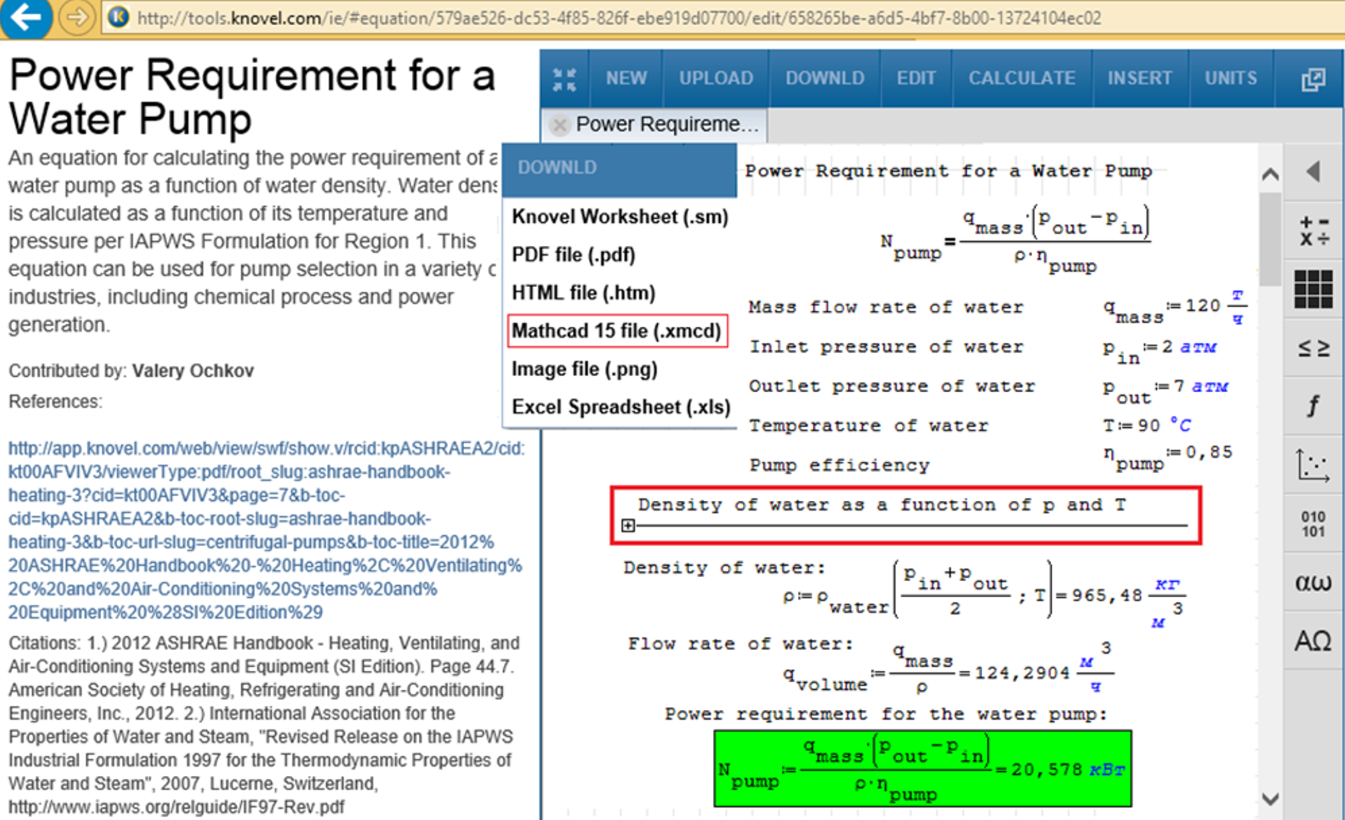

  Fig. 5.14. Interactive calculation of pump power at Knovel’s web-site

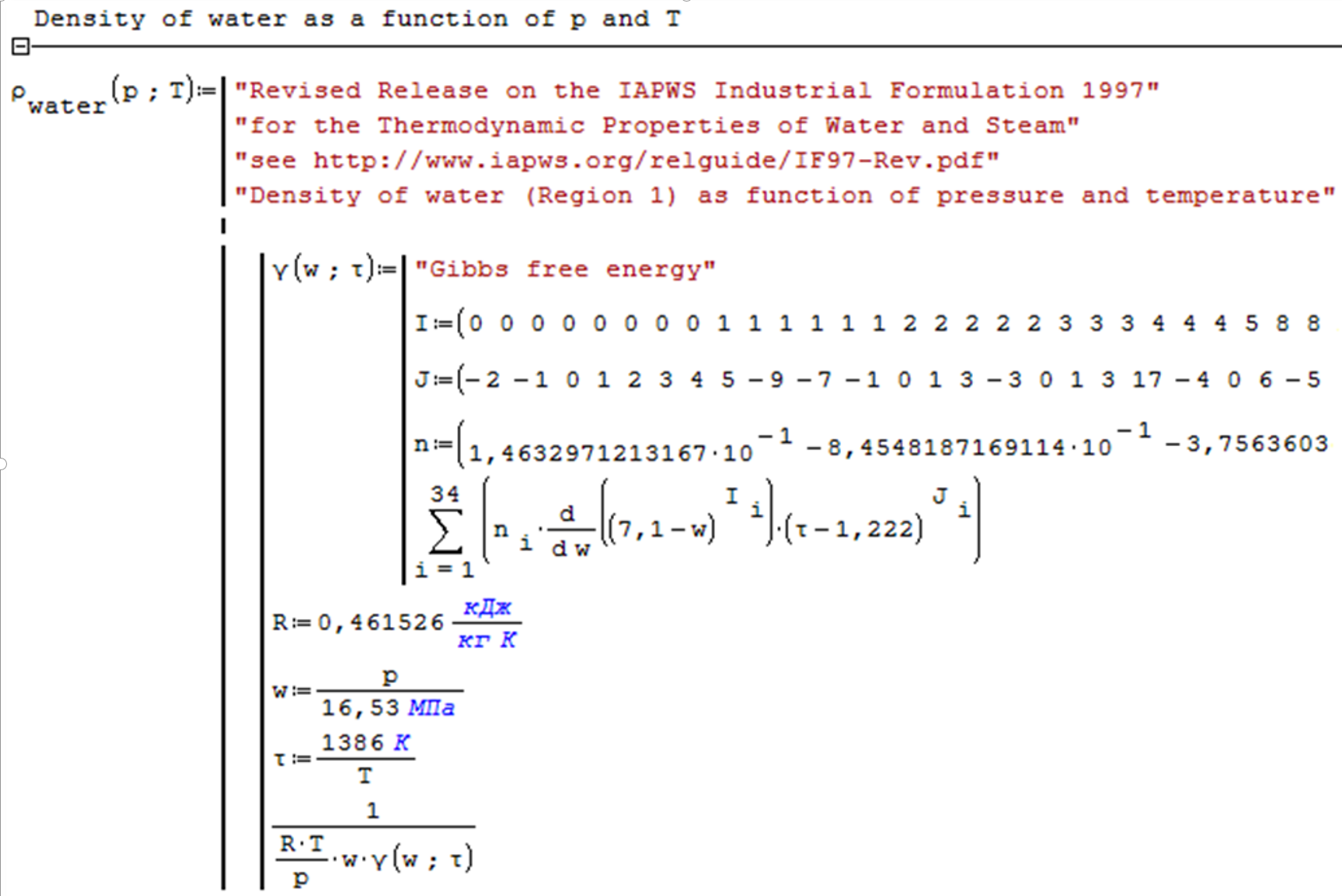

  Fig. 5.15. Function of Knovel’s Interactive Equations converting water density (a part of the function is shown)
  Fig. 5.16. Mathcad-calculation of pump power downloaded from Knovel’s Interactive Equations

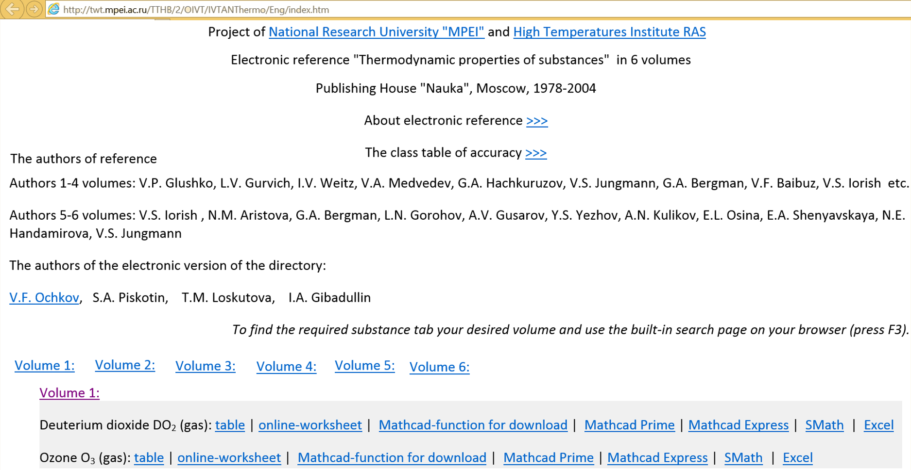

  Fig. 5.17. E-guide on thermal and physical properties of individual substances

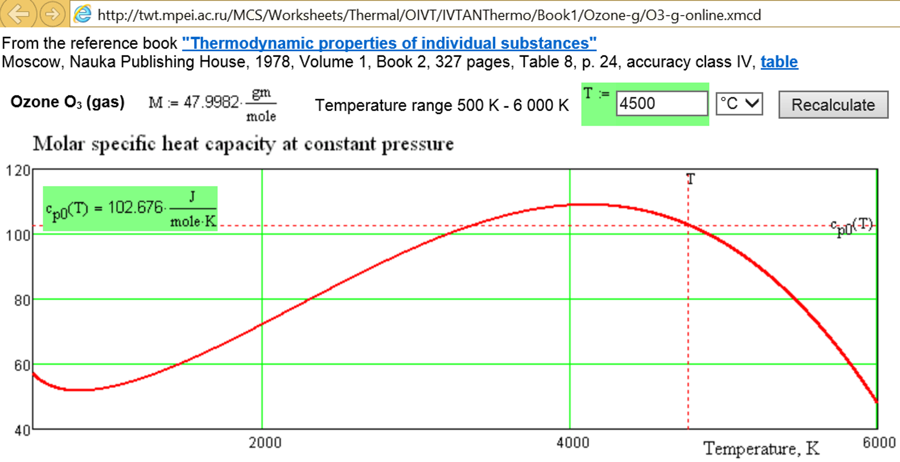

  Fig. 5.18. Interactive network calculation of specific heat capacity of gaseous ozone
