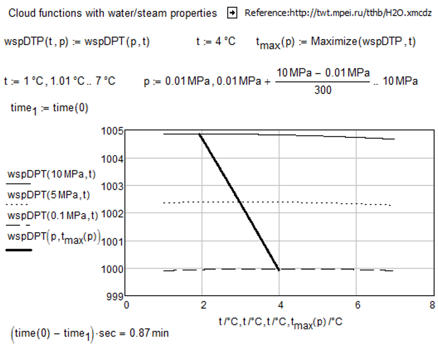

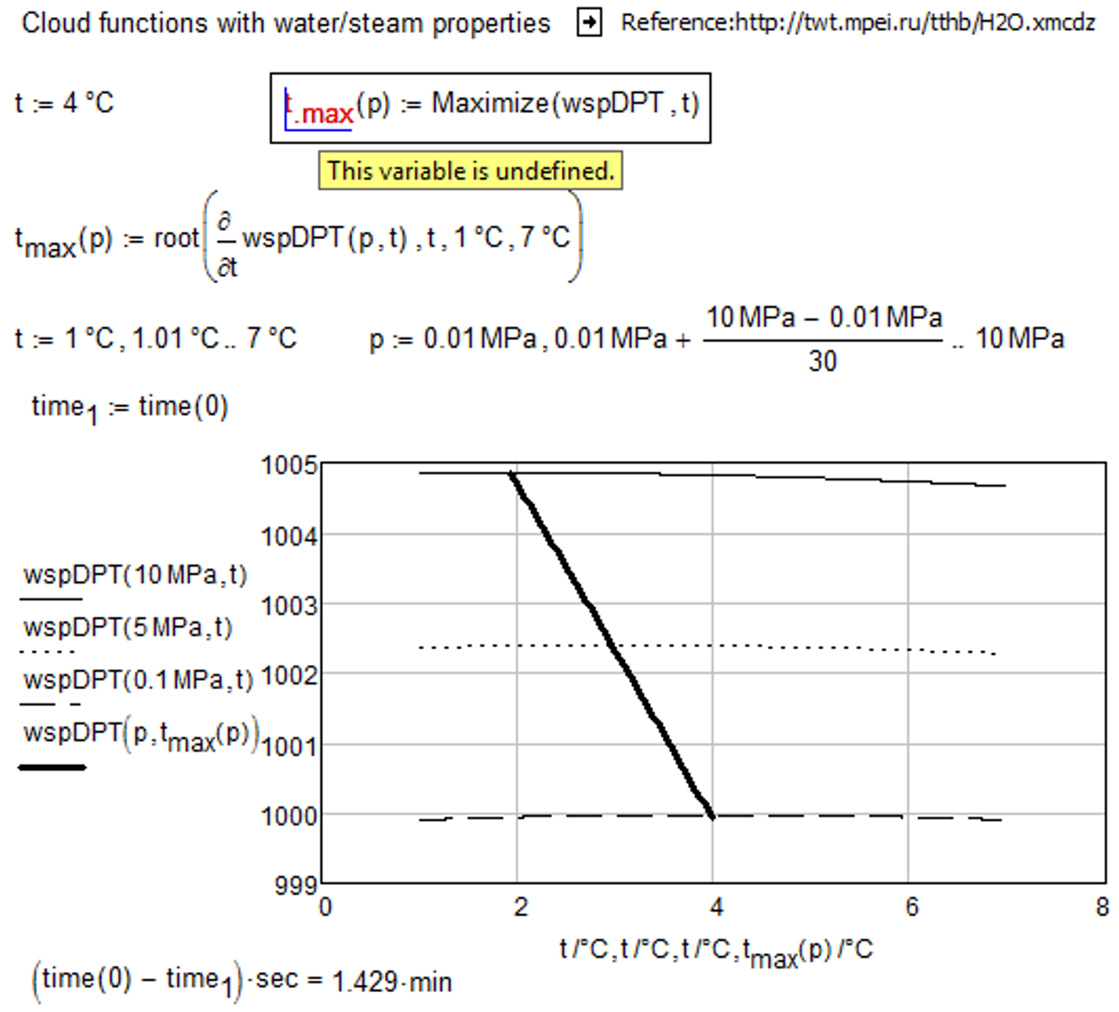

Fig. 8.1 Diagram of maximum density water temperature as a function of its pressure

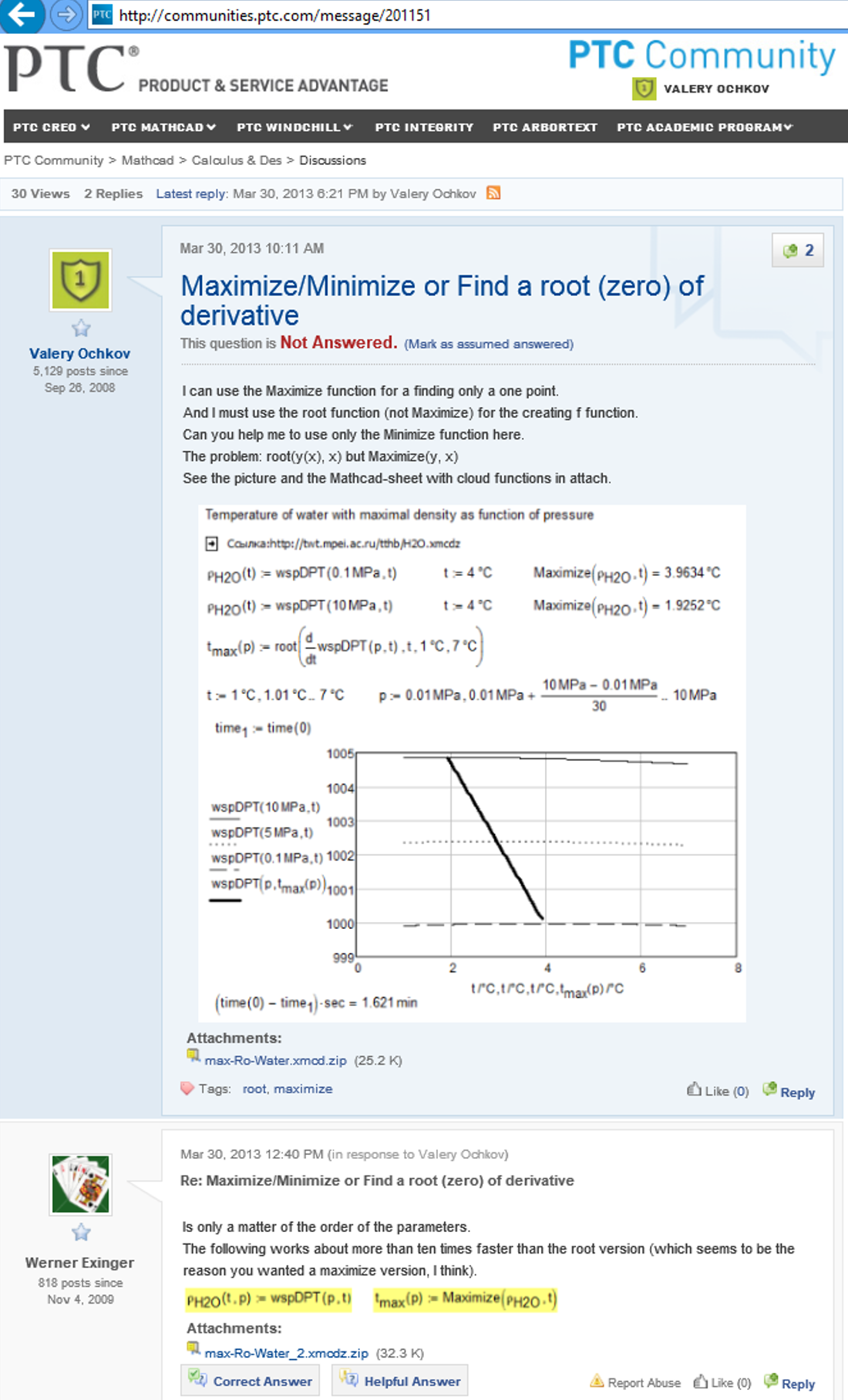

Fig. 8.2 Mathcad forum (Re: Maximize/Minimize or Find a root (zero) of derivative)
Fig. 8.3 Adjusted calculation of maximum density water temperature/ its pressure function

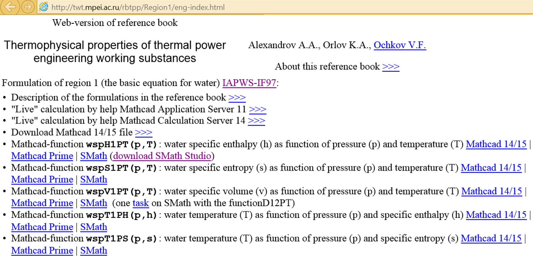

Fig. 8.4 Web-page of water properties reference book (Formulation of region 1 (the basic equation for water))

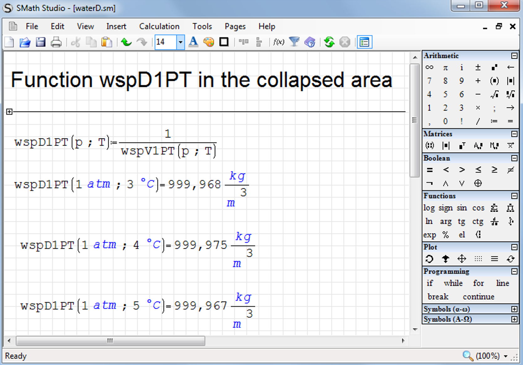

Fig. 8.5 Water density calculation in SMath

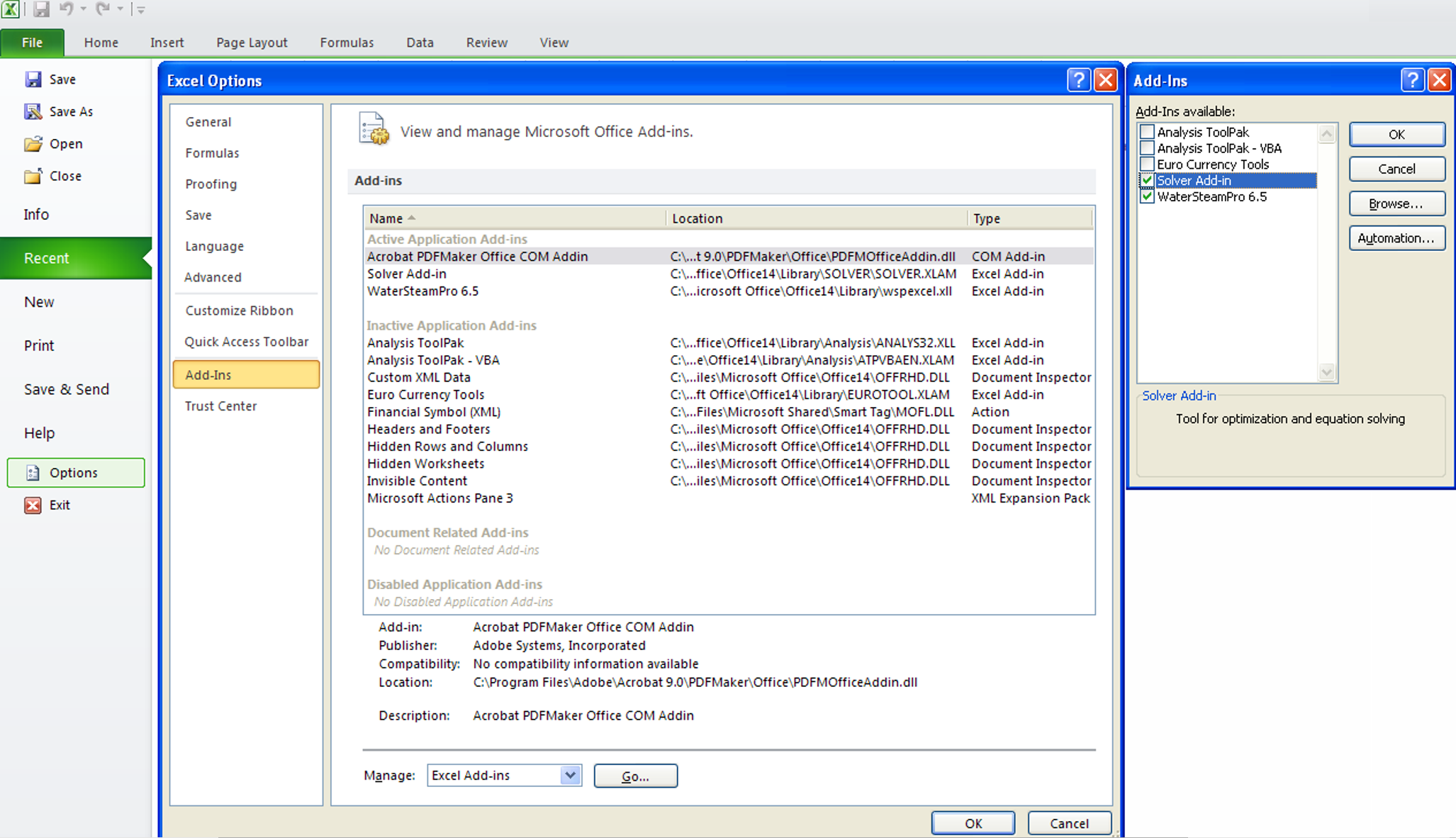

Fig. 8.6 List of MS Excel add-ins

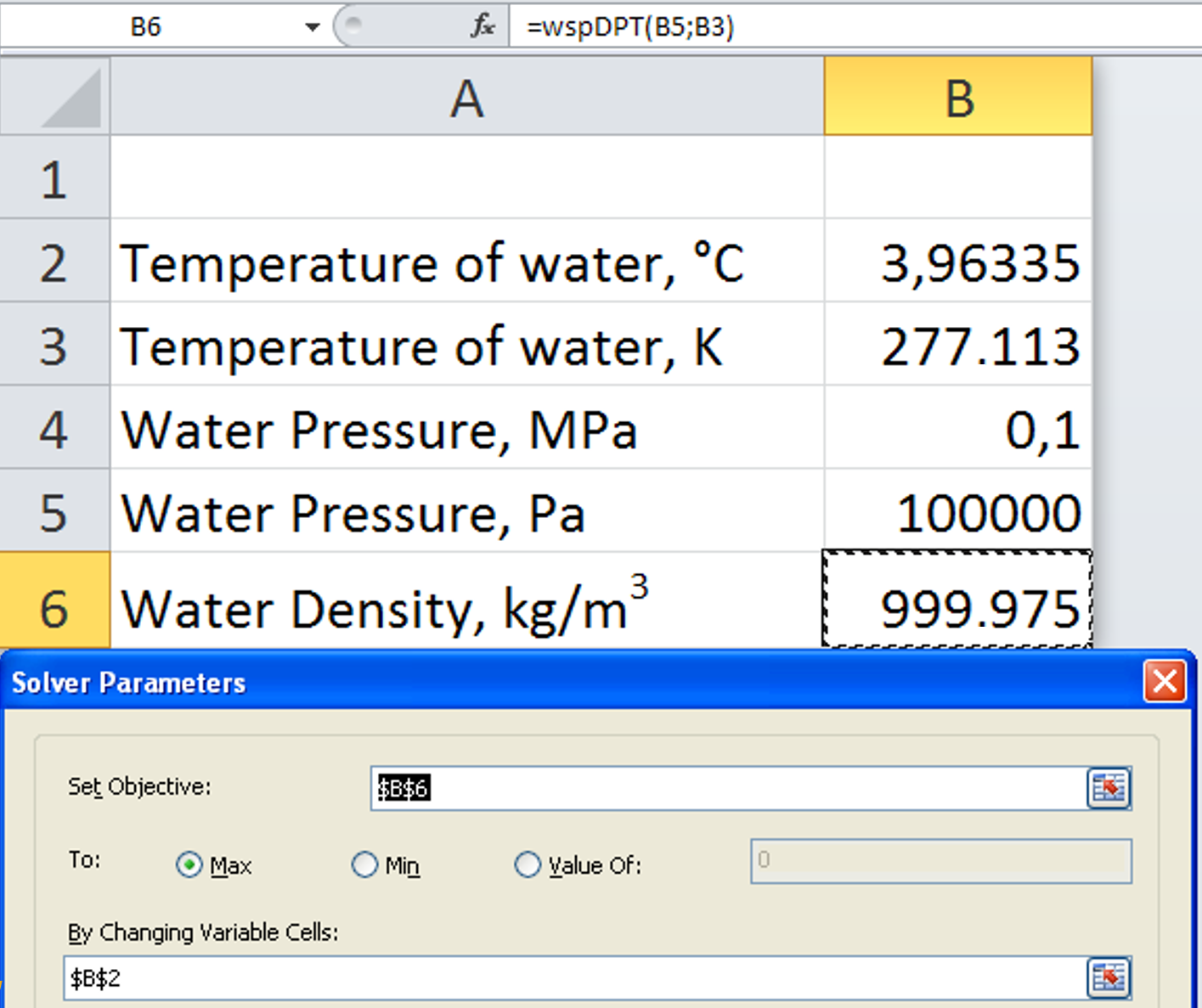

Fig. 8.7 Calculation of maximum density of water in MS Excel environment

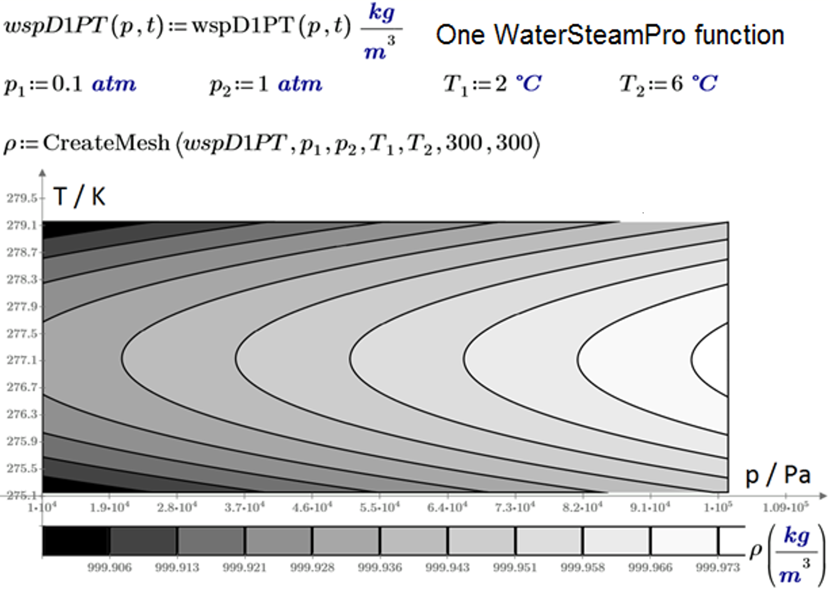

Fig. 8.8 Water density as a function of pressure and temperature: one level lines
