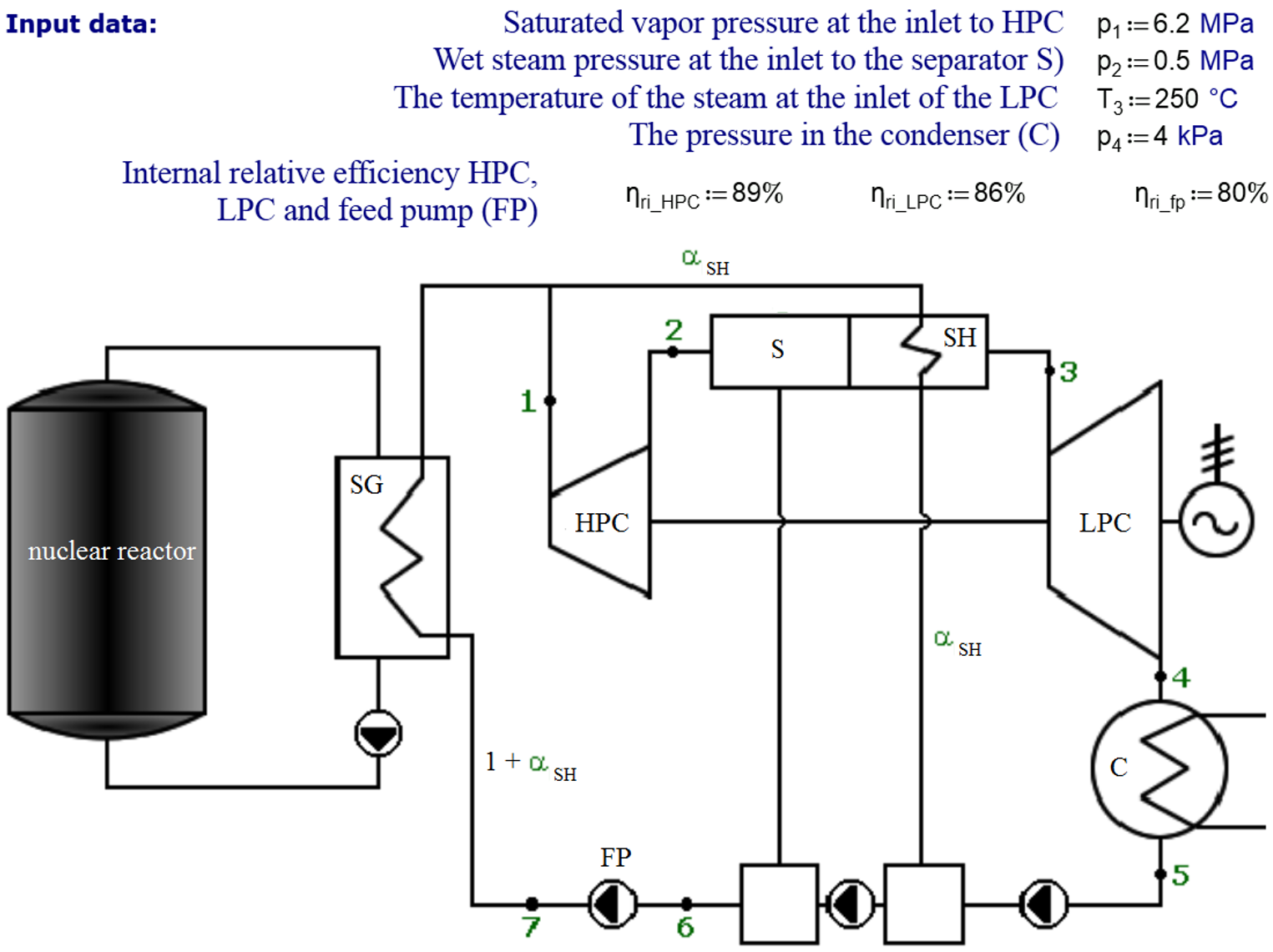

This study is about calculation of steam turbine cycle of nuclear power plant operating on wet steam. You can learn about authors Internet sites that help to solve thermal engineering tasks.

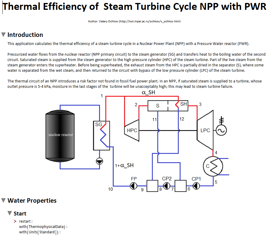

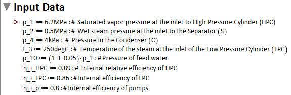

Fig. 9.1. Calculation of the thermal efficiency of the steam turbine power plant for wet steam:  Input data and the plant diagram

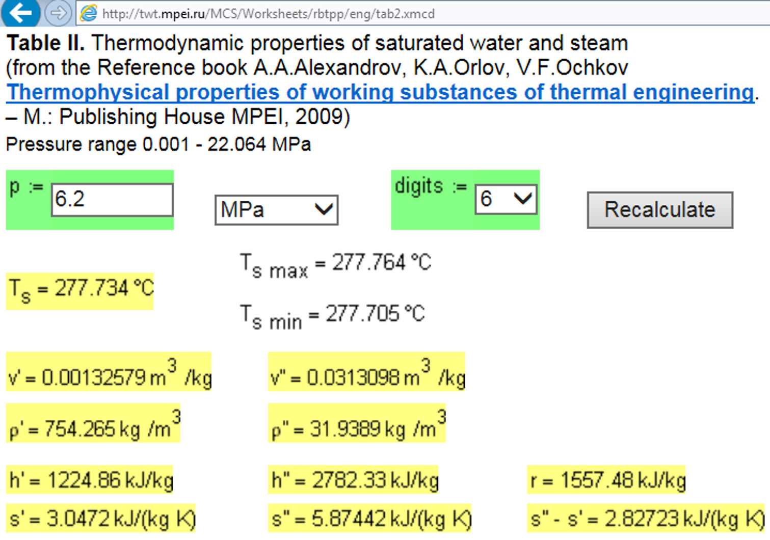

Fig. 9.2. Internet site to determine the water boiling point as function of pressure (http://twt.mpei.ru/MCS/Worksheets/rbtpp/eng/tab2.xmcd)

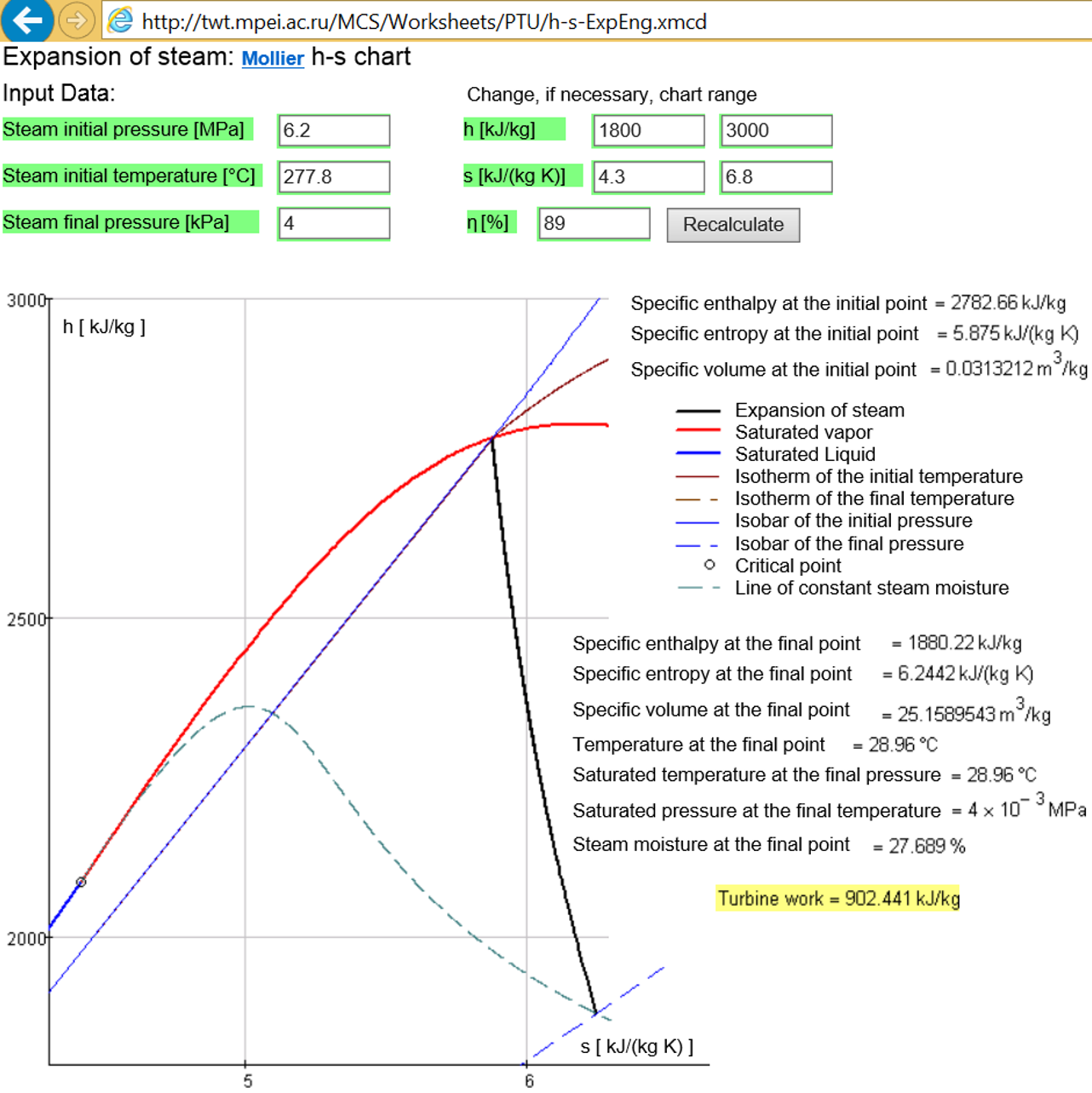

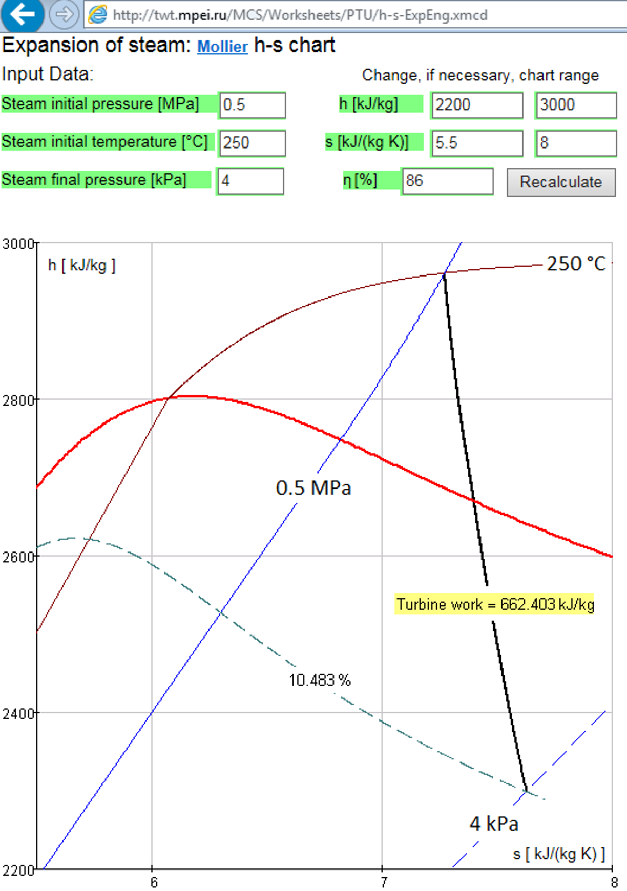

Fig. 9.3. Internet site for calculating the turbine steam expansion process (http://twt.mpei.ru/MCS/Worksheets/PTU/h-s-ExpEng.xmcd)

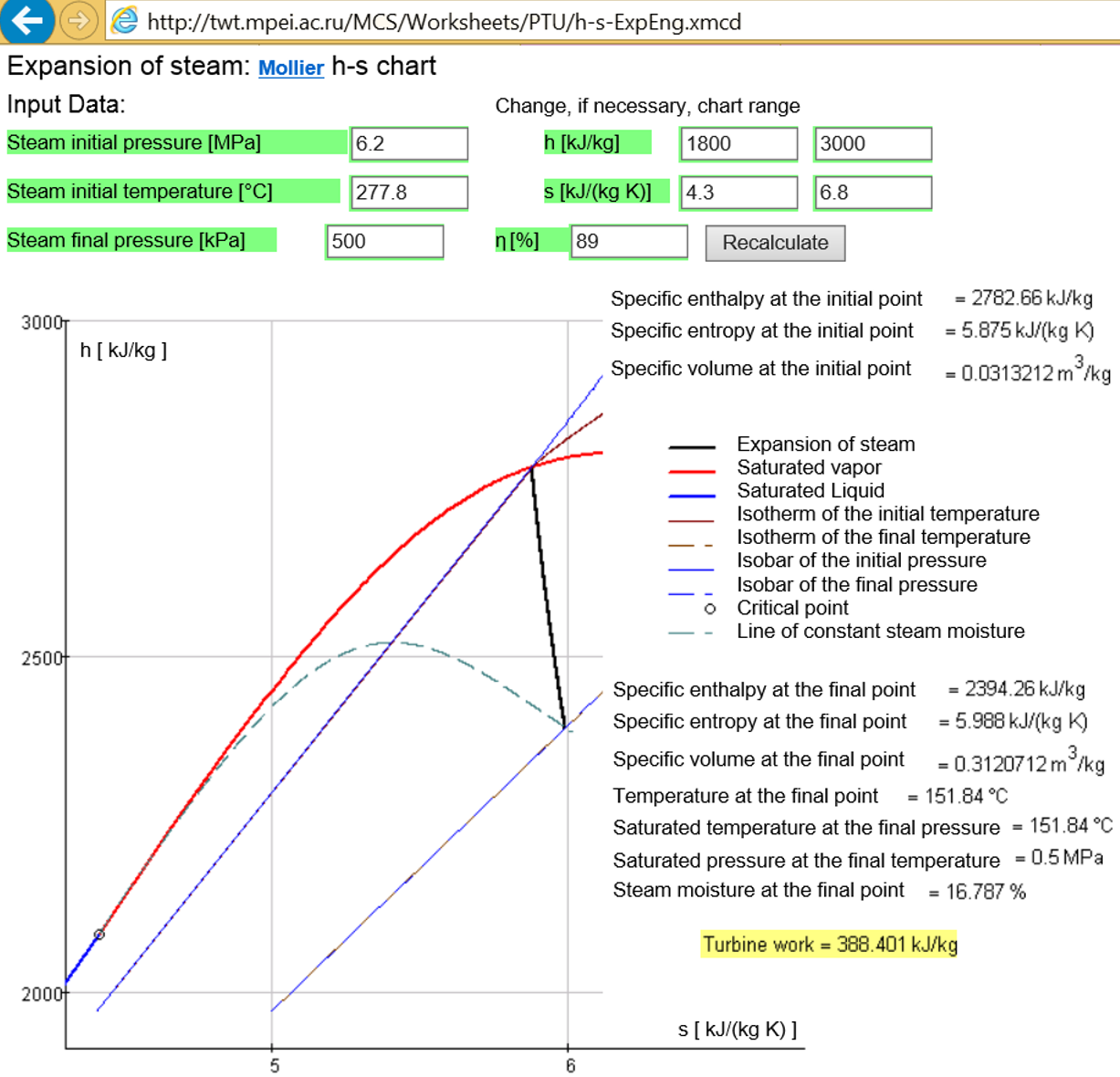

Fig. 9.4. Internet diagram of steam expansion process in HP cylinder of a nuclear steam turbine (http://twt.mpei.ru/MCS/Worksheets/PTU/h-s-ExpEng.xmcd)
Fig. 9.5. Internet diagram of steam expansion process in LP cylinder of a nuclear steam turbine (http://twt.mpei.ru/MCS/Worksheets/PTU/h-s-ExpEng.xmcd)

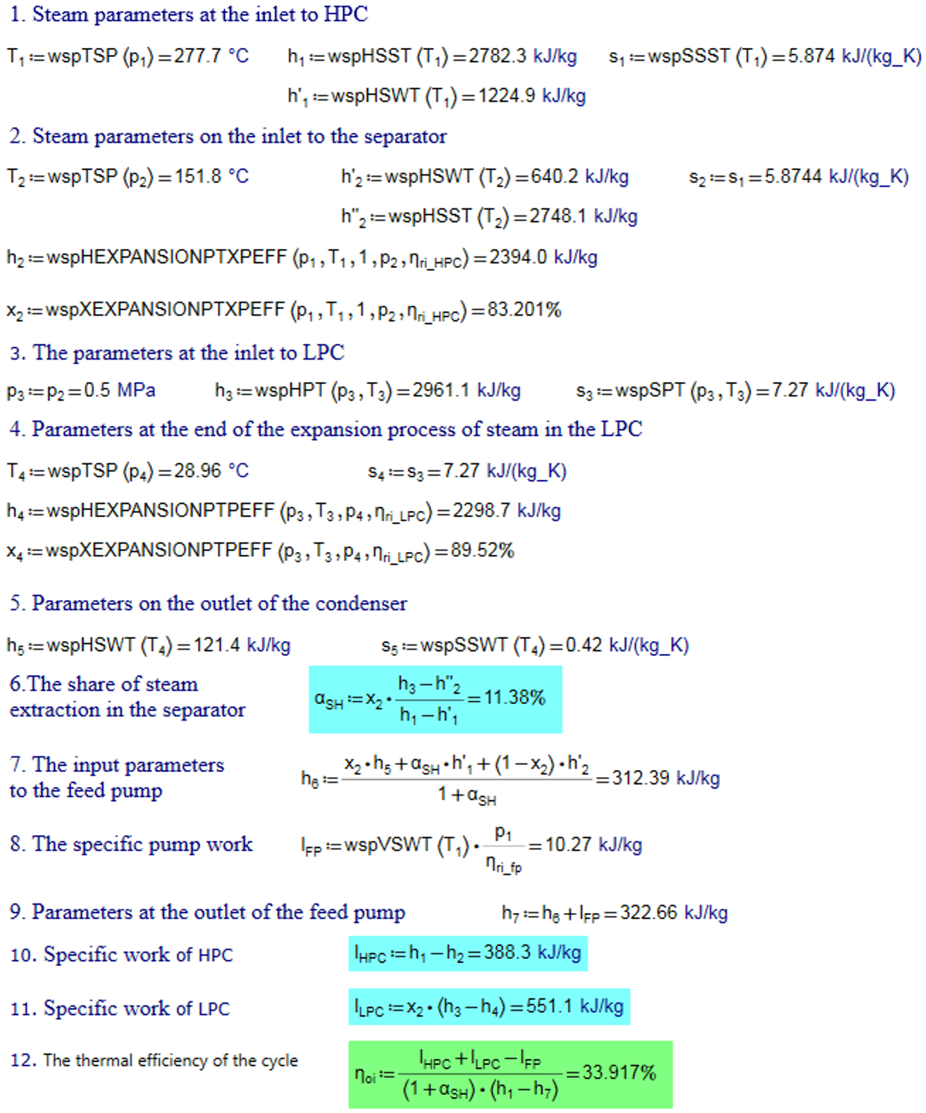

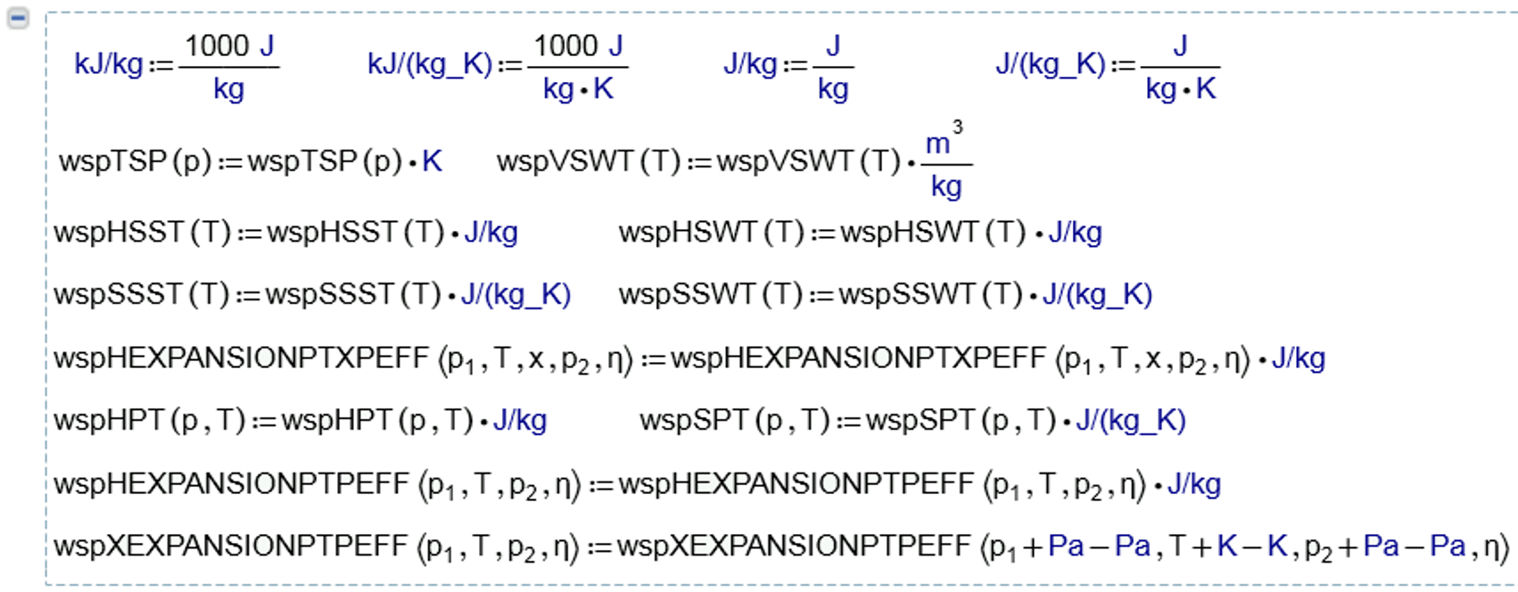

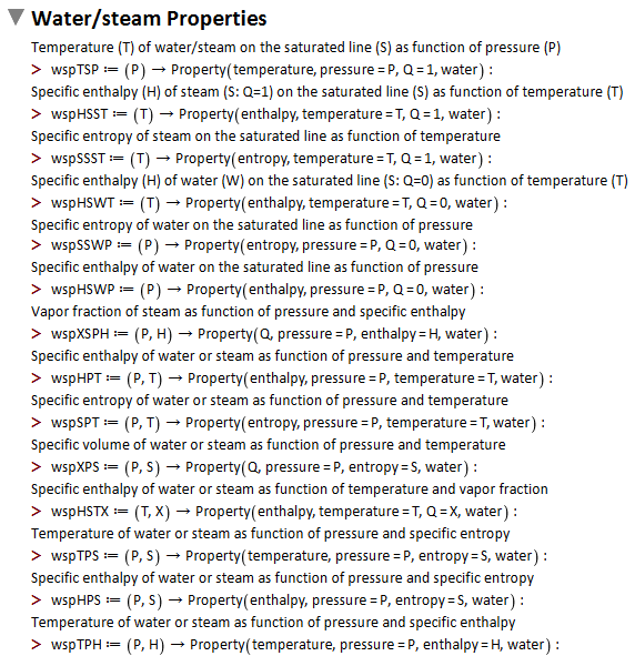

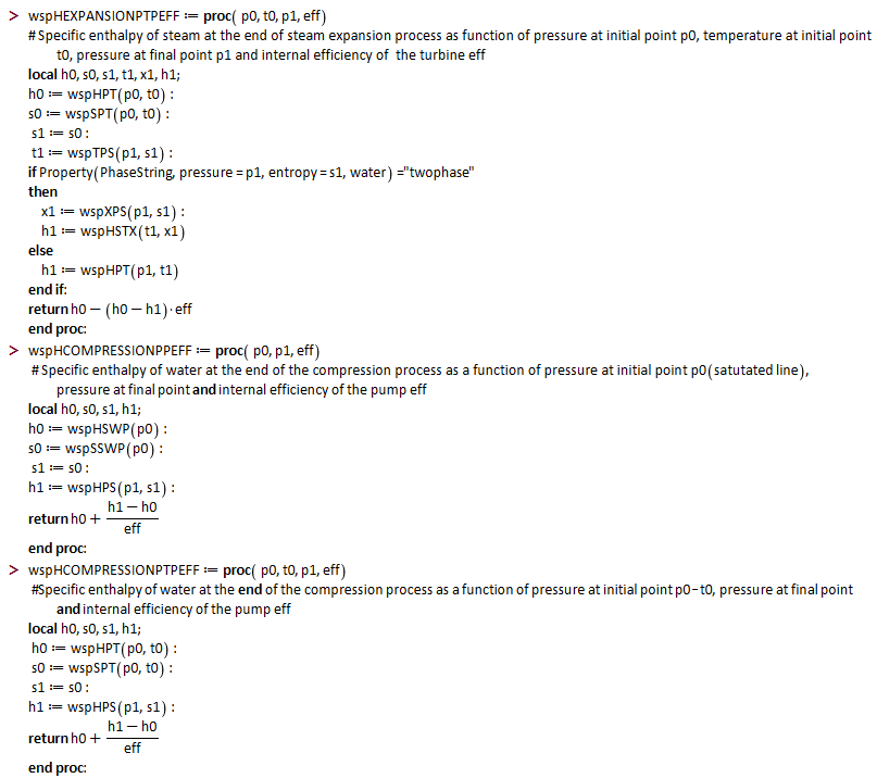

Fig. 9.6. Overwriting of WaterSteamPro functions into dimensional functions in Mathcad Prime 3

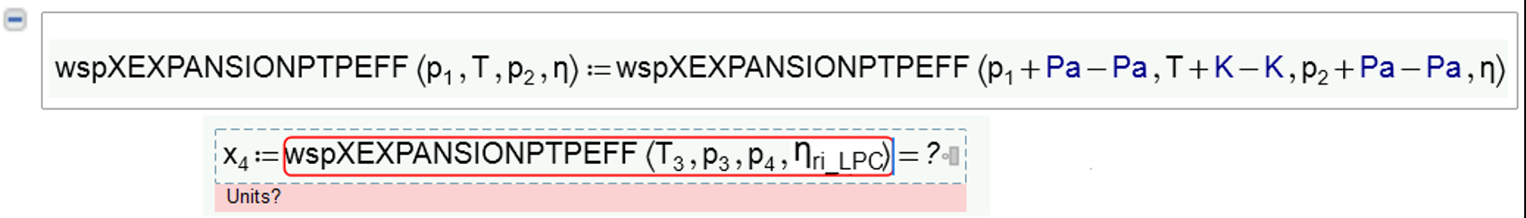

Fig. 9.7. Control of dimensions of WaterSteamPro function arguments

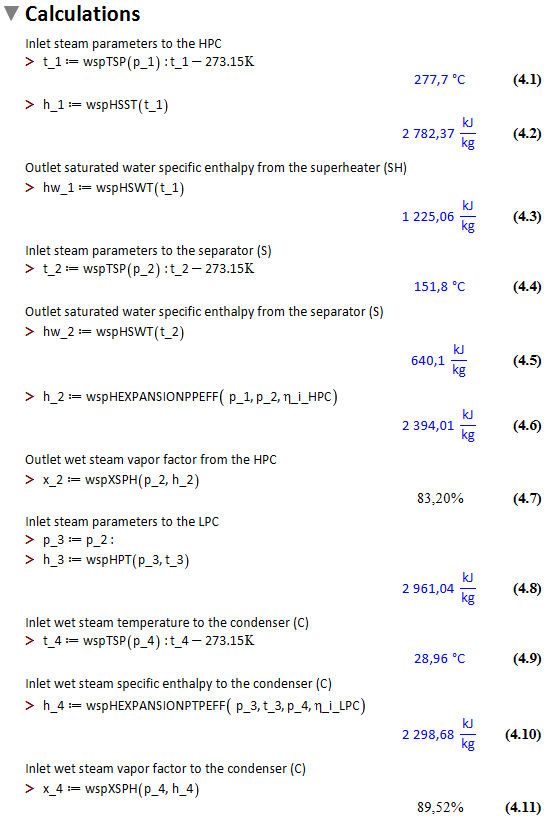

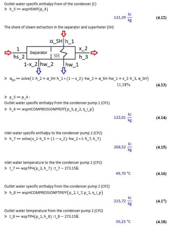

Fig. 9.8. Calculation of thermal efficiency of steam turbine cycle of VVER NPP (The Mathcad Prime 3 sheet in attach)

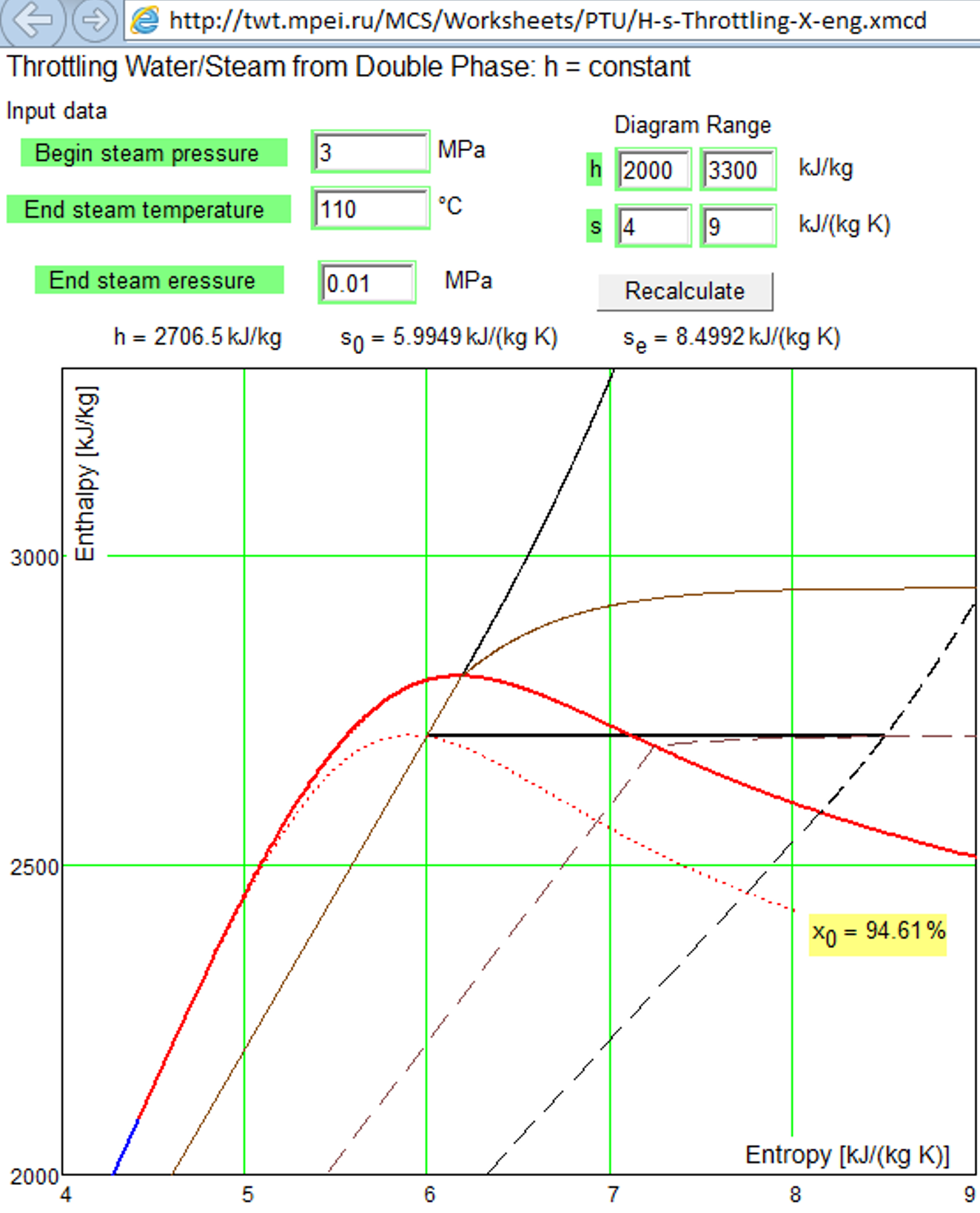

Fig. 9.9. Internet computation of steam moisture throttling process (http://twt.mpei.ru/MCS/Worksheets/PTU/H-s-Throttling-X-Eng.xmcd)

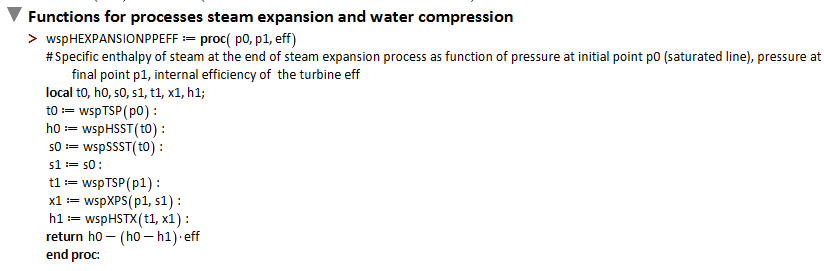

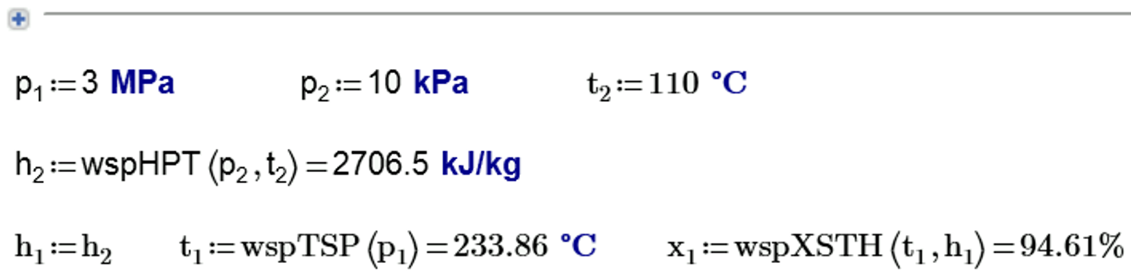

Fig. 9.10. Calculation of steam moisture in Mathcad Prime 3

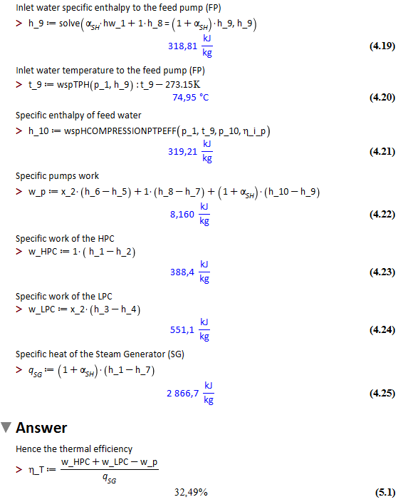

Same calculation with Maple 2016
http://www.maplesoft.com/applications/view.aspx?SID=154033
