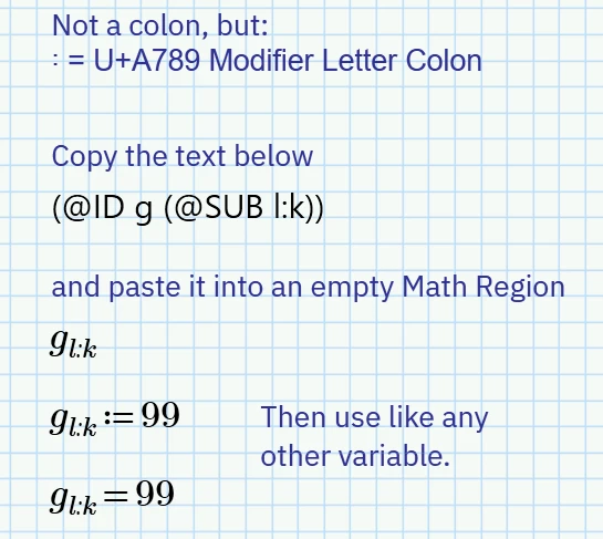

Is it possible to use colan (:) symbol in literal subscripts for defining variable in Mathcad Prime directly ?
23-Emerald V
May 5, 2022
Not directly, as far as I'm aware.  I've tried a few workarounds, such as using a Unicode subscript colon, but there isn't a subscript colon.   However, one possible workaround uses a variant of the colon character.
The text string is: (@ID g (@SUB l꞉k))
Modify it as needed.
Stuart

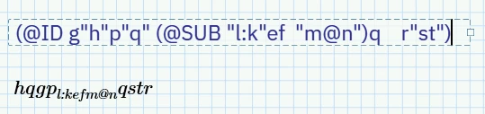

May 5, 2022
You can use the usual colon character if you put the subscript text into double quotes
A somewhat startling observation: If only part of the subscript text is set in double quotes, the order is changed
23-Emerald V
May 5, 2022
Interesting. It further seems to strip spaces outside of quotes and possibly use the space as some form of grouping break.
