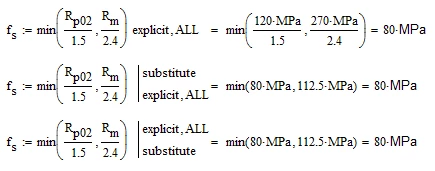

I have this issue with the substitute function when in conjunction with Explicit. It doesn't display all components of an equation no matter what I do; see attached sheet. Any suggestions?

The problem is the substitute command per se.
This command seems to immediately evaluate the expression and unfortunately the order does not matter

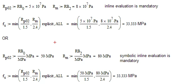

So I guess you'll have to do without "substitute" and use clumsy assignments on worksheet level like this:

Hello Werner,
it seems you're right and I have to use the not very elegant method of re-assigning variables in a hidden area 😞
