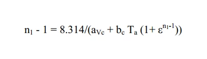

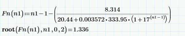

successive approximations
how to solve this equation to define n1 by using successive approximations in mathcad
[1.34 .. 1.42]
a=20.44
b=0.003572
ε=17
Ta=333.95
n1 - 1 = 8.314/(a+ b*Ta (1+ ε^(n1-1)))
23-Emerald I
December 15, 2018
[1.34 .. 1.42]
a=20.44
b=0.003572
ε=17
Ta=333.95

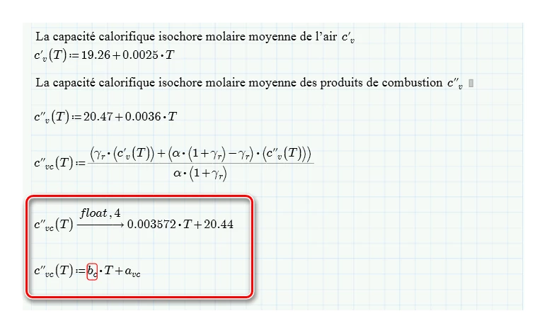

thank you.
how to matching this two equations for define a and b
c(t):=2.47+0.0036t
c(t):=a+bt
