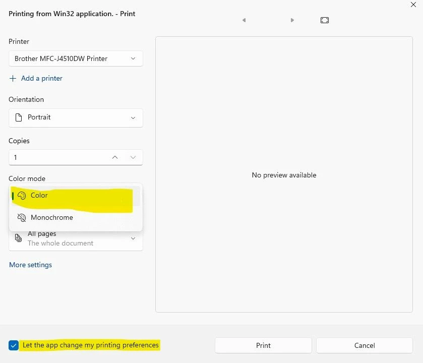

Hi John,
Have several printers on my system and when printing from Prime get the following dialog box irrespective of what printer is selected.
Pick the color option.
Pick the let app change printing preferences.
Cheers
Terry
