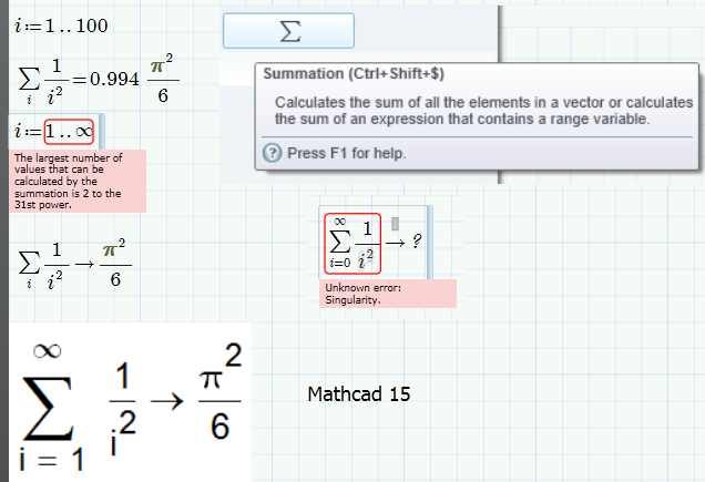

Sum in Mathcad Prime 2.0
I do not see old Mathcad 15 operator im Mathcad Prime 2.0 - sum(i=1 to 20, f(i))
June 15, 2012
You started your Prime sum at zero, your M15 sum at 1. Prime also works when starting from 1:
Alan
June 15, 2012
Alan
June 15, 2012
Thanks, Alan - it was my error!
