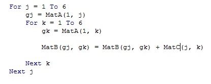

I am trying to sum of array elements. can someone help me to do this.
the attached picture is extracted from vba.
Do you mean something like this?

Yes,but the problem that mathcad gove me error becuase it can't recognize matB when adding to mat c

Did you run the attached worksheet?  I've just run it again for various values of matrix size and it seems to work on my M15.
I notice that in your original post, you give the variable names as MatA, MatB & MatC, whereas you mention matB & matC above - Mathcad variable names are case sensitive, so you need to ensure that all variables are spelled consistently.  You also need to have defined all of the variables before you can use them.

I'm not sure how this code makes any sense.
But it works if all three matrices already exist.

CAN YOU PLEASE SEE THIS CODE?@
