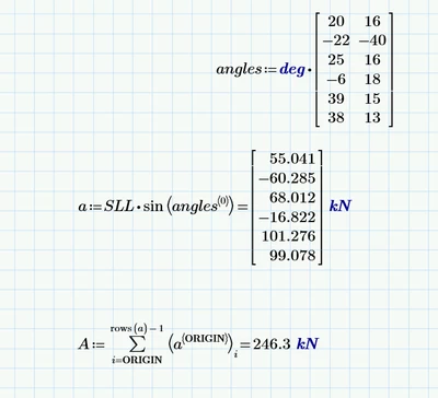

I have created a vector that has both positive and negative values.
I would like to sum all the positive values, return the number, and then separately sum the negative numbers and return the number.
Is this possible?

Preferrably you should attach your Prime worksheet AND state which version of Prime you are using.
Apart from that, how about this...
Attached is a Prime 4 file, with the advice from @Werner_E (see below).

LucMeekes23-Emerald IVAnswer
November 19, 2021

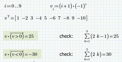

November 19, 2021
You don't even need the summation operator
November 19, 2021
Hmm...
gives:
I think I prefer to have it in.
Or...
Now it works:
