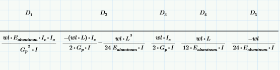

You define a dimension D at the top of the sheet, so your table doesn't define. Change the name in your table (and keep your vector indices straight, and all works out!)

I did not notice that I defined D twice, Now my spreadsheet are working right. Thank you.
