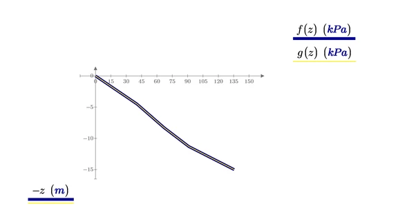

Hi

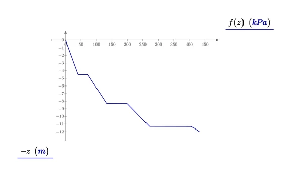

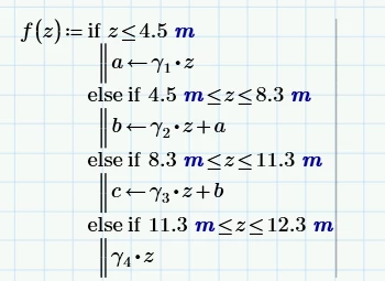

I want to create a loop that for the next interval add the results in the previous interval etc. I have made an attempt in the following program, but something is wrong. Any help is appreciated.
Werner_EAnswer

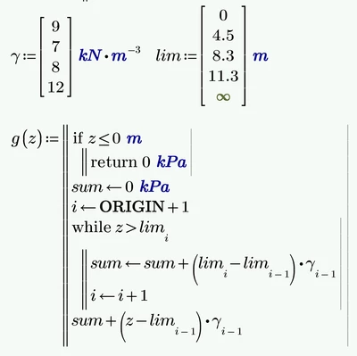

Or you may use a more generic approach

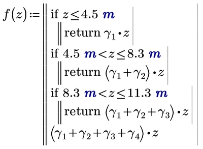

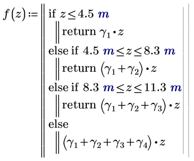

Maybe this is what you are looking for:
Because a "return" statement stops a program from running any further, you can also write
Prime 9 file attached

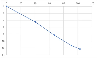

Not really, I want the diagram to look like this (Excel).
Sep 8, 2023 1:42 PM UTC
f(0) = 0
f(4,5) = 0 + 4,5x9 = 40,5
f(8,3) = f(4,5) + (8,3 - 4,5) x 7 = 67,1
f(11,3) = f(8,3) + (11,3 - 8,3) x 8 = 91,1        etc...
Hopefully you understand what I'm looking for 🙂

Werner's formula is precise and well done!
But this is really a simple integration,  Attached Prime 4 Express.
(Extension to the second problem, above the water) will require definition of sign conventions.
Sep 11, 2023 6:33 PM UTC
😉 Its only simple once you found a way to automatically choose the correct gamma-value for every depth, like you did with
