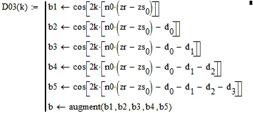

Could anyone help me with writing a program to generalize the attached calculation?

How about the attached?
I have added a value to d to ensure the function works.

Please upload the worksheet. I am sure you will be able to iterate through vector d.

Here is the worksheet.
