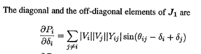

Hello everyone,
Im trying to construct a matrix in Mathcad Prime 4.0 for a Newton-Raphson power flow solution, but im having trouble defining the elements where a summation with j≠i is needed.
Is there any way to handle this in MathCad?
Thanks in advance
