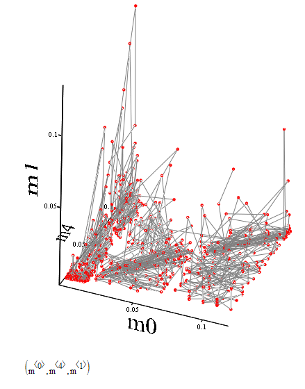

Could you please help me with the attached graph? The surface graph shows much higher values for the parameter on z-axis.

The problem is that you want to plot a surface but you don't have surface data!
All you have is a bunch of more than thousend points in 3D. You can plot those points chosing scatter plot and maybe connect the points in the order the points are in the vectors you provide. But you dont have a mesh structure which would enable mathcad to plot a surface through those points.
I don't know why Mathcad does not return an error message when you try to do a surface plot with simple point data but it doesn't. Instead it tries to create a surface by some sort of interpolation. i have no idea what it tries and how, but this seems to be the reason for the high z-values you noticed.
using a scatter plot will give you the correct z-values, but no surface.
Unfortunately Mathcad does not provide any 3D surface fitting or regression methods, so unless you are able to rearrange your data to form a mesh you will have to program that kind of routines on your own.
You also search this forum for buzzwords like "surface fit" - maybe someone had already posted a routine you could use.
Here is what the scatter plot of your data looks like:
Because you can plot a surface using x, y, and z vectors. As you say, it uses some form of interpolation, which does not always work so well even if the data is on an evenly spaced grid. The plot is more reliable if the x, y, z vectors are converted to X, Y, Z matrices.

Nov 26, 2014 12:44 AM UTC
The few times I tried it never produced anything of use. I can't remember that I ever found any documentation describing what kind of interpolation Mathcad applies if asked to do a surface plot with three vectors.
This would only be possible if the data is on an evenly spaced grid (which is not the case here), right?
Fitting a surface to 3D data is simple enough using minerr, but this data does not look like a surface that could be fitted with a function with any reasonable number of parameters.
Correct, I had tried a polynomial of sixth order with 49 parameters and the result wasn't even close to useable.
