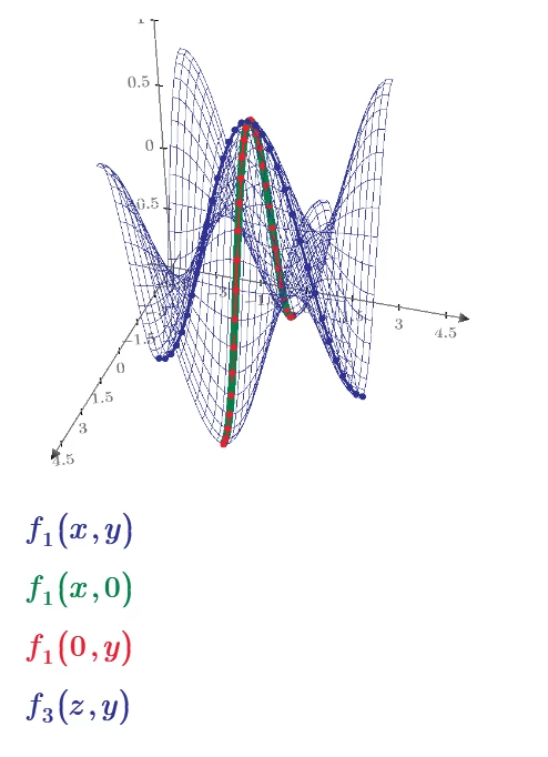

I want to use two variable version for a surface plot for a single variable data fit by setting the another variable to zero how to achieve this? Can someone share an sample example

Can you give some examples of what you are looking for?

Will this option do both a line (poly) evaluation and a surface (poly) evaluation?
