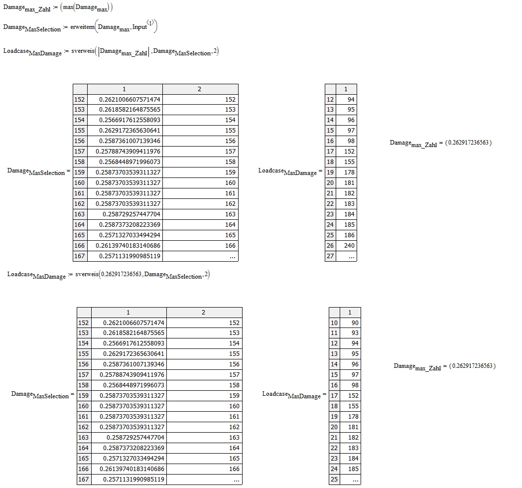

Hallo,
i have a special problem. My sverweis function is not working properly. Sverweis gives more results than realy exists it should only be 2 results. 152 is no valid result. I added a Paint Picture of my special problem.
I need to know the loadcase of the maximum damage (<1 for each)
Thank you,
BR Stefan

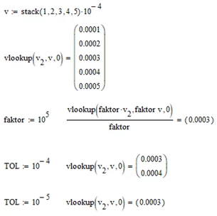

> Il try your suggests and will see if that works.
It should - see the screenshot of an example in my reply above.
> What are the lowest TOL and CTOL values?
Mathcad uses IEEE format for storing it numbers which usually is good for a precision up to 15 or 16 decimals. So obviously it does not make much sense to set values lower than 10^-15.
Setting TOL (CTOL does not affect the precision in your case) may influence other calculations in your sheet (a numerical integral or a solve block may fail to converge if TOL or CTOL is too low). So you will have to balance the value of TOL in a way your sheet is still working OK.
The variant with the faktor may be a better alternative even though it means more typing and worse readability.

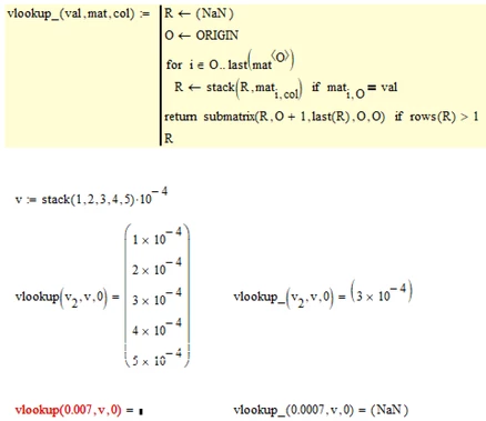

I'd prefer to write my own match or vlookup routines like this:

You experience a simple effect of bad precision. Match and the various lookup command only look within a certain precision and nor for an exact match. You may try if setting TOL to a lower value than the default 10^-3 would help but otherwise I guess there is no solution other than to write your own lookup routines.
One additional idea: You may try to replace sverweis(a,b,2) by something like sverweis(10^8*a, 10^8*b, 2) and see if it helps.
Here are examples of those workarounds:
January 31, 2019
I dotn understand why is there a workaround required im searching the same value out of a matrix which contains that same value? Why are there coming wrong values? Im still confused. So does sverweis only consider the first 3 digits after the comma for comparison? What is the TOL value? Where do i change that value?
why are there different values for that TOL numbers?
Hmm ill set the TOL value to the lowest possible number. What is the lowest TOL Number.
Theres also a CTOL. Hmm will use the lowest available numbers and see if that does help.
Thats wired:
