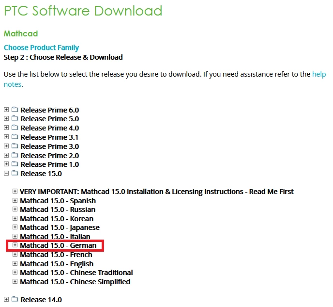

I guess you have to download german installation package from https://support.ptc.com/appserver/auth/it/esd/product.jsp?prodFamily=MCD page.
hkatgert8-GravelAuthor

I did download German, but no luck.

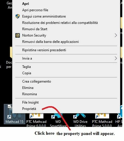

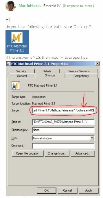

I had the same problem in 2016. Thanks to M. Hanak's suggestion, everything went OK and M15 is also fine. See below: (instead of "culture:en-US", you should write: "culture:de-GE"

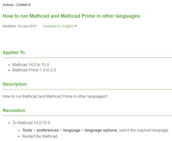

All,
I did create a ticket and issue is solved by PTC support with link below:
https://www.ptc.com/en/support/article/CS320741
