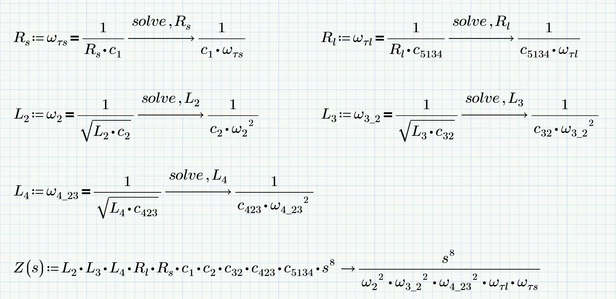

One way to do it is to provide the equations not using the assignment operator (:=) but rather with the fat boolean equal sign and let Prime solve each equation for the variable you would like to be substituted. Of course the results would have to be assigned the appropriate variables.
As the equations are so simple it probably would be less effort to manually solve the equations in your head and simply provide the results as MFra also had done:
Prime 6 worksheet attached

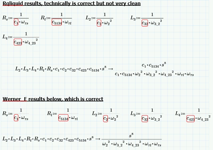

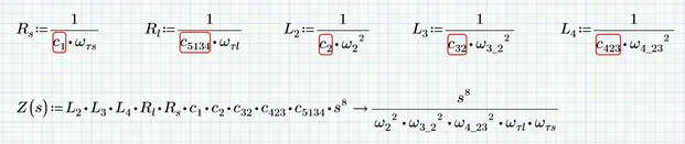

Sorry I have a little of  problem when I did it the way Werner_E recommended. Technical it is correct but can be reduce further. Please see below:
I do not know the difference between the two and yet it gives 2 different results:
