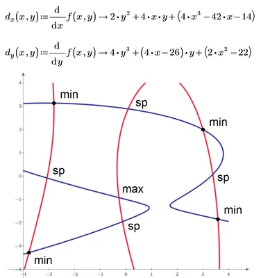

I'm trying to parse a test function https://en.wikipedia.org/wiki/Himmelblau%27s_function using symbolic math. It has one local maximum, four global minimums and four saddle points.

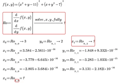

Why does Prime's symbolic math only output the minimums? Mattcad 15 symbolic engine produces the traditional answer - absolutely accurate and absolutely indigestible.

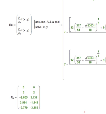

Not, if you add "assume, ALL=real"
BTW, you should show as partial derivative - at least in MC15 we can do that.
"absolutely accurate"
Unfortunately - No. (0; 0) is not a solution!

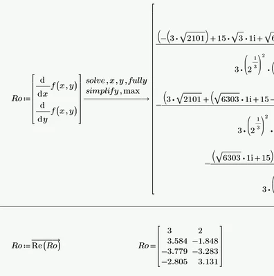

If you want to to SEE the result in Prime, you would have to add "simplify" or "simplify, max" and to get rid of the vanishingly small imaginary part you can use Ro:=Re(Ro). Its not nice to have to do that, but at least its a workaround.

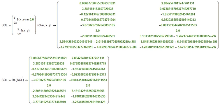

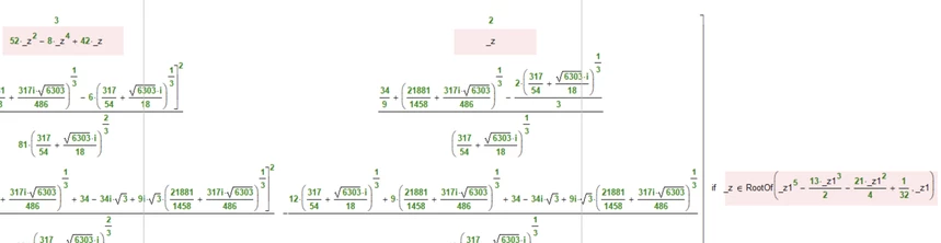

On contrary to Prime, Mathcad 15 tries at least to bring you the missing 5 solutions, too, but it fails to solve the fifth order equation exact symbolically

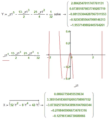

Interestingly you can try to solve this equation symbolically in a separate region and Mathcads symbolic switches to float mode and gives you the five real solutions for the y-ccordinates:
I have no idea why Mathcad wrongly returns (0; 0)  as additional solution if we add the "assume, ALL=real" constraint. 😞
Of course you get all nine solutions in one go if you force the symbolic in float mode. This time also MC15 runs into numerical inaccuracies and returns tiny imaginary parts wihch you have to et rid of.

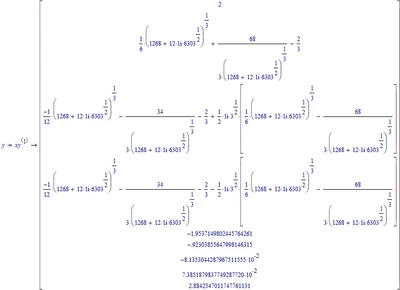

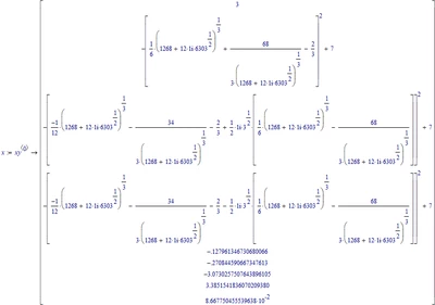

Mathcad 11/Maple:
(It's red because the numeric processor complains, because of the brackets surrounding the symbolic evaluation).

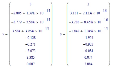

Means we have 9 solution pairs for x,y. The x's are:
The y's are:
And numerical approximation gives:

Interesting! So MC11/Maple switches to float mode partially when it can't solve part of an equation in pure symbolics.
Its irritating that the exact solutions are the ones with a small imaginary part when evaluated numerically.
I guess that a symbolic evaluation with float could avoid that (actually it doesn't in MC15).

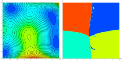

The picture made with MC15 does not at all resemble the Prime pic you posted in your initial post (its not included in the Prime file you posted).

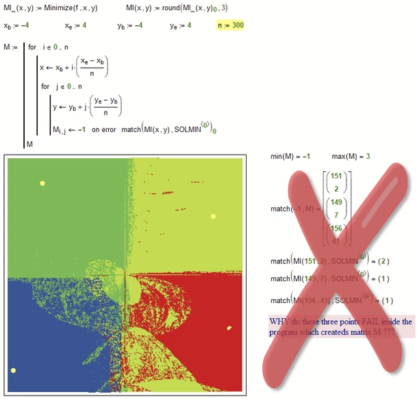

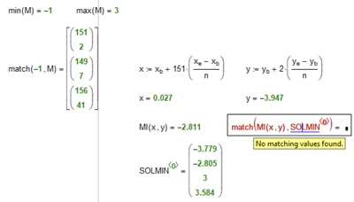

I tried to tidy up your worksheet an experienced a very unusual effect.
When I change the algorithm for "minimize" from "Quasi Newton" to "Conjugate Gradients", minimize fails for three points inside the program, but when I call it outside the program, no error occurs.
Has anybody an explanation for this?
EDIT: Yes, me! 🙂 The matrix indices are not the x- and y-values of the points. So outside of the program I was calling the function with the wrong input values. Thats the simple explanation why no error was thrown - silly me!
BTW, in case anybody is interested: Its not the solve block which fails for these three points but the problem is that the result of the solve block is too inaccurate and does not match to the precalculated value rounded to three decimals:
MC15 sheet attached
