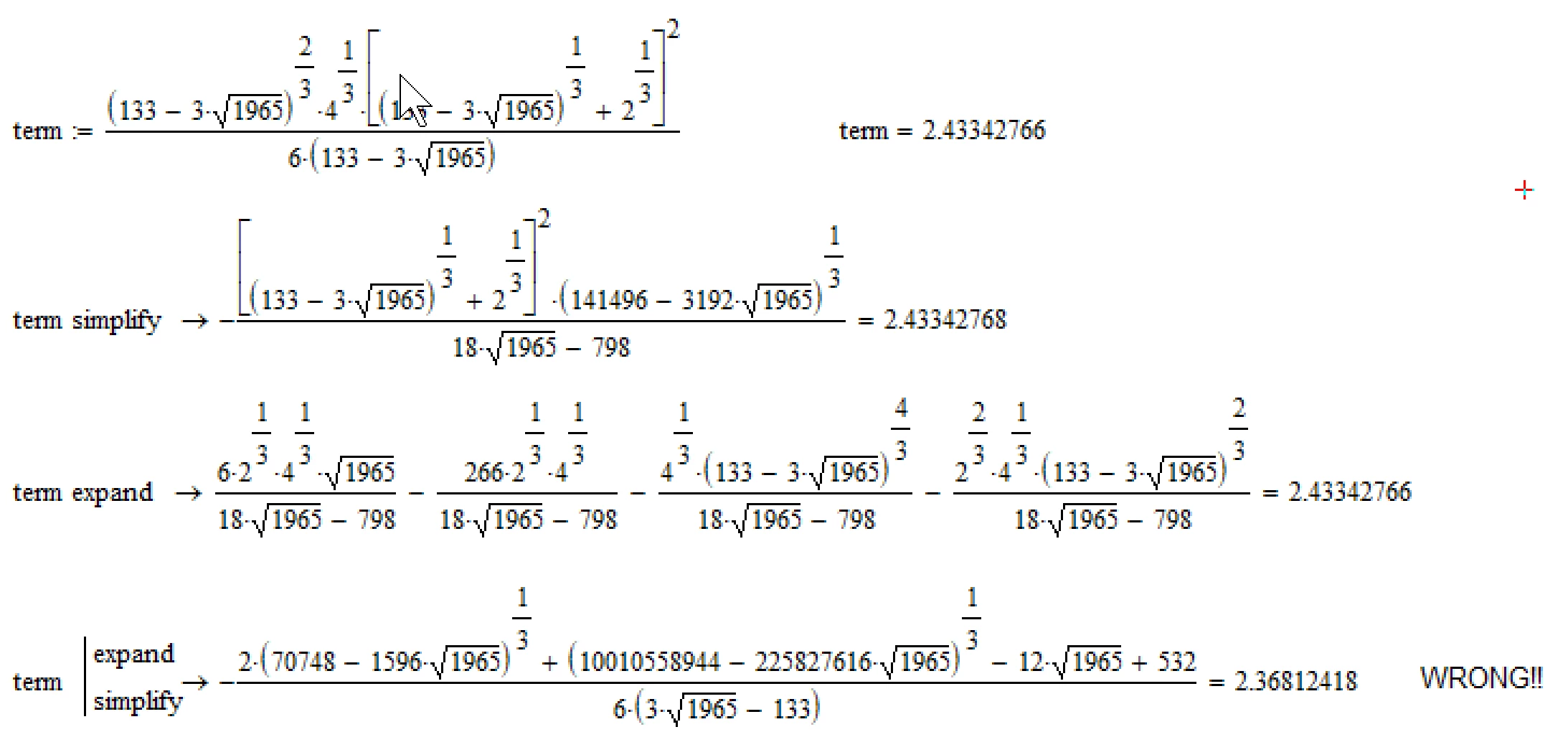

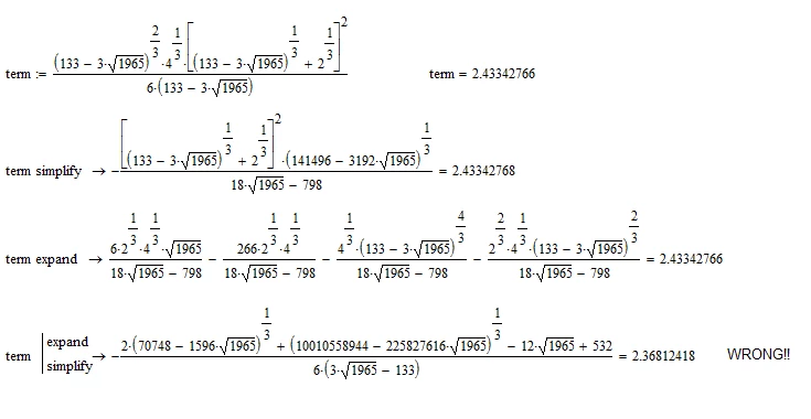

I don't expect PTC to fix this bug in the near or far future but just out of curiosity - does anybody has an explanation or idea whats going wrong internally in the symbolics here (other than "its a bug").
I did not take the time to convert to Prime but I expect the same error there, too.
MC15 worksheet attached.
LucMeekesAnswer
23-Emerald V

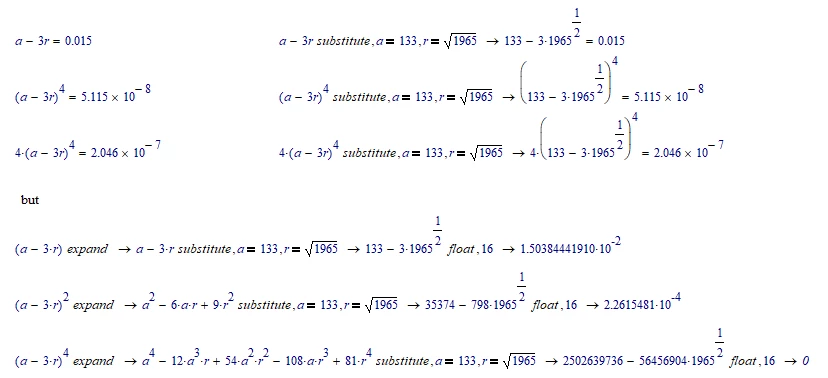

Notice how 133-3sqrt(1965) is close to 0.
Taking that to the fourth power (in the third term of the 'expand' result) gets it even closer to 0.
I renamed 133 to a and sqrt(1965) to r.
a-3r=0.015, (1-3r)^4=5e-8
The second term of the numerator of the 'expand-simplfy' result would be:
And that's a real zero. A non-zero number raised to whatever (real) power should never become 0, or am I going crazy?

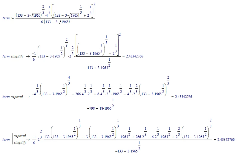

Here's Mathcad 11 / Maple. Of course without error Smiley Tongue Might help to clarify...
In the attached file, I've put the simplified, expanded and the expanded-simplified expressions as new variables. Maybe working with those in M15 brings you further in clarifying.

Thanks for the reply, Luc!
I had no doubt that Maple in MC11 would do it correct.
The simplifications done using the various keywords are completely different as our screenshots show - not surprising.
Its well known that Maple is far superior compared to MuPad, but that error in a simple numeric only expression is quite alarming!

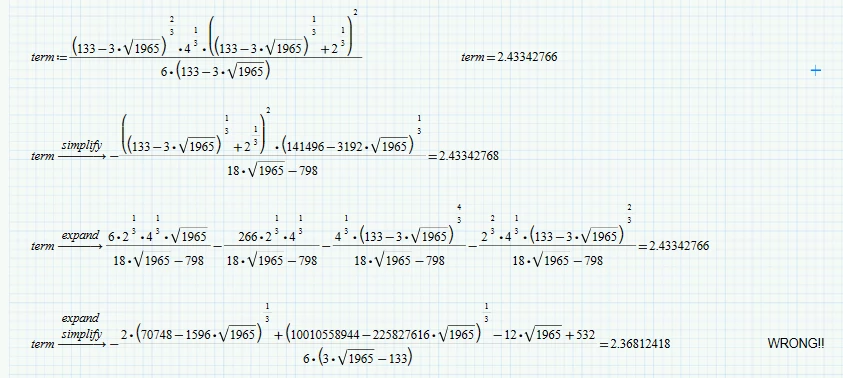

Here is a result in Mathcad 15 M045:
And in Mathcad Prime 3.1:
