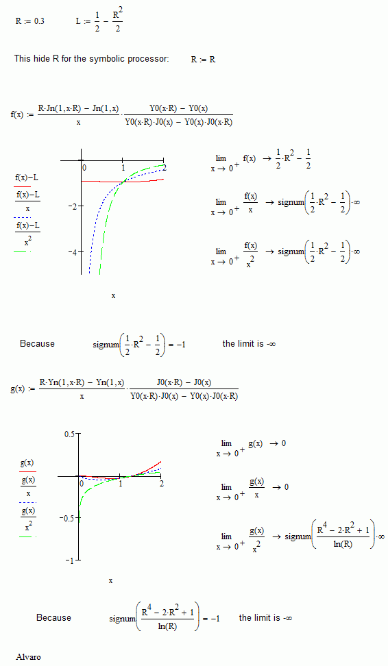

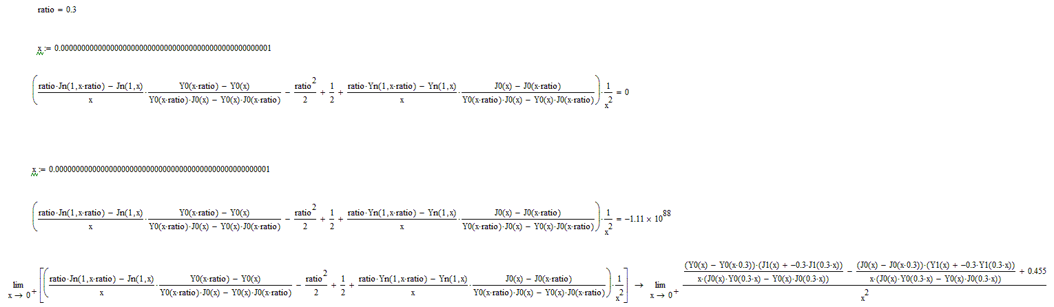

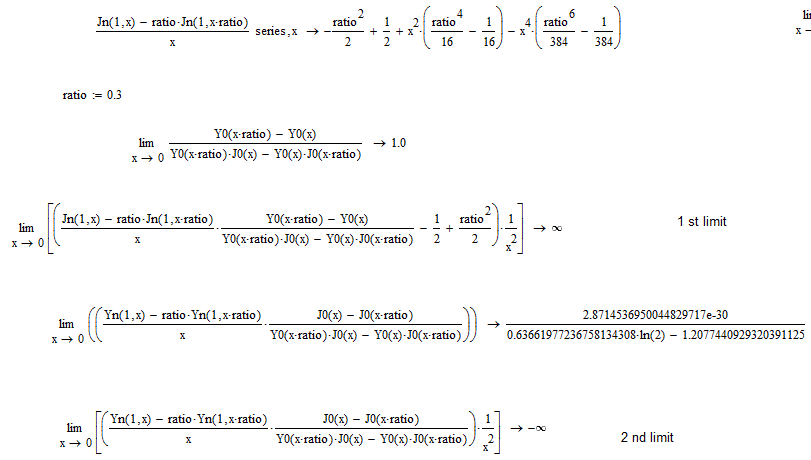

How to calculate Limits with MathCAD symbolically...the series expansion suggest ( at least in one case ) that they should be finite, however the calculus result is infinite...Why? Furthermore it would be possible to calculate the limit without assigning a value to R ( I think not ).

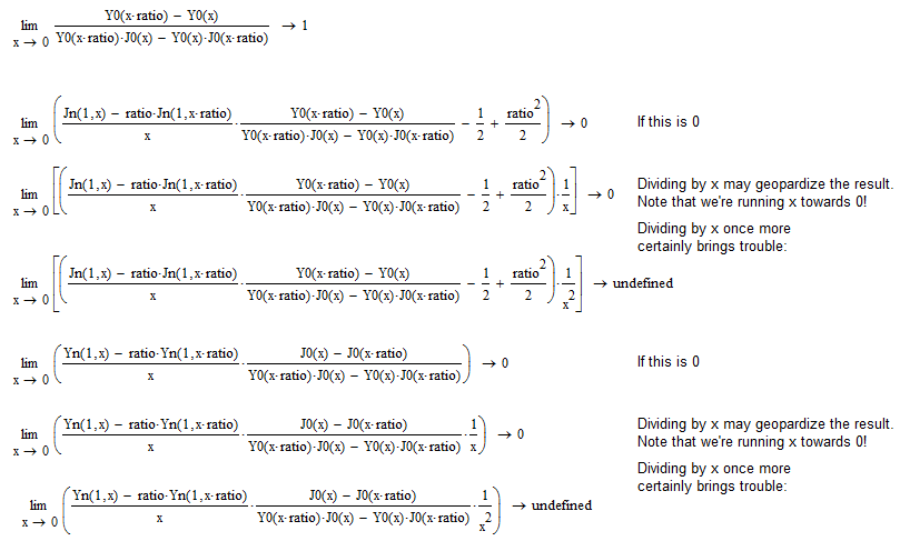

The limit it's a property of the variation of the variable, not for some fix number. So, the best way to "see" it is plotting the variation, or make a table of successive values. If you can prove that the function have not reasons for vary it's behavior, like discontinuities or zeros or discontinuities of the derivative, and have some bound for the variations, can acotate the limit. The theorem about this is that any monotone bound function have a limit, and any monotone unbounded function diverges. The particular value for the limit it's another question, it's more important say that it exist.
The attached is the study for your limits, in mathcad 11, because mupad isn't very good taking limits. Actually the old version of maple within mc11 is bad too, but enough for this case.

Limits are poorly implemented in mupad. Even that, in your first limit what I see as first impression is ((1/2-ratio^2/2)*1-1/2+ratio^2/2)/x^2 which gives the indetermination 0/0, but seems that the denom x^2 decrease speedily than the zero at the numerator, and the limit is infinity. Same thing about the second limit, but in this case the numerator is negative, so the limits grows to minus infinity. This is: as first impression, limits are ok.
But, applying L'Höpital, for generical ratio, you have:

This is what Mathcad 11 (Maple symbolic engine) says:
Further following your steps:

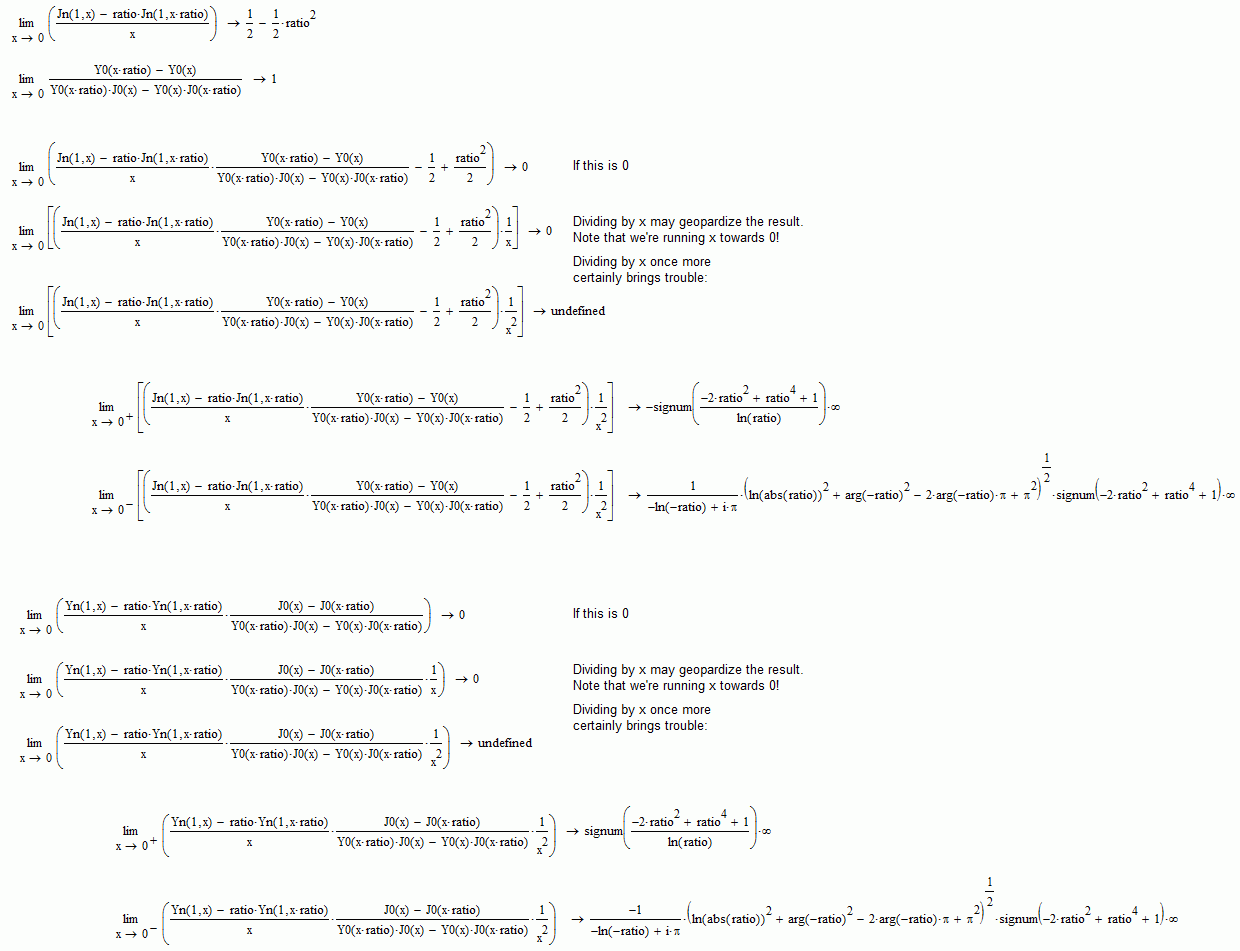

Maple take the limits as "undefined" because, by convention, unsigned infinity is undefined in maple. Notice that very simple successions, like n*(-1)^n grows to unsigned infinity, or to both infinity at the same time. This is equivalent to those successions that have limit zero by the two sides, precisely like 1/(n*(-1)^n), the inverse of the previous one. So, this convention isn't very strong, and broke some symmetry about inverses.
But if you take lateral limits, maple now try to found the sign of the infinity, but without much lucky. Eventually, with assume keyword, can make some further simplifications.
BTW both limits by the two sides gives now the infinity answer, but with the sign for determine for some conditions. That's is what is showed in the attached, even the expressions could be horrible: if the limit is plus/minus infinity for both sides, must to be infinity, even the sign could be a more delicate question, and the 'undefinition' of the limit is solved, for instance, for an unsigned infinity, or one with some variable sign, with dependence of the ratio's values. And that's what Massimiliano obtain with Mathcad 15.

Thank you for your clarifications. Now however  I am considering the sum of the two previous limits and looks what I found. Is this correct?
