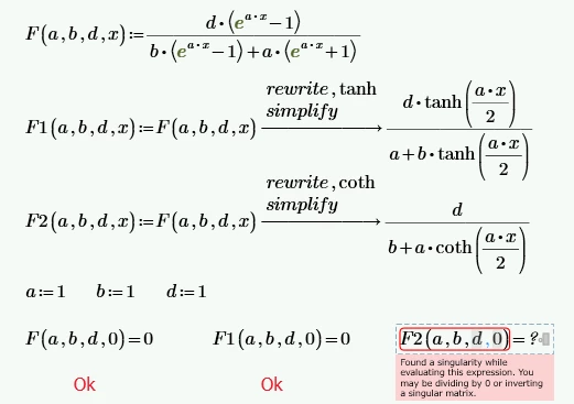

Symbolic command 'rewrite' changes the domain of a function?
I want to replace function (F) with a more compact expression (F2). However, an error occurs.

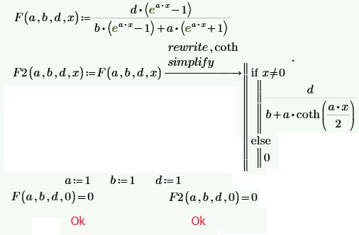

Thank you, Luke. I know it. I want this to know Mathcad Prime (see picture). Maybe it works in Valery's Mathcad Prime Minister?Smiley Happy
