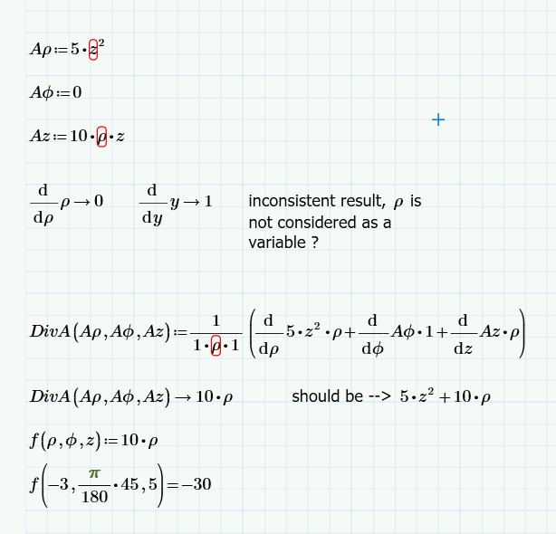

I am trying to write a sheet for grad, div, and curl.
I am finding that one symbol (rho) is considered as a constant instead of a variable.
what should I do to rectify this?

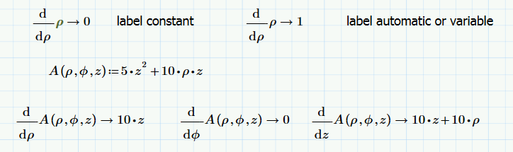

Prime has an annoying habit of labeling your variables and constants.  You (apparently) have rho as a constant:

Yes...I think prime has this weird behaviour. I changed rho with other symbol and changed it back to rho...and it showed a correct result.
The thing is I dont always have the opportunity to debug this kind of error..although I have sort of an expected result beforehand.
Do you have any tips for me?

As Luc says, the way Prime labels is a mystery to us all.  Prime does format the variable differently from label type to label type, although there are very minute differences.
The original Mathcad didn't really use labels a lot.  So if you defined a variable m := 24 gm (call the mass the letter m, and assign it the value of 24 grams), Then a little further on defined length := 6 m (define the length to be six meters), what you really told Mathcad was "define the variable "length" and assign it the value of 144 grams." (6 x 24 = 144)
So when they redid Prime, they used labels; you can have m (as a variable or constant) equal to 24 grams, AND m (labeled as a unit) to represent one meter.
The result:  They solved one issue and created another.
