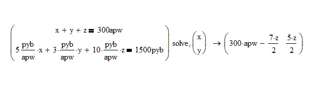

Just solve for x and y with Mathcad Val:

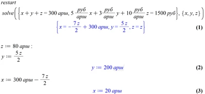

I'm not sure that Maple's z = z is a very useful solution!

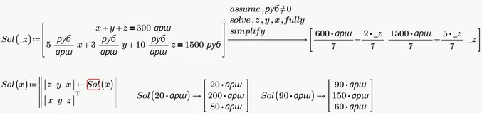

@ValeryOchkov wrote:
Why is the Symbolic engine of Mathcad 15 and Prime so lazy,
lazy??

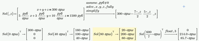

Is the engine lazy because it does not voluntarily provide all the solutions, or is the user lazy because he only asks for one solution and does not explicitly demand that he want to receive all the solutions? 😄

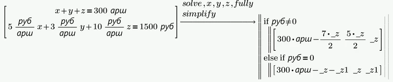

BTW, the legacy engine (MuPad) in P6 is a bit more precise and also considers the case  руб=0

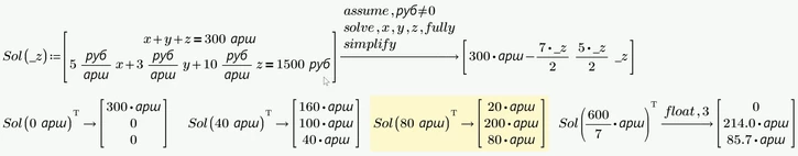

So to achieve the same function as shown above, the user must explicitly state that руб is not zero using "assume"
BTW, you can control which variable the engine uses as parameter by changing the order of the variables after "solve". The name(s) of the parameter always will be _z, _z1, ... ,though.
why should I work for its?
I'm afraid that the question of why you should use Prime and its symbolic engine can only be answered by yourself. I believe no one is forcing you to do this 😉

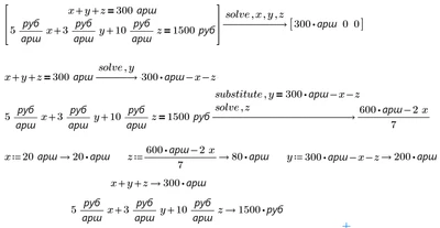

Alan

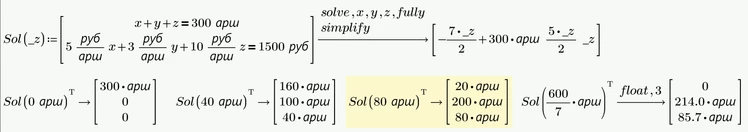

I just posted an answer  about 20 minutes ago but for reasons unknown to me it had disappeared.
EDIT: Looks like now, after a long time, that first posting of mine is finally showing up. Not sure what was going on.
In short you have to tell Prime that you want to see ALL solutions (don't be lazy 😉 ) by using the modifier "fully".
The "assume" statement is only necessary when using the legacy engine (MuPad) because only this engine correctly considers the case py6=0.
If you want Prime to not use z but another variable as parameter, you simply have to change the order of the variables after "solve". The parameter will still be named _z, though.

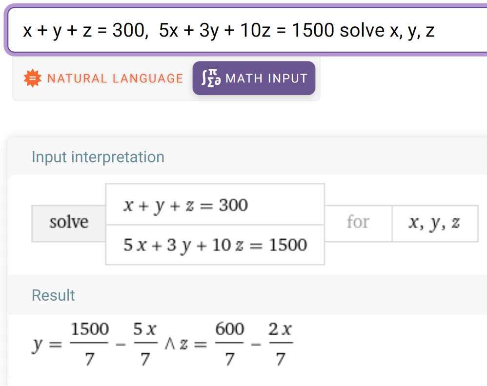

No sure what you want to show with the WA screenshot!???
WolframAlpha uses the first variable stated as parameter (if possible), Prime uses the last one.
Wolfram delivers all solution without asking, Prime delivers just one solution unless asked to provide them all.
BTW you can make the solution dependent on x in Prime, too, if thats what you want. Simply change the order of the variables after "solve".
23-Emerald V
You have (only) two equaltions, and want to solve three parameters, then one of those three is free to choose.
Maple indicates that by setting its value to itself:
Note how the solution for z is z...
The order in the 'solve' directive doesn't matter:
You should specify which is your free parameter by not solving for that parameter, Example, choose x:
