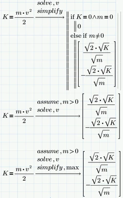

Apart from that, and to your actual question:
What if you add 'simplify' to the symbolic evaluation?
And additionally: You are using Prime 6, where you have the option to choose between two symbolic solvers: The 'new' one , which is the default, or the former one (MuPad). Do they both give the same answer?

You are not doing anything wrong.
Controlling the the way an output from the symbolic is displayed is hard to impossible. In Mathcad/Prime we don't have many options to do so. You may use additionally "simplify", "simplify,max", "factor", "expand", "collect,..." or the like (sometimes with unexpected results) but in general you'll have to accept the output as is.
You should also consider that in math a fraction is considered "simplified" when the denominator is rational. So in math often roots are not desired in the denominator. Eliminating them often makes the term a bit less compact as in your case and the new symbolic seems to automatically default to this kind of simplification.
I see no way to convince the new symbolic engine in Prime 6 to display the result the way you'd like it to see.
The symbolic not even considers that m may be zero an so its result would not be correct.
In Prime 6 you have the option to switch back to the prior, legacy symbolic engine (muPad, not available any more in version 7 of Prime). This engine is aware of the possible m=0 problem and displays the result similar to the one you'd like to see and, on the other hand,  it seems not to be able to talk it into displaying it with a rational denominator 😉

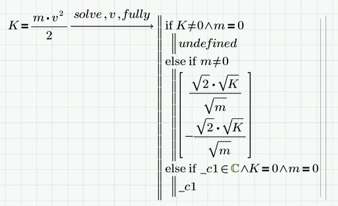

March 13, 2021
Addendum:
The new symbolic IS also aware of the m=0 problem, but only if used with the modifier "fully"
The legacy engine still is a bit more detailled
