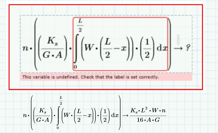

Hello All,
The following symbolic evaluation used to calculate without any issues in mathcad 15. It does not evaluate in Mathcad Prime 11.0.1.0. i have attached the sheet,
Sam

@SFares How long have you been using your current installation? I don’t know of any setting that could cause this behavior. Two things that you might try.
  1. With the problem worksheet active, open a 2nd instance of Prime and try a copy/paste of the expression into the 2nd Prime instance.
  2. Re-install Prime 11.0.1.0 and then retry the worksheet (including a recalculation).

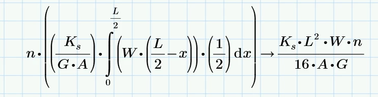

You should attach your worksheet which demonstrates problem. Seens to work in isolation,
Prime 11:
Prime 12:

Thank you  rgunwaldsen
I thought I had attached the file before, but it appears it does not accept Mathcad sheets, and I had to zip the file. I have attached the zipped file.

Hi Sam. It seems to work if I recalculate your worksheet.
Roger
