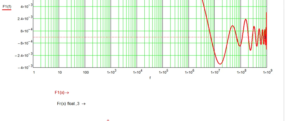

Make sure you undefine x numerically, before doing the symbolic. With x some range, the symbolic is trying to get a symbolic solution for each of the values of x, that takes time if x is a large range, and the symbolic result is going to be huge...
So put an
x := x
To the right and above your symbolic evaluation F1(x) ->
But, looking closer to your sheet, you have numeric data. What do you expect the symbolic evaluation to show?
Or is it just this:
So put an
x := x
Or is it just this:

Thanks.  I didn’t realize I needed to include the coeffs in F1 since I had defined it above.
Again, thanks much.  I will do that.
I may have another question tomorrow on how to combine it with a fourier integral symbolically.

Is this not working because I am using Mathcad 15?
