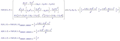

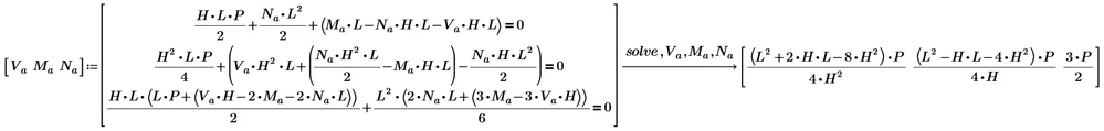

Prime does not support symbolic solutions of solve-blocks, as far as I'm aware. (It's one of those things where Mathcad 15 and before are far better).
But you can solve the system symbolically by setting them in a (3-element) vector and solve that symbolically.
Here's a Mathcad 11 implementation.
You should be able to do the same in Prime.
