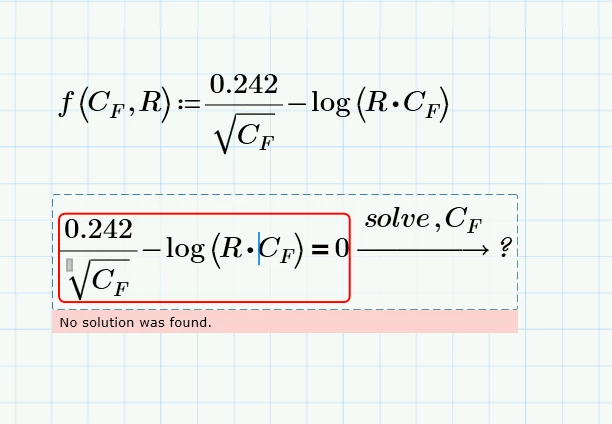

Hello all,
I have question about the symbolic evaluation in Prime 6.0.
I thought it was simple to solve it by using the symbolic function, but it does not work well as I expected.
Am I wrong? Not sure how to solve this problem attached. Please you specialist how to solve this complicated equation about a variable. You can see the problem I am struggling.
Please let me know whether it is solvable or not, and how to solve this kind of problem.

    You tried the symbolic "solve" command which uses a third party engine integrated in Prime. As Luc already wrote there are even two engines integrated in Prime 6, because PTC is on the way to replace the Engine which was integrated in Mathcad 14 and 15 and also in Prime (this was MuPad, an older and stripped down version of the engine you also find in Matlab) for a new (cheaper) one. Unfortunately both are not capable enough to solve your equation and give you the solution using the Lambert-W function (which at the end also could only evaluated numerically).

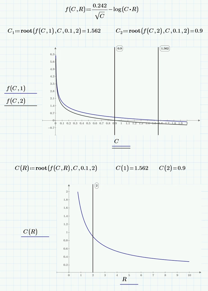

    The native numeric methods provided by Prime are the "root" command in its two flavours and the solve block with find. They will give you a numeric solution which also means that you will have to provide a value for R. Valery had shown how to set up a function which returns the C-value for every value of R.

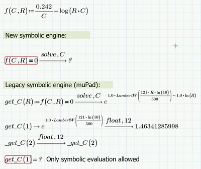

    A small change in your equation (omitting the square root and using just C alone) makes the equation solvable for the older engine Mupad which still is available in Prime 6, but the new engine can't solve this equation, too:

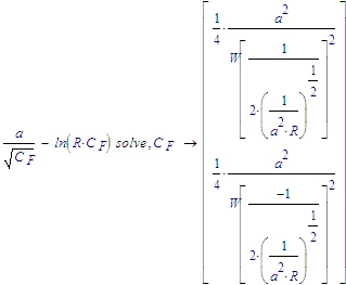

    Simple for Mathcad (11):
    Note that:
    - In your problem a = 0.242, I did not use that number to prevent a floating point result with a ridiculous number of digits.

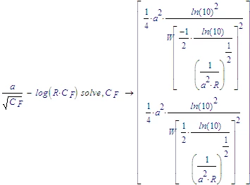

    - the function 'log' is the logarithm with base 10, if you intended the natural logarithm (base e), use 'ln' instead. The result then becomes:
    - You get two possible solutions, possibly due to the fact that R and a could be complex numbers.
    - the solution uses the function W(z), which is the Lambert W function which is the solution to a specific equation:
    Also note that Prime6 gives you access to two different symbolic engines:
    - The standard symbolic engine
    - The alternative symbolic engine (MuPad), which was the standard (and only) symbolic engine used from Mathcad 14 to Prime 5.
    Chances are that 'the alternative symbolic engine' of Prime 6 will find the solution with the Lambert W function.
