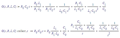

    Sep 2, 2020 7:15 AM UTC
     You may want to try the symbolic keyword collect, if that still exists in Prime 6. Example:

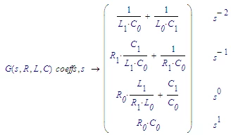

    And to get the coefficients of all powers of s in vector form, try coeffs.
    Sep 2, 2020 8:13 AM UTC
    Unfortunately using the original "G" from the provided sheet, both "collect" and "coeffs" return expressions too large to display.
    At least with "coeffs" a workaround could be to assign the result to a variable and evaluate the elements of the vector singly:

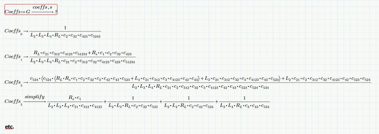

    rdliquid1-VisitorAuthor
    Sep 2, 2020 6:35 PM UTC
    Hi Luc,
    Thanks for the helps. Looks like your version of Mathcad did it. It is able to factor out the terms. As Werner mentioned, using Collect and Coeffs in Mathcad 6.0 results in the expressions that are too high entropy and it is hard to understand what it means. Please see attached
    What Mathcad version are you using Luc?
    I am checking with Mathcad support on this and hope they have a solution.
    The attachment is just a simple expression right now. My actual equation is much more complicate and it would be a nightmare if I have to do it manually
    Thanks for all the helps
