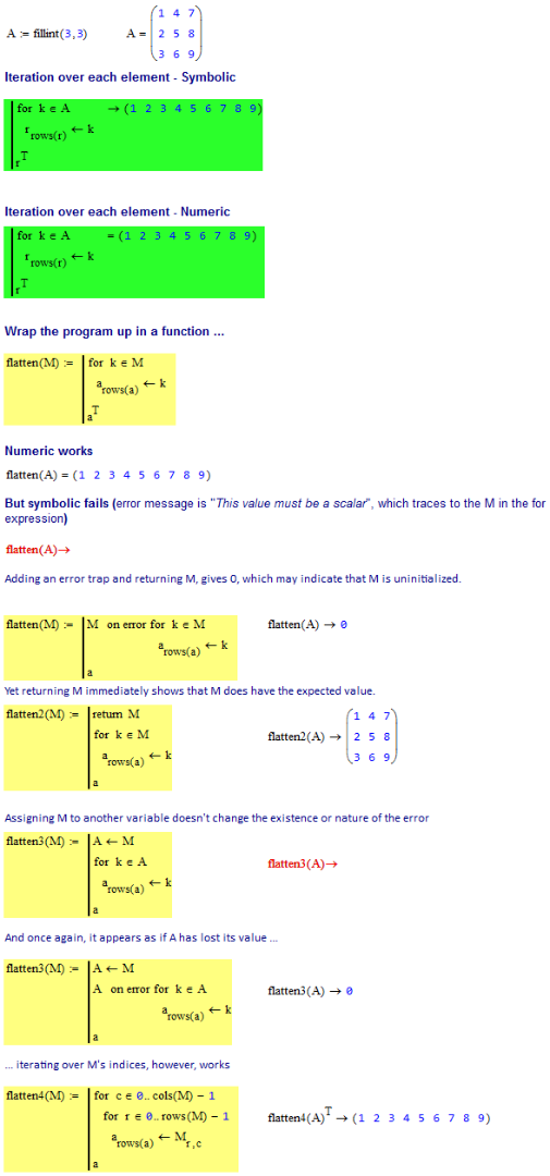

symbolic for (each) loop error
Using the for programming expression in "for each" mode is a useful mode when iterating over an array and the index of an element is not a concern.  The mode works under the numeric processor when used in a free-standing program and inside a function.
However, when using the symbolic processor, the mode only works in a free-standing program and not in a function (where it is much more useful).
This is a long standing error in Mathcad.  Has it been fixed in Prime?  Can it be fixed in the next Mathcad 15 update?

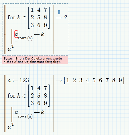

It doesn't even work if the matrix is freshly defined inside the program
And, no - the bug wasn't fixed in Prime, at least not in Prime 3.0
Obviously a for-loop is interpreted/implemented differently in the symbolics and insist on a sequence like first value, (optional second. value) and end value.

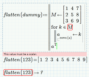

September 21, 2016
Now I am further puzzled:
Mathcad 15 M030:
Prime 3.0
Prime was set to "English" using "/culture:en-US" but the error message still is in German. Something like "Object reference not set to an object instance".

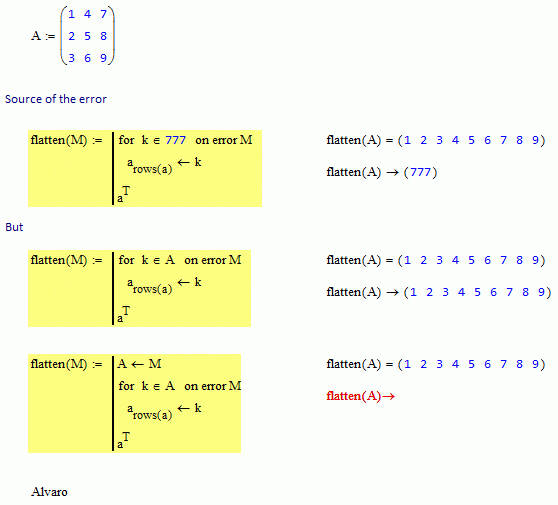

Hi Stuart.
Following example let's me think that the bug it is related with the procedence of the argument as a global variable.
Best regards.
Alvaro.
