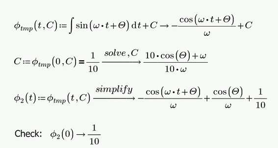

You have:
(I've added an integration constant c)
and want:
This means that c will be a function of omega and theta, as follows:
With that you can (re-) define:

initial? This would mean that you also have to provide an initial value for t. I suppose you mean t=0, that is phi(0)=0.1.
So you actually have a (simple) ODE. Current version of Prime can solve ODEs symbolically:
Otherwise you could do it step by step:
.) Add an arbitratry constant C of integration
.) Apply the initial condition and solve for C
.) Redefine the function using the correct expression for C
or a little bit shorter, avoiding the explicit definition of C
which can be combined in one small program
P10 worksheet attached
