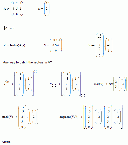

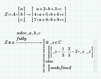

Hi.
¿There are a way to catch the values for this kind of lsolve?
Thanks in advance.
Alvaro.

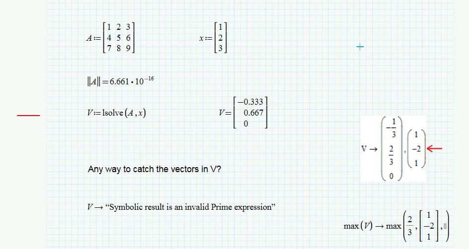

It doesn't converge to a solution for me either.
I don't see any easy way to split the two symbolic solutions out. The only approach I can think of is to use the automation interface to read the XML of the region and then create the vectors in two other regions.

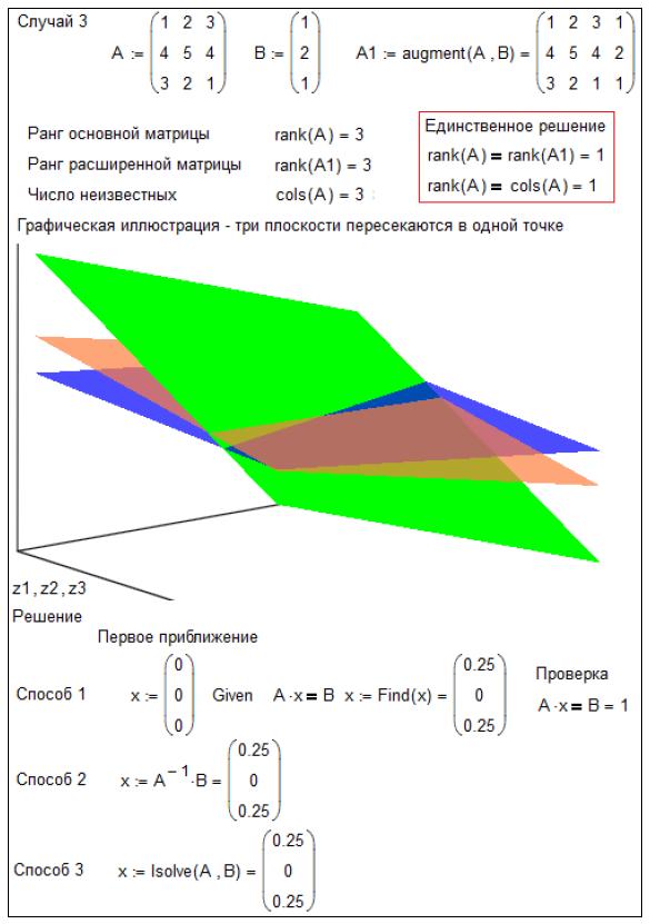

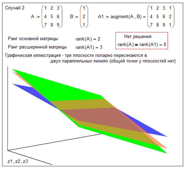

I don't see that book, it's excelent. Thanks Valery.
Alvaro.
Alvaro.
You can download the book and translate it into English or Spain
http://twt.mpei.ac.ru/ochkov/T-2016/PhysMathStudies.pdf
I see no easy way to get hold on the two vectors of the symbolic result, but I get the very same result as shown in the picture by Alvaro when I load his sheet in Mathcad M030.
Not sure which releases are used by Alvaro, Fred and Richard.
In Prime 3.0 I experience the same as Fred has shown.

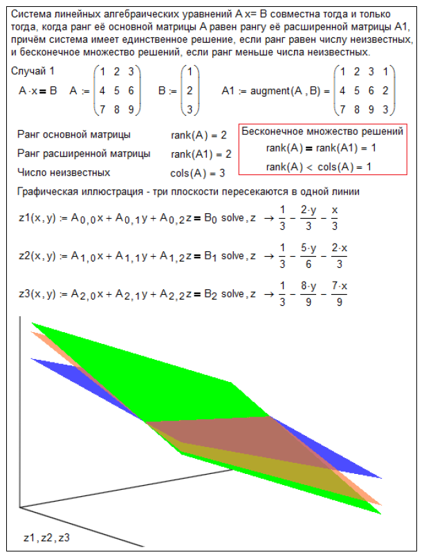

There are only 2 independent equations , so Isolve is just catching a solution in the numeric processor, but the symbolic processor is properly calculating the determinant as 0 & failing to find a single solution
the symbolic engine can be persuaded to find this solution , but it's not easy.
(attachment is in Prime 2)
Why the other methods don't work I don't know...

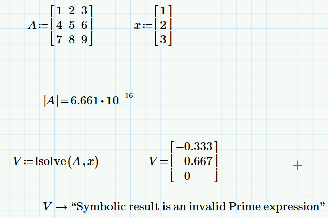

Alvaro,
"Symbolic result is an invalid Prime expression". Well, what can we say? Express yourself !

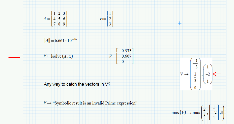

And here is result in Mathcad Prime 3.1 version:
