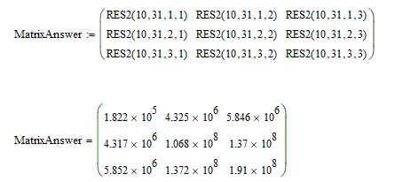

You cannot index a function at its definition.  Mathcad is looking for the name of a variable to index.
The second function definition does work as it does a number of summations that return a single value as a result of the function.
You can define a matrix that uses this function.  Is this what you are after?
Warning.  by default Mathcad indexes matrices from 0,0 unless you redefine ORIGIN worksheet variable.

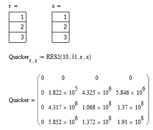

The answer would not be complete now we know the intent.
You can define the matrix with a quicker notation using the values of r and s you defined.
In this case a name is used in the definition so you can use indexes
Remember by default matrices start at index zero.
