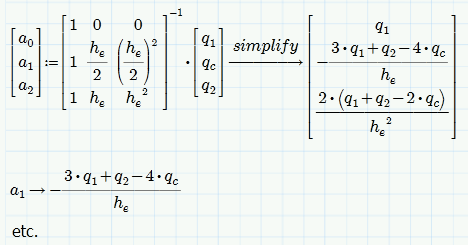

If you are after something like the following, simply leave q1,2,c undefined:

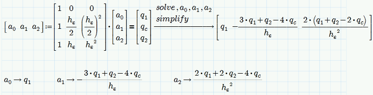

You could also use the symbolic "solve" to do the job:

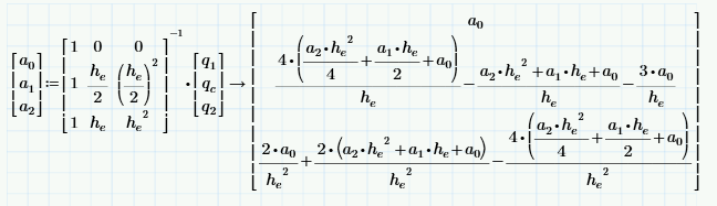

Werner, thanks for responding. but, I am getting the same answer as you.
This is what I am getting
rayakannu1-VisitorAuthor
sorry, not getting the same answer as you
-MFra-
I'd prefer to proceed as follows:
