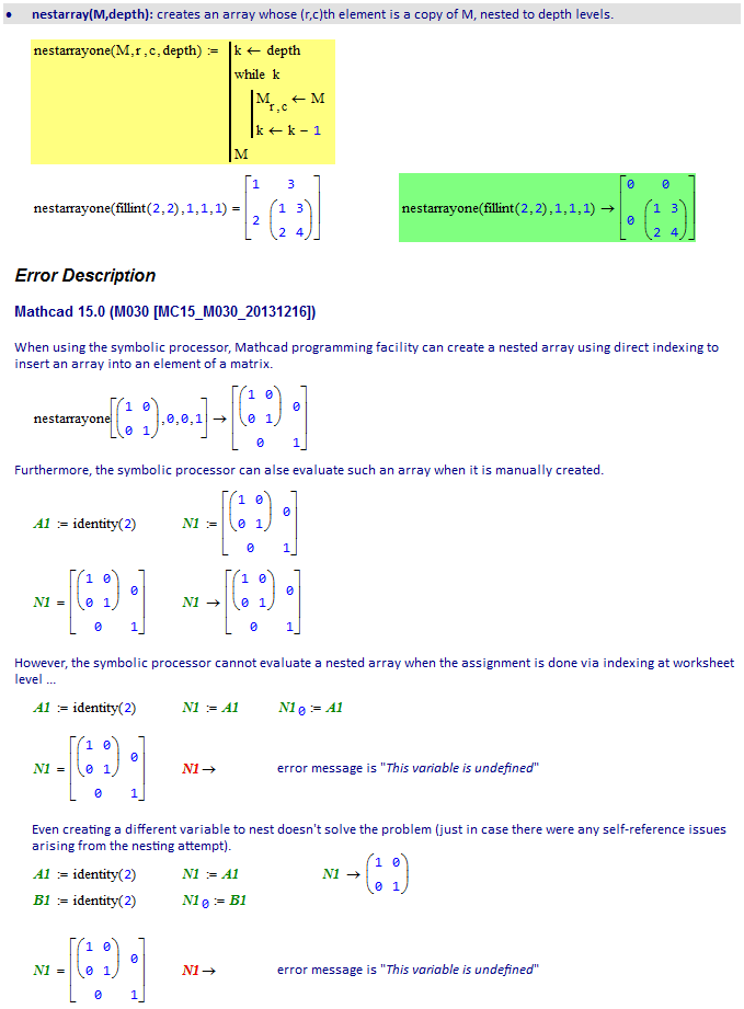

When trying to create some test matrices in Mathcad 15 for the functions in the attached worksheet, I found that I couldn't create a nested array at worksheet level by setting one element of a matrix to be a matrix.
It's fine if I do it inside a program or if I manually create such an array.
Is this a known issue?  Does it still exist in the latest version of Mathcad 15?

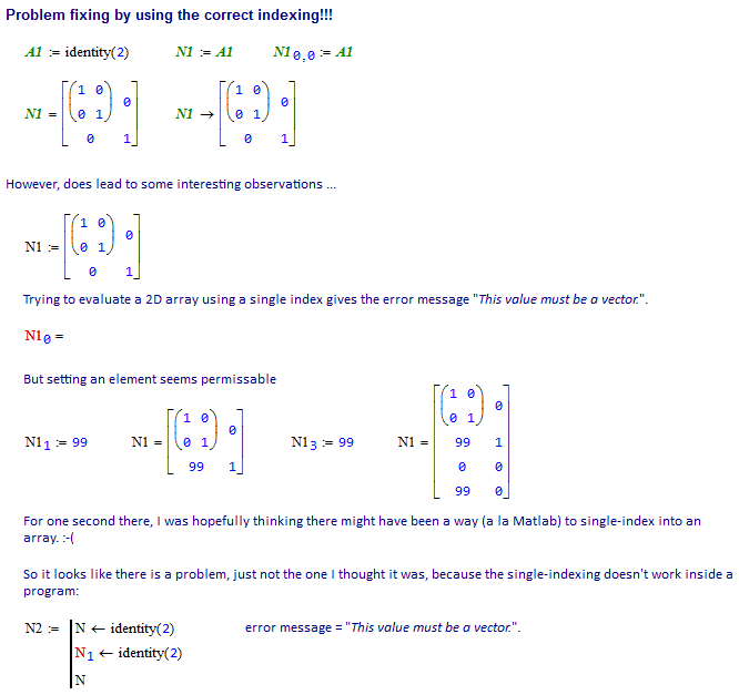

Hi Stuart,
first issue seems to be fixed by creating a local variable for the input array in the program.
second is probably the indexing of the array: changed from N1[0 to N1[0,0 .
Hope this help
Andy

September 20, 2016
Hi Stuart.
If single indexing is not fully implemented, like in matlab, any numerical answer with it different of an error message must to be interpreted as bug.
Best regards.
Alvaro.
